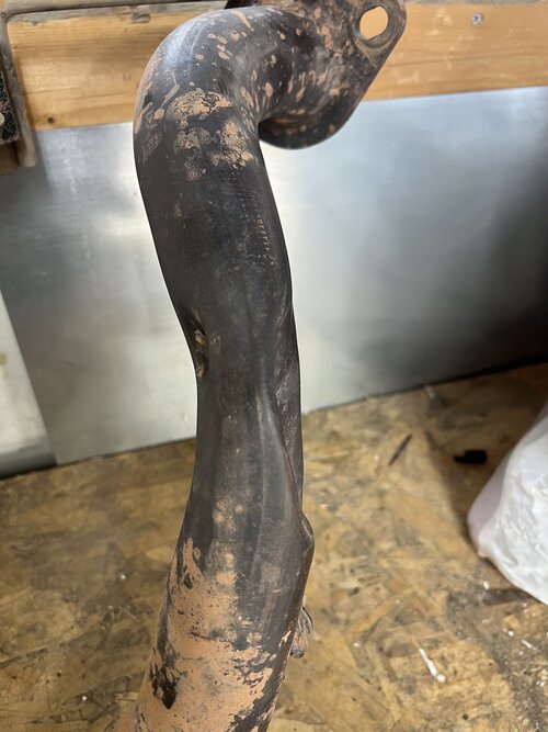

I just swapped out the exhaust earlier this year (old cats were bad and exhaust was all rusted) and then last weekend pinched it at the mini-moab rocks. The pinch is right where the exhaust goes under the frame. Has anyone found a good option for fixing this? It needs to pass emissions, so I prefer to keep the cats. That makes it a bit difficult to go over the frame. And I can't find any skid plates that cover this section of the exhaust, plus it would stick down quite a bit.
I'm leaning towards just repairing it and leaving it in that compromised position.
The only other solution I've seen is to re-route it inside the frame from the headers, but not sure that works with cats.
Pictures of the dented piece and the offending obstacle for reference.

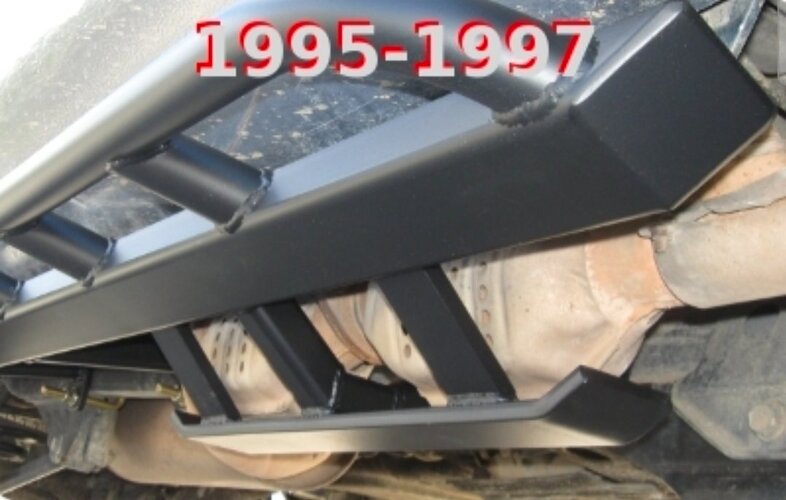

Is this the section immediately after or behind the cats or further back? If its the section behind the cats there is an expensive solution, whiteknuckleoffroad makes sliders with the CAT protector around it which may help.

Yes, the section right behind the cats. It looks like the white knuckle sliders only cover the cats, so it wouldn't help with the exhaust pipe. My cats are already partially protected by the mounting arm for my Slee sliders (unless I hit a pointy rock right on a cat).

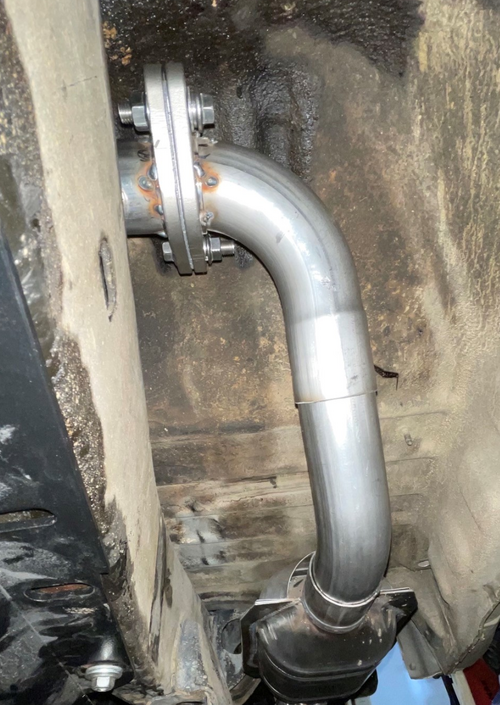

I’ve still got the EMS system on my truck granted it’s been kind of patched up over the years between rust, a cat replacement, and turbo. You can get up and over the frame rail even with cats. But you’ll need to find an exhaust artist to do it. The local bugger welder at Midas won’t. The OEM diesel exhaust went up and over. Maybe ordering that section if available then handing it to a race shop is the answer?
10,814
AA performance can make the over the frame work. Even with 3” tubing. Have it on both mine. It is very tight with the two cats - I like Matt’s idea
I installed White Knuckle sliders on my 93 in February. I picked them up while in CA with LongCruiser and drove them home to my other 80. Great people, great product, Cruise Moab sponsors.
My prior Slee Sliders did not have this cat protection. In 25 years wheeling never hit the cats. Now I hit the White Knuckle cat protection regularly - its about 2 inches lower. They are SOLID so the hit is hard. I just have to live with and learn this new low spot, and its not a huge big deal, but I'd rather have the clearance.

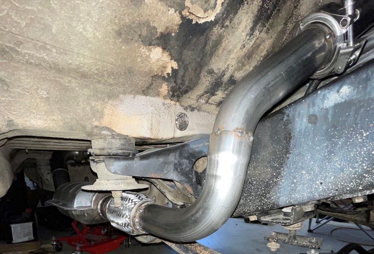

If I'm reading it right, Matt's idea is basically how I built my exhaust on the passenger side when I did my 2uz swap: v-band just downstream from the manifold and a standard flange where it goes over the frame.
You'll note that I also positioned the cat horizontally for more clearance. The bottom of the cat is just above the bottom of the frame rail.
8,711
v-bands are AMAZING! I used several on the LongCruiser. I have had top R&R the exhaust a few times and they make it so easy. The only connection that has given me leaks is the standard two-bolt flange to header.

Yes it’s been a while. There is a heat shield used on 93-94 cruisers that bolts right into place that helps. I’ve never had a problem with interior temps there. The passenger floorboard gets hot though.
I had Al’s exhaust shop in Cheyenne do my most recent one. They did over the frame and did a good job.
