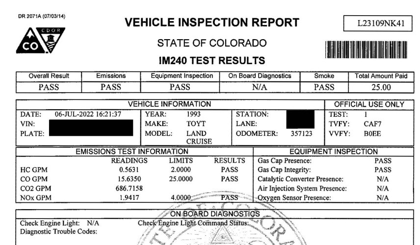

I will have to test this year. I have 10 prior emissions reports.
Limits back in 2001: HC was 4.0, CO was 25.0 and NOx was 9.0. My very first test with a 116,310 mile 1993 80 the HC was 0.4, CO was 9.3, and NOx was 8.82.
NOx History:
In 2012, right after my rebuild, I blew a 9.35 and a 9.25. I forget what we fixed, but then got down to a 3.02. Then I tend to be high 2's to mid 3's.
In 2020 I blew a 2.2. Only once in 20 years under 2.5, but oddly that was two years ago.
HC has always been comfortably around .5 +/-. One .9, once .18
CO was 14.66 in 2020. Ranged from 3.9 to 20. Three times it has been over 15.

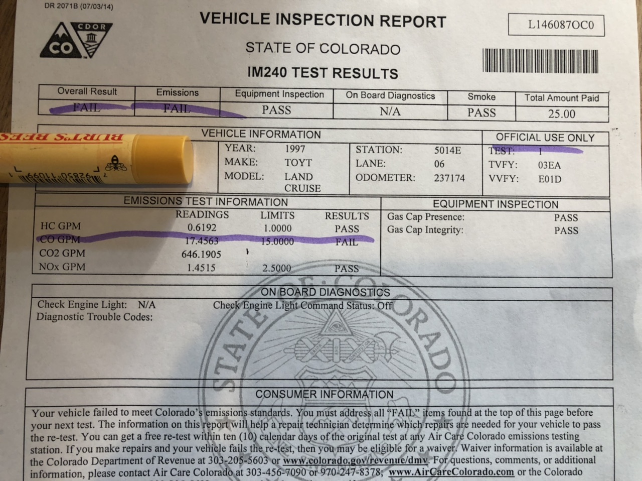

Well, my new to me 80 has failed CO. I’ve done Spark plugs, plug wires, cap and an oil/filter change. I had half a tank of fresh 91 and idled it at 1500-2000 rpm for the test.
My question is.. Will heet fix my issue or O2 sensors? Awhile back @nuclearlemon changed O2 sensors with high CO and that worked. Should I add heet and go test or just swap out the O2 sensors or both?
Add two bottles of ketchup heat and double check your timing too. If that doesn't work then swap your O2s. Also you have a 97, ask them to just do a OBDII check if you didn't already?

You can just splash a half gallon or so of E85 in the tank, basically the same thing as Heet and way cheaper :)
Have you set the timing? Also I had great luck with Cataclean getting some old abused cats back working better.

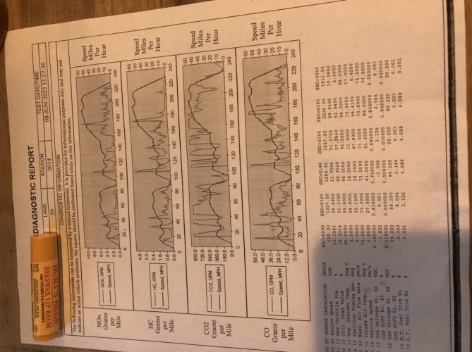

Well, I failed the second test worse than the last. I asked for the obdII test and was told I was locked in to doing the rollers since I failed previously.
This time I had half a tank of 91 with two bottles of the ketchup heet and set timing at 3 degrees. Prior to adjusting, it was a little over 3 degrees.The environmental conditions were the same except I rolled right in to the test from off of the highway. Additionally, i took it to the testing center in Golden instead of Aurora. As you can see it tested quite a bit higher for Carbon Monoxide. It also smells like it’s running rich and burned through half a tank like it was nothing.
I’ve since ordered Oxygen sensors and some MAF cleaner in hopes those items are contributing to my high CO levels.

The fact that you’re failing CO miserably and passing HC makes me think you have moderate rich condition. It could be O2 sensors, but I’d also check that your TPS is adjusted properly, your air filter is clean, and your MAF is in ship shape. A faulty ECU coolant temp sensor would cause this too, and may go undiagnosed due to it being out of range, but not open.

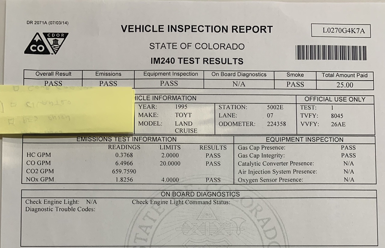

Oooh, you get a 25 limit on your CO while the newer 80's only get 15. That makes it much harder to pass.
I know nothing about Colorado when it comes to specifications, so kind of dumb question. But is there a year that says what is allowed on inspection standards?
60wag
2,669
There used to be a page on the Air Care Colorado sight that listed the limits by year. The info does not to be there any more.

I think we still have the IM240 test in CO. It breaks down by year so it shouldn't change even as the vehicle ages. 1996 is the start of tighter limits, sometimes 1995 depending on the exact make and model. Good reason to get a 93/94 vs. 96/97.

@Inukshuk I replaced both 02 sensors and passed. I had half a tank of gas that was 87/91 mix.
Here are my results.

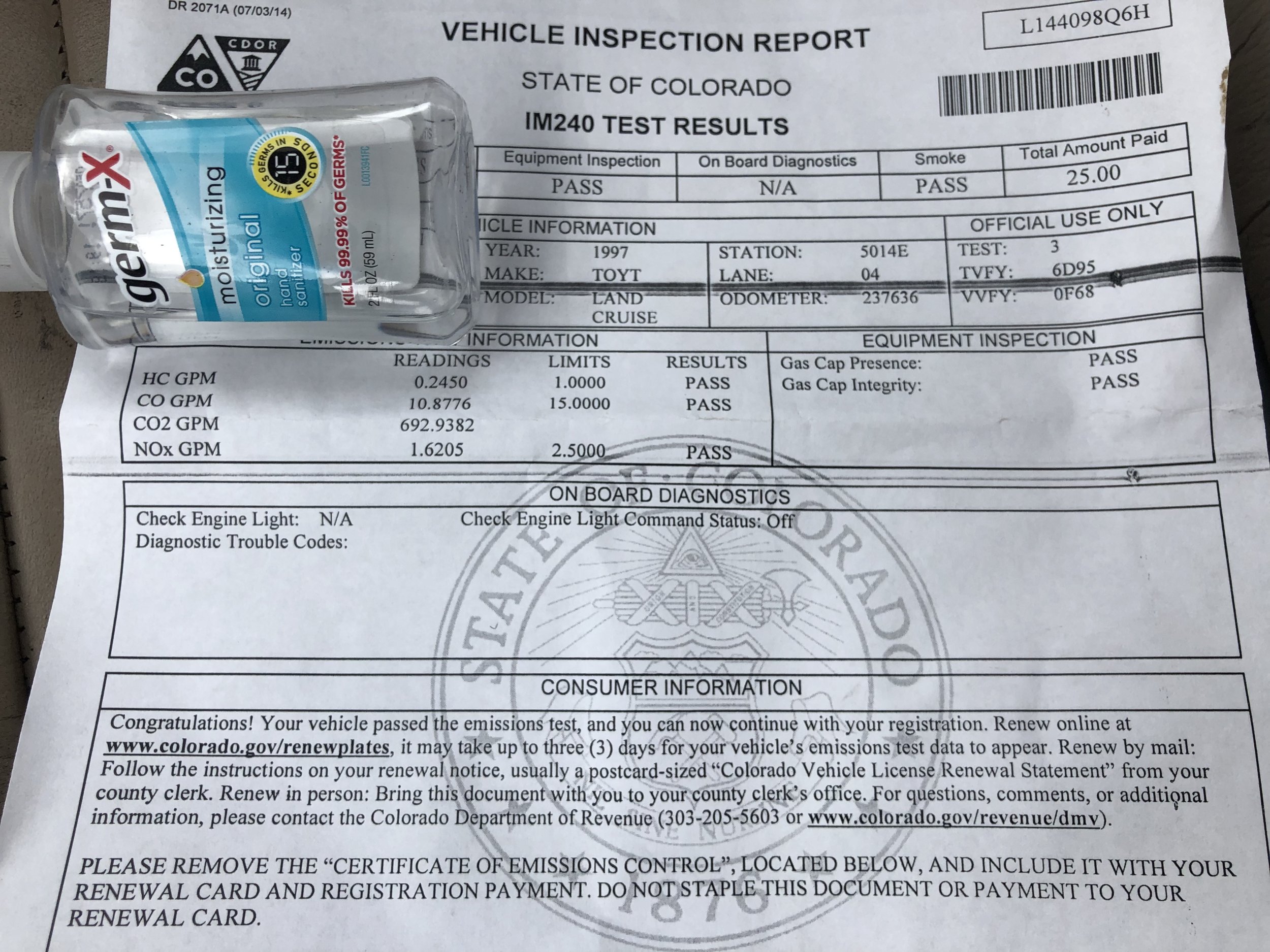

10,764

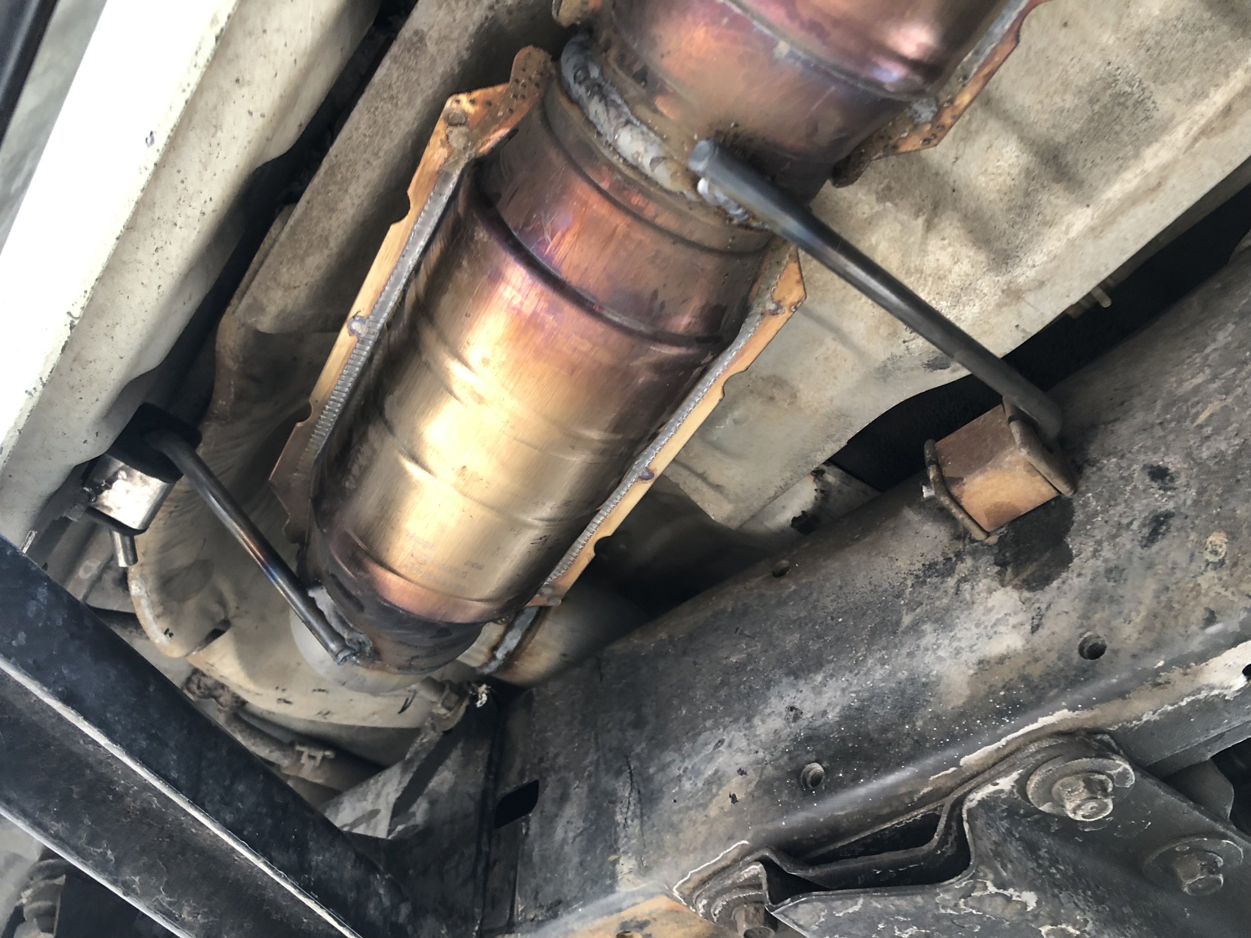

The 97 passed today. Long backstory but I had to put two brand new cats on. Hopefully they last longer than 1 year like the last ones. Got the 3” turned up and over the frame as well.
Here's a link to the records from the '96 for comparison:
And here's all the reports I have for this '97 so far.
2/15/19: two brand-new cats

11/25/2020: after only 1 year, the cats were plugged, possibly due to a faulty knock sensor issue. Limped them along, did an early emissions test, then re-installed the high-performance single cat until the next emissions test was due.

3/17/23: two brand-new cats. Cleanest burning report I think I have ever seen. TIGHTER EMISSIONS LIMITS ON HC AND NOX COMPARED TO PREVIOUS.
