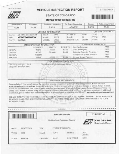

Well holy s*** - the truck passed emissions:
I wasn't expecting it to pass due to OBD2 ready states, but it appears they didn't care about that. I figured I needed to at least start the actual emissions "process" in the (expected) event it failed, but I didn't expect the resolution to be so quick -
It actually passed twice, except for a fail on the gas cap the first time.
I had my 3 little boys with me, the place closed at 1pm, and when they finished with the first test it was 12:49. I raced over to an O'Reilly's right down the street, ran in and got a new cap, and got back at 12:56pm to learn they would need to dyno it AGAIN in order to pass it.
So they got it up on the dyno again, and it passed - again! I'll take it. Major hurdle cleared.
8,682

Yeah I also found that odd re: HC, maybe I should try and register it as PZEV! On the "failed" test it showed up:
Still, 0.08/1.2 seems pretty low.
PS, I used the wisdom of the thread and stuffed two bottles of red Heet in it + 1/4 a tank of 91 the day before going through the test. I also put brand new exhaust on the truck after buying it, including all 3 cats front to back, so perhaps that's another signal of the relatively low readings?

As noted in another thread, I took my #2 FJ80 (265,000mi) to AA Performance in Englehood where they put in new cat's and O2 sensor bungs yesterday. I went in for another shot at CO Emisions this morning and voila- I passed with flying colors, an inop EGR system, and a cherry red Check engine light. See the scan attached. I think the vacuum port that goes through the intake plenum and connects to the VSV is plugged as I can only push a piece of wire about an inch and half into it. Can this be drilled out? Can the VSV be accessed without removing the plenum? Anyway I can hardly contain my excitement at the passing numbers. Long live FZJ 80's, long live Toyota. Now to figure out why the e-lockers on the rig will not engage. I have the dash indicators but no locker's. Anyone had and solved this problem? :)
