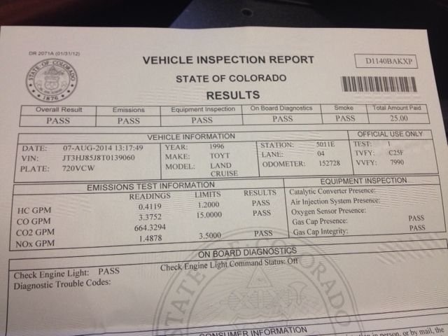

5,462
:cheer: 91 octane and some Heet for good measure.

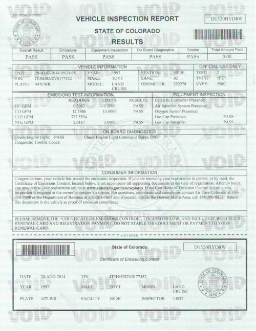

Shark Bait
5,033
Parker, CO
Air filter, cap & rotor, plugs, wires, 2 bottles of Heet and about 10 gallons of 91 octane. Woo hoo!!

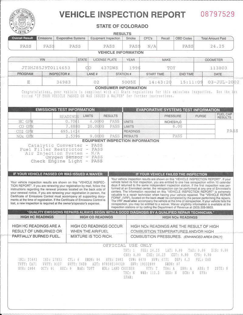

July 2002:

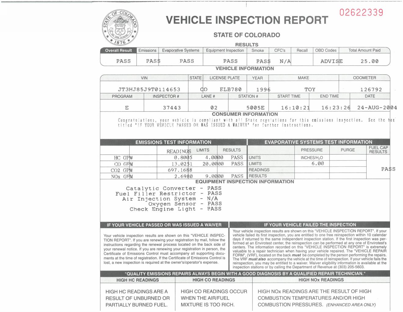

August 2004:

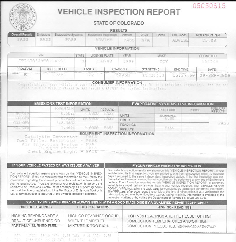

September 2006:
**BETWEEN 2006 AND 2008 THE LIMITS WERE LOWERED**

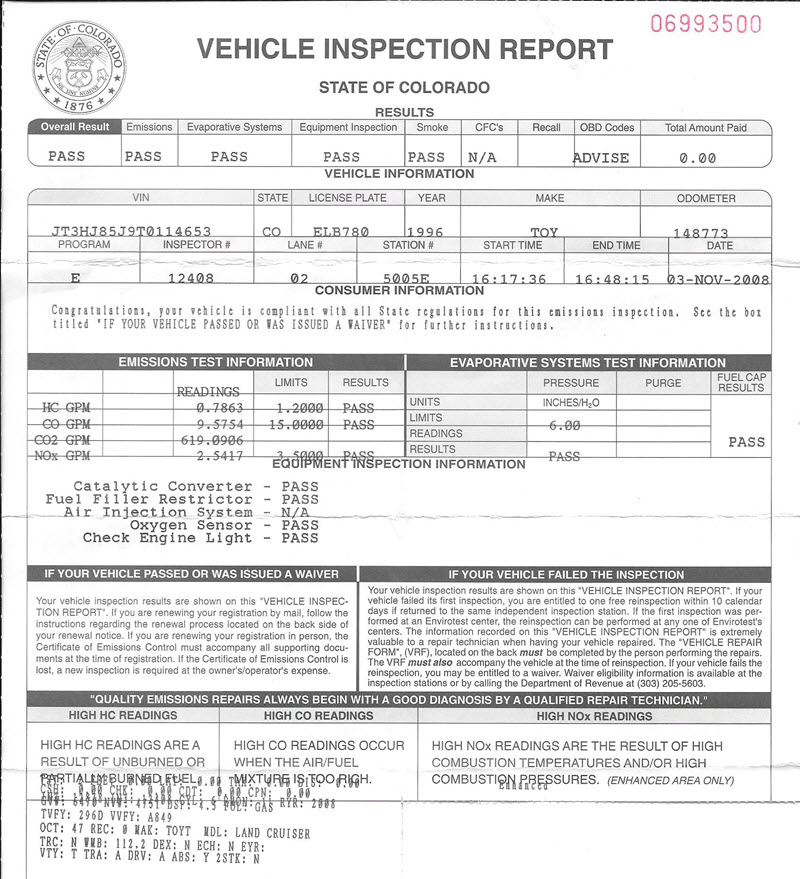

November 2008:

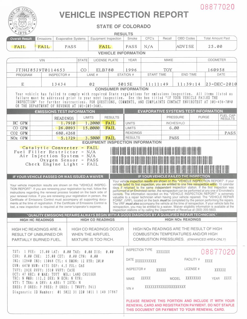

Dec 2010 (FAIL):

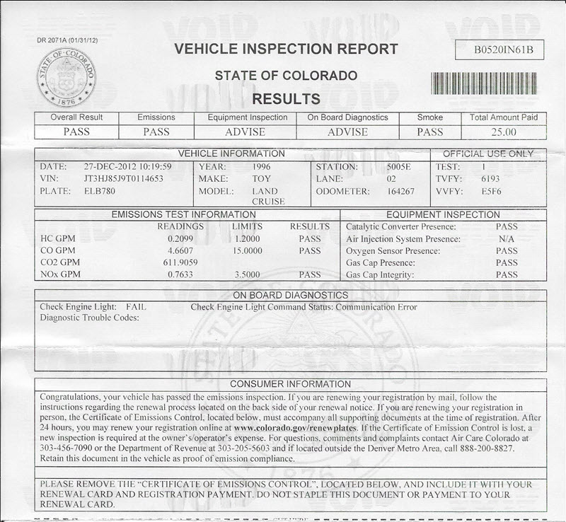

Dec 2012:

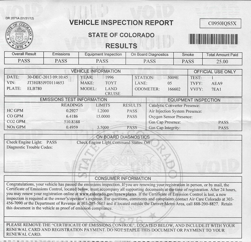

Dec 2013:

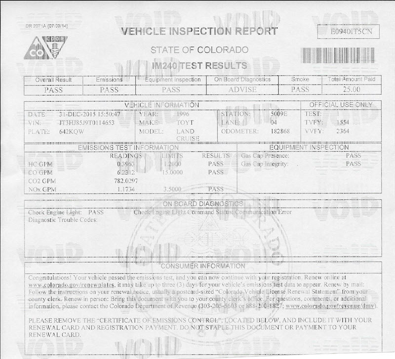

Dec 2015: Nothing special, just drove up to the station. Always run 91 octane.

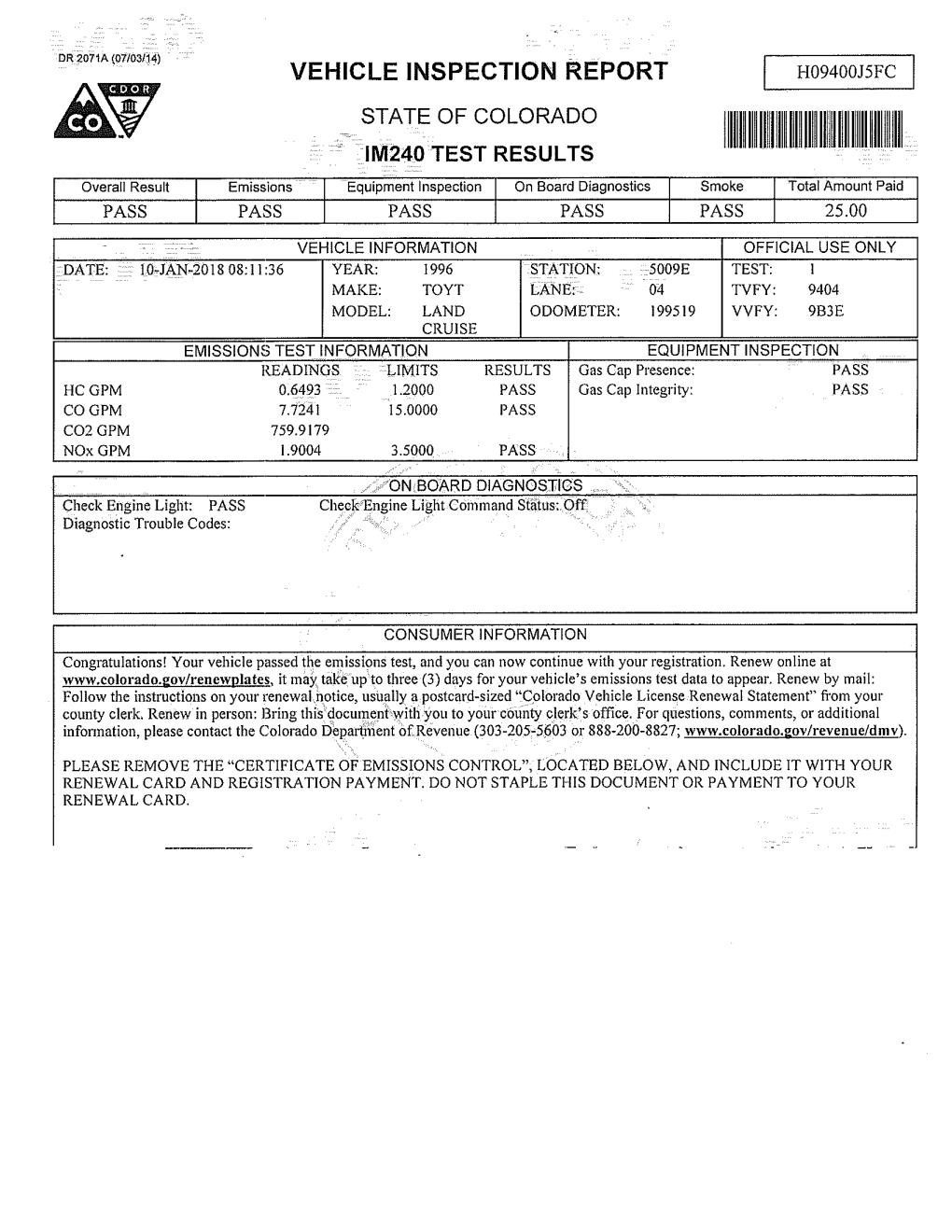

Jan 2018: Just drove to the station first thing in the morning. HC and CO are going up, I bet new plugs would fix it, which I have but just need to install.

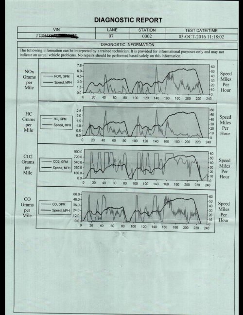

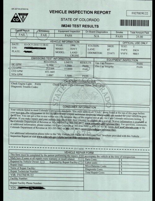

guess it's time to look at o2 sensors
oh, and the hose kept falling off the tailpipe so went through 1/8 tank of fuel driving from work out there and the 30+ minutes of high speed testing on the dyno (seriously...the hose kept falling off, so it was at last count somewhere around 11 attempts racing on the dyno)

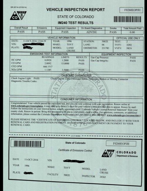

8,682
o2 sensors
