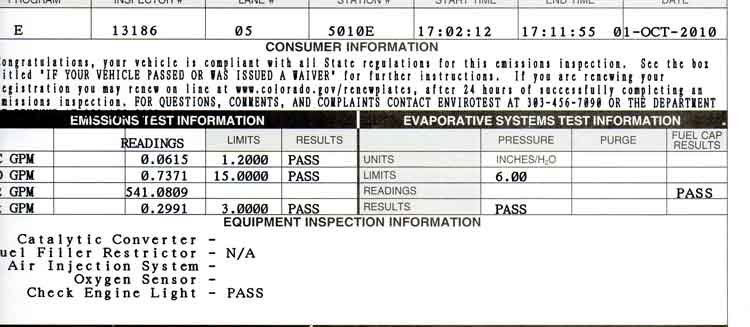

Had my emissions done today. Thankfully the manager measured the tires rather than just looking at the size. Just under 34"
Less than half a tank so I only put in one bottle of heet before driving there
10,593
Centennial, Colorado
just noticed that the limits on my sheet are tighter than those on Paul's sheet. Interesting

Yours is two years newer; I know, makes no sense since what they are measuring is exactly the same.
