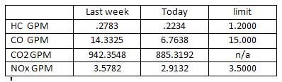

So yesterday at lunch I go down to the Arvada station... forget it that line must have been 20 deep, easily an hour+ wait.
Today I called to verify the AWD rollers are working again, so I take an early lunch to try to beat "the rush." I wait for 20 minutes before I even get to the dude, which I used to eat my Taco Bell and idle at 1500rpm's... :hill:
I finally get my chance on the rollers and it was the most adventure I've ever experienced there. The roller girl runs through the test, and I'm watching the screen and it says "test aborted - oil leak failure." WTF? Don't get me started... my 80 does a lot of things but one thing it does NOT do is leak oil... and I sure don't see anything hitting the ground.
But whatever, fire it up again here we go for round two. This time the screen says something like "unable to retrieve deceleration data - manager approval required." Are you kidding me? So the girl goes and gets another guy, also the senior manager gal, they huddle up followed by, you guessed it.. test three. By this time I've made pretty good friends with the H3 guy in line behind me, who at this point is starting to worry about his new cold air intake and high flow cat-back exhaust... :lmao:
So round three ends with the same error message, but they quickly scrolled through the screens and on forward the 80 was waved. Now it gets really good- manager gal drives the 80 forward, not roller girl... and in addition to handing the gas cap to the old guy at the computer, she proceeds to inspect this truck for no less than 10 minutes, I'm serious. She didn't peek at the cats with the mirror, she laid under the truck for a solid 5 minutes! She then opens the hood, stands on the front tire, then who knows what she's looking at but eventually jumps down and shuts the hood. Looking irritated, she walks back to old guy at the computer, taps in a few comments into the system, then heads back to wherever she's used to standing.
I finally get "the wave," and old computer guy hands me the paper with the "passed the inspection, good for 2 years" explanation of what all they just went through.. wtf just happened? Also the H3 is already done at this point, it's right up behind me with another car already on the rollers (that's how long the visual inspection took)
And to recap, I did next to nothing- I ran my original tank of gas almost empty, then dumped in a bottle of Lucas Fuel System cleaner and filled up with 91 octane.
Then I illegally transferred a "10" sticker from an old license plate onto the 80, and proceeded to drive about 200 more miles, including some solid highway miles.
Can't wait to put the 35's back on, see you in 2 years, Air Care Colorado..
edit: So my CO is down to less than half- is that just the newer gas? And the ozone layer is better but it looks like I'm killing plants now, as I'm somehow releasing less CO2
Here are the readings:

:lmao: yeah good thing they don't test the driver for methane. :eek:
