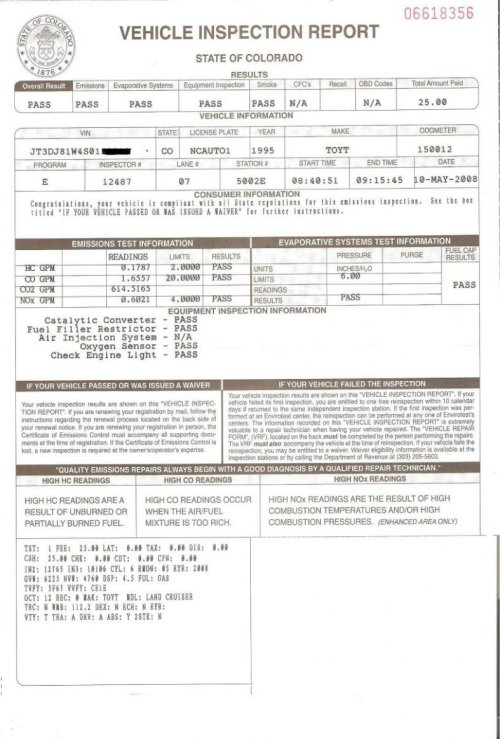

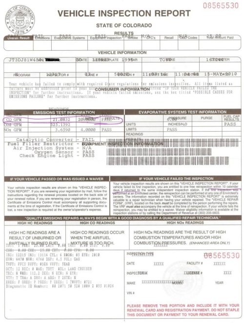

ok, since a lot of people have posted their "results" here, here are mine.
in 2007, i had a seriously beat up rig that the emissions had been pulled off of. i did the following things before testing it in 2008.
new vsv, cleaned egr mod filter, caps, plugs, rotor, cap, oil and air filters, new oil, 2 cans of heat and welded in ONE magnaflow aftermarket cat. p.o. had the original first cat cut out and went from the 2 1/2 head pipe to 2" that went down, sideways and up over the frame, then back all within a six inch stretch.
the first page is my results then
since then, i've put around 12k miles on it, i removed the p.o. section of exhaust and put in flex for now (which does leak), replaced injectors (had issues), replaced fuel filter, replaced fuel sock, replaced air filter, cleaned out the tube through the intake manifold for the egr. two days ago, i put seafoam in both the fuel tank and engine and ran about 150 miles (til tank was low). filled with 91 octane, changed oil and oil filter...here are todays poor results. same station as last time. i did notice a fail on the inspection...they must've figured out it takes two cats. hard to see the hc...1.2177 and the limits are 2.0

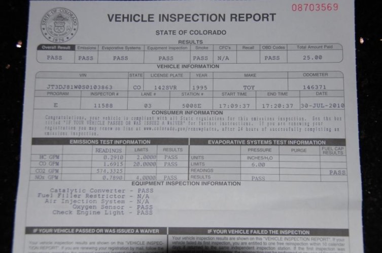

Passed! I added second cat to pass visual, dumped 2 bottles of heet in. So the only fail I've had in 20+ years of emissions was without heet
hc .6705
co 1.9567
n0x 3.4611

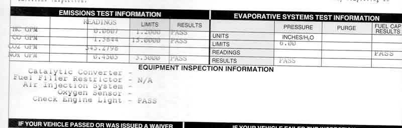

Alright, I'll add mine. I did do two bottles of the Lucas Full System Cleaner that Nakman used. It did better than it did two years ago.
