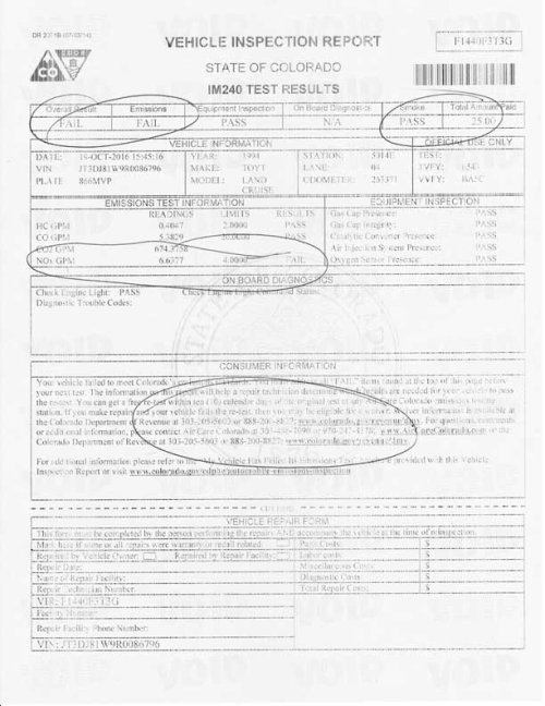

I got an oil oil change and air filter change done-topped off the tank with high grade and 3 bottles of heet, set the base timing, rolled down the windows that would, aired up the tires and ran her through the emissions station at 30th and Peoria with the slimmest of hope. You guessed it-she failed spectacularly with a high NOx of 6.6.
Here is where the story takes a turn. Worse or better you decide. The very next day (Oct 21) I was sceduled for and received a total left knee replacement at University Hospital in Aurora. I was in Hospital until last Monday and have been convalescing at home since then. I am happy to report a near miraculous recovery as I am now walking normally albeit with a deal of pain. I know this has nothing to do with the all-important 80 story but I can hardly contain my joy. OK so back to what's really important.
I will include the IM240 results at the end of my ramble so be patient. The rig popped a code with disappeared again on the way home from Springs tho I have not attempted to red it out yet. I could use a bit of help tracking down my smog problem if anyone out there would be so inclined. :D

Im240

Thanks for the reply and the astute advice Mike. Yes, another high miles rig. I am deficient at this point in my search for the "NOx demon" but will post more as I know more. I went through the nasty job of de-carbonizing the intake plenum and replacing the EGR valve along with numerous other maintenance protocols on 80 #1 only to be short circuited again at the e-station with High NOx. I am hoping to cut to the chase and root out the demon before I go through that ordeal again with 80 #2.
