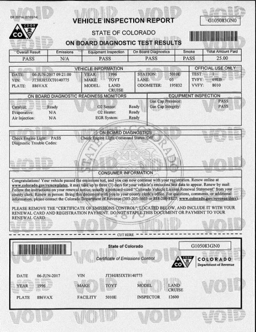

Took my 1996 FZJ80 over to the ACC facility off of County Line Road. They tried and failed to run the test on the rollers with my 35" tires -- they said the front rollers wouldn't turn.
The (really nice) guy said, "If you like, we can run an OBD test but it's a little harder to pass." I agreed. A couple minutes later, I had passed and was on my way.
I didn't know this was an option. Is this new?

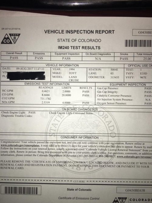

Followed Ige's advice (two bottles of heet on half a tank of 93 octane) and passed with flying colors. I think I was more nervous waiting for them to test my 80 than I was when my son was born. At 315k miles and not having any prior history of this vehicle, maybe I should go buy a powerball ticket....

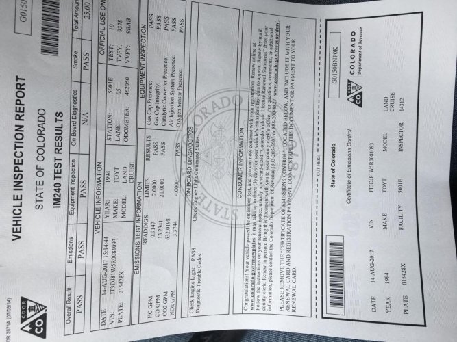

My fresh 80 with 462k original miles passed wahooooo!
