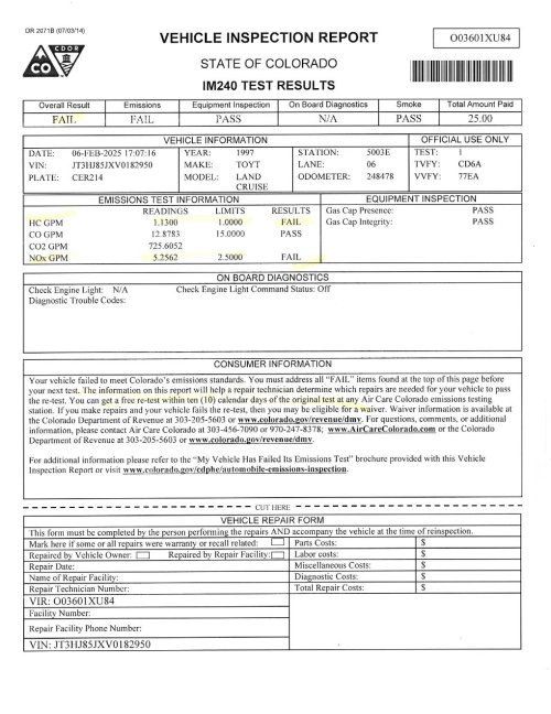

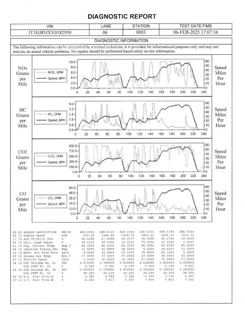

So with my recent emissions failure I checked some things out today. The EGR modulator is not behaving per the FSM. But if it has failed wouldn’t that throw a P0401?
Failed step 6 here.
Also failed step 2 here
1. Replaced spark plugs, cap and rotor.
2. Adjusted timing. It was slightly retarded, maybe 2.5 deg instead of 3. I almost left it but wanted that notch dead on the 3.
3. Checked the EGR modulator per above. Still head scratching that one. Might buy a new one just to try and have on hand.
4. Washed the air filter. I think I’m done with the washable air filter. I think it’s cool and all but I think I will just buy new regular ones when needed.
5. Checked the EGR valve. Works like a champ.
6. Checked the temperatures of the cats. Outlet is about 150 degrees higher than the inlet, so that seems good. EDIT 3/28/25: On second check, inlet is about 600F, outlet of cat 1 is about the same, maybe even cooler, and outlet of cat 2 is 700F. So It seems cat 1 is dead.
7. Put some Lucas fuel injector cleaner in and ran up 285 to Bailey and back.
8. Checked spark plugs wire resistance. Well within spec.
I dunno 🤷

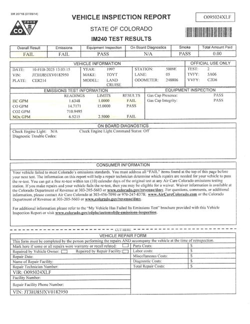

10,764
After all that I added some HEET to the tank, drove C-470 for a bit, and tested again after having to wait in 45 minute line. Results worse than before. CO was almost high enough to fail this time. Going to have to dig deeper.

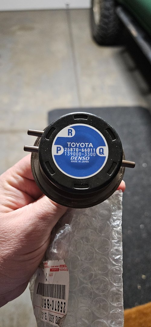

Were you able to replace the EGR modulator before the test?
I "replaced" it with the one from the green 80, but they both behaved the same during testing so not sure if they're both bad, or both good? Again not throwing any codes, and if the modulator was bad I would think it would be throwing a code. I have a new one on the way (thanks @RayRay27 but I just decided to order a new one) so I will do the same FSM tests on that when it comes and see if there is a difference. I wasn't really expecting the NOx to get any better with what I did yesterday, but I was hoping that the HC would come down so I would only have one problem to deal with instead of two. Was also wanting to see if what I did made any incremental difference, so that when I do figure this out I can have a better idea of what the smoking gun was.
