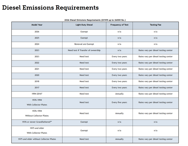

Here's the year ranges, I think if i was to try this again, I would've done this from the beginning. Title it somewhere else, get the fuel type switched to diesel, then re-title in Colorado. I'd say we're probably past the point of no return due to me trying to get it done the "right" way. I do agree for those that come after me, if you live in the diesel emissions program area, or maybe even the gas emissions program area as well, register it as diesel elsewhere.
The Tennessee title I do have, doesn't have a fuel type listed, so be sure whichever state you do title it in, they have a specified fuel type block, and they don't have an emissions program themselves.
8,767
wow, all diesels tested regardless of age if not exempted through collector plates. so so glad i left kalorado. i understand wanting to keep the air clean but what kills me is the cleanest vehicle in the world can't pass if it doesn't pass a visual. that proves it's all about the money, not the air.
