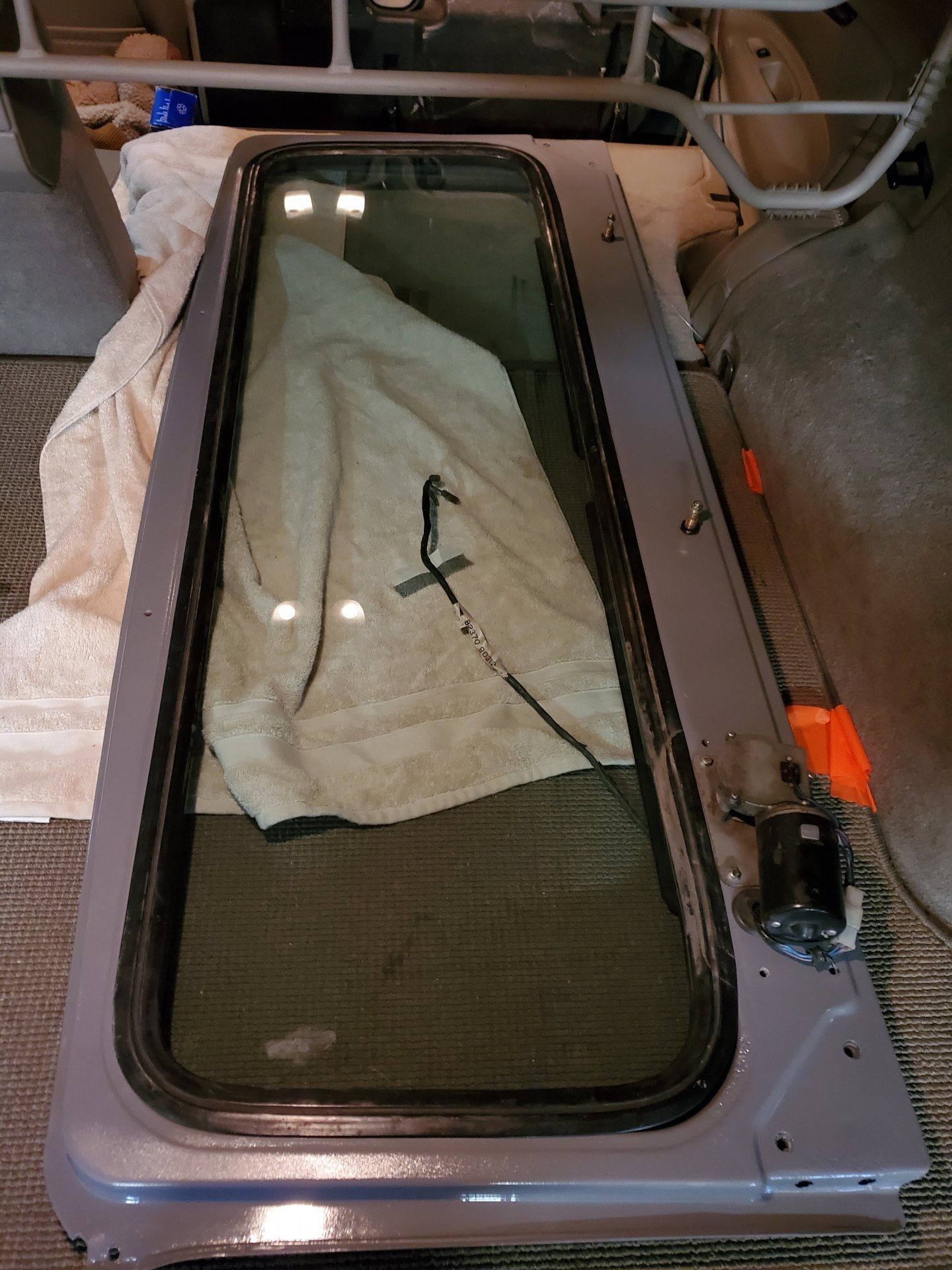

I got the windshield glass cut and installed.

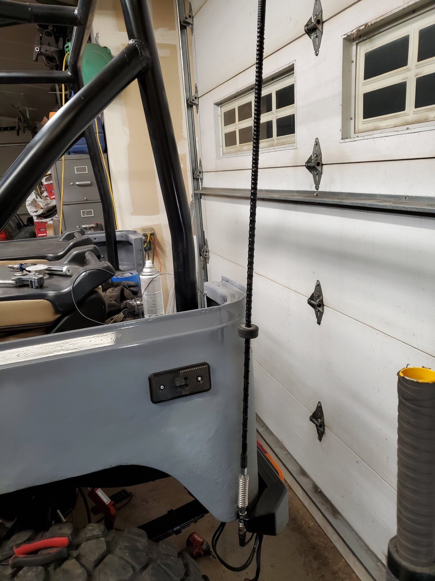

CB antenna installed.

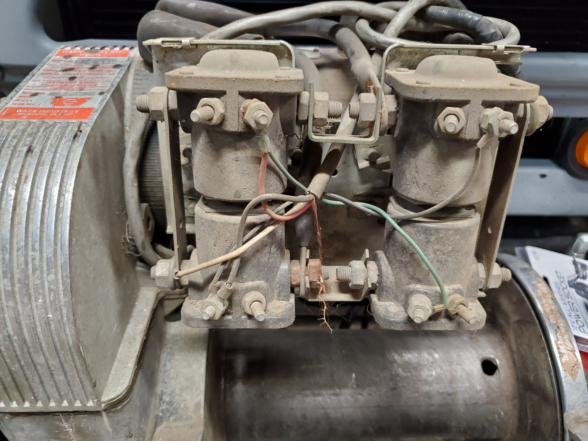

New power pulled to the winch, and all solenoids seem to be working, so I got my in-cab winch controls wired and working.

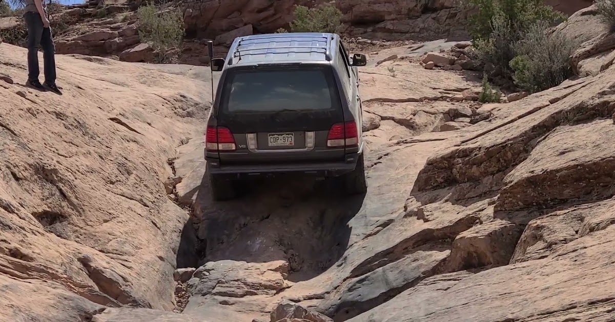

Wednesday morning, I checked in to Cruise Moab, got unloaded, and headed out with some friends to prerun Flat Iron Mesa since they were Leading / Gunning it the next day.
"The Chute"
The Cruiser walked it with no lockers very easily. I was still running about 20 PSI in the tires as well.
@DomOfTheDead in his Taco up The Chute.

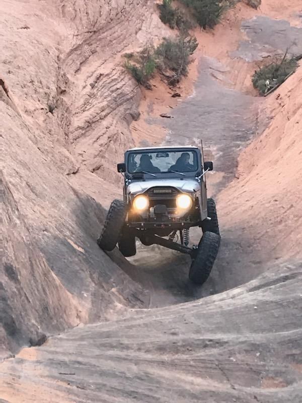

I got my rock lights wired up then, and I'm really glad I did. The Night Run was a blast. We had a pretty experienced group running it, as there was very little traffic since it was getting dark.
Somewhere near the beginning.
Green River Overlook from Hells.
Jackson Philby getting tippy on Hell's Gate.
Me, screwing around on Hell's Gate.

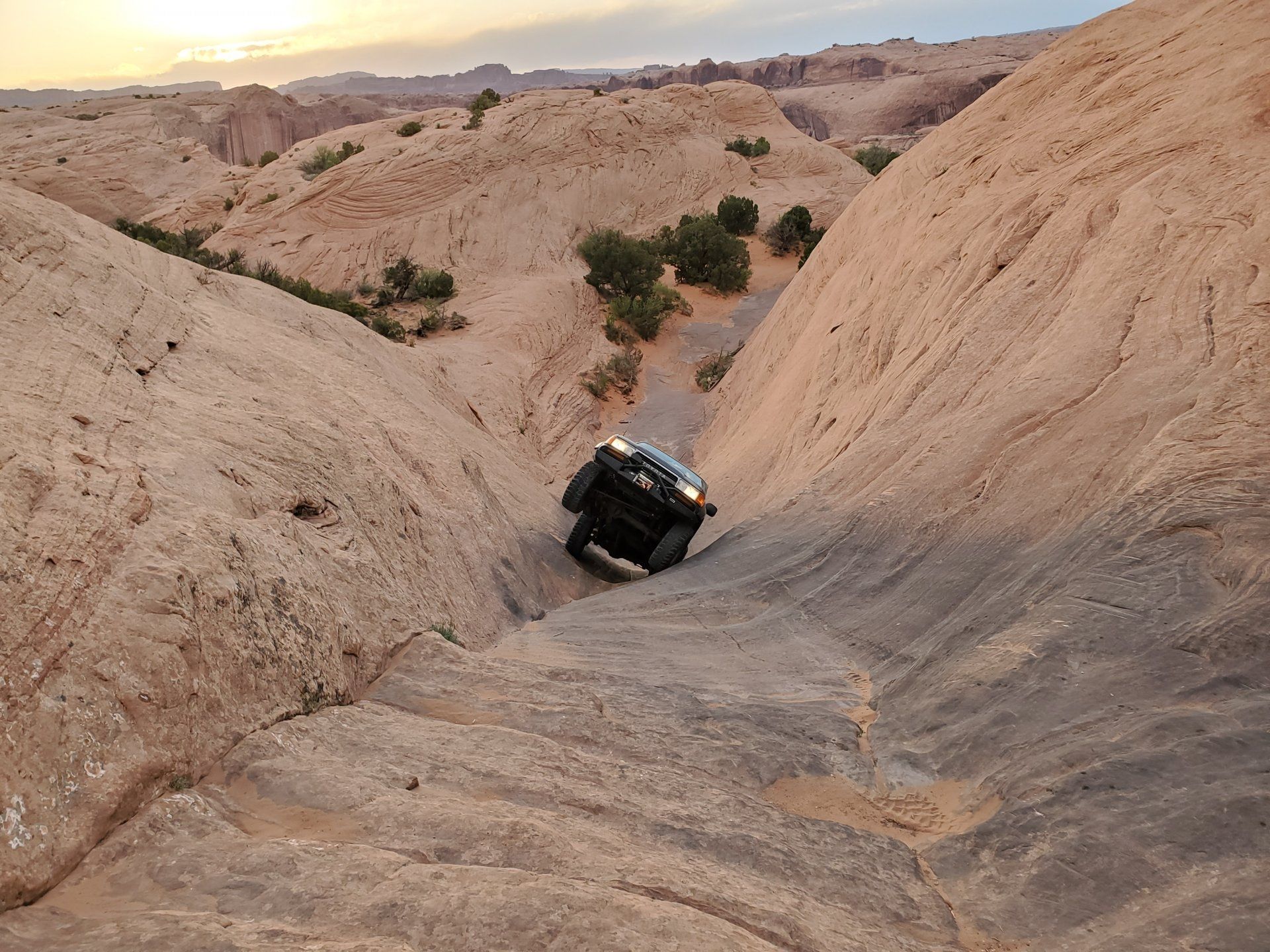

Saturday, I gunned Kane Creek. It was a ton of fun, and Hamburger Hill was a good challenge for most of the rigs.
The entry obstacle.
The Squeeze
Playing in Kane Creek.
