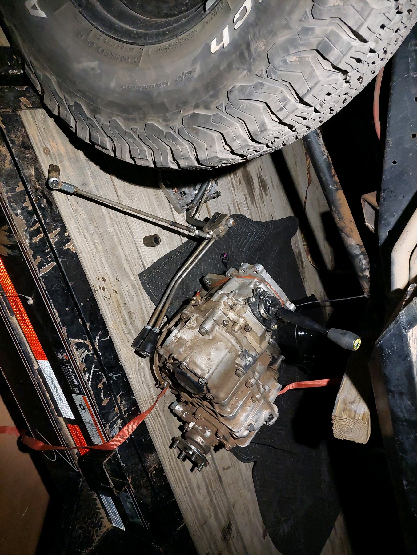

New coilovers for the rear. King 2.0, 12", with compression adjusters. I'm planning on a 1:1.2 rear cantilever suspension and mounting these laterally in the wheel wells. Should give me about 14" of rear travel, without cutting my floor.
Went to Cruise Moab. Led and Gunned a few trails. Was a ton of fun.
This fell out after my last run on saturday.
I'm back at the shop for the summer, and this showed up. 2016 LF4 and 8l90. Current dimensions foe the LF4 I have taken are around 24" long, 30" tall, about 30" wide. 8l90 is about 23" long.
Compared to a 8hp80 and R2.8
LF4 8l90 combo is about the same length, about 4" wider for the engine.

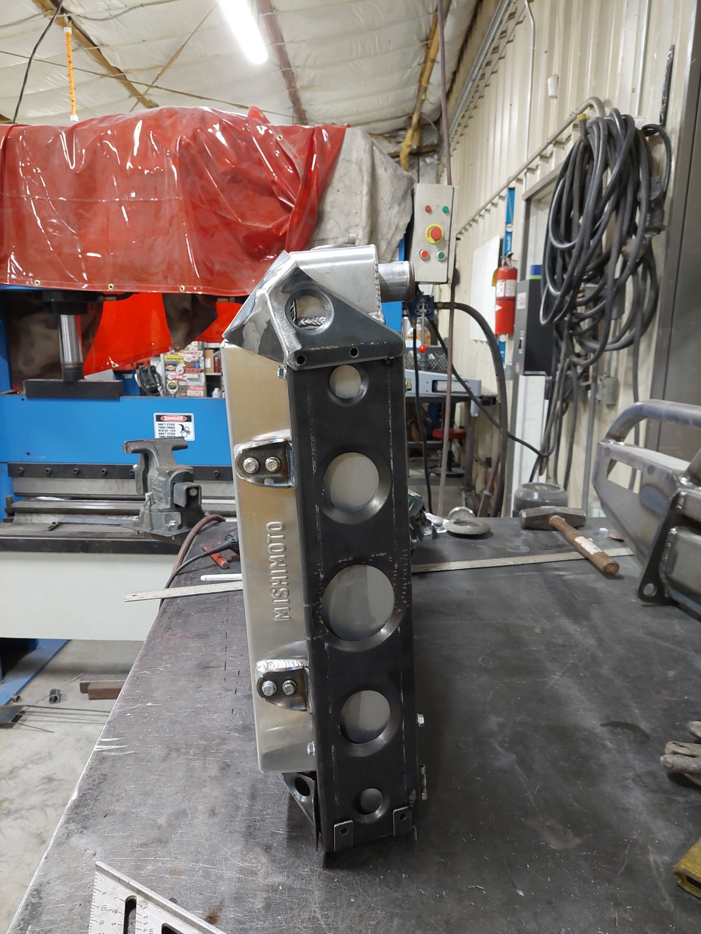

Cooler stack.
Intercooler tabs.
Done! It all bolts together, just need to figure out location and mount it once the engine is in.

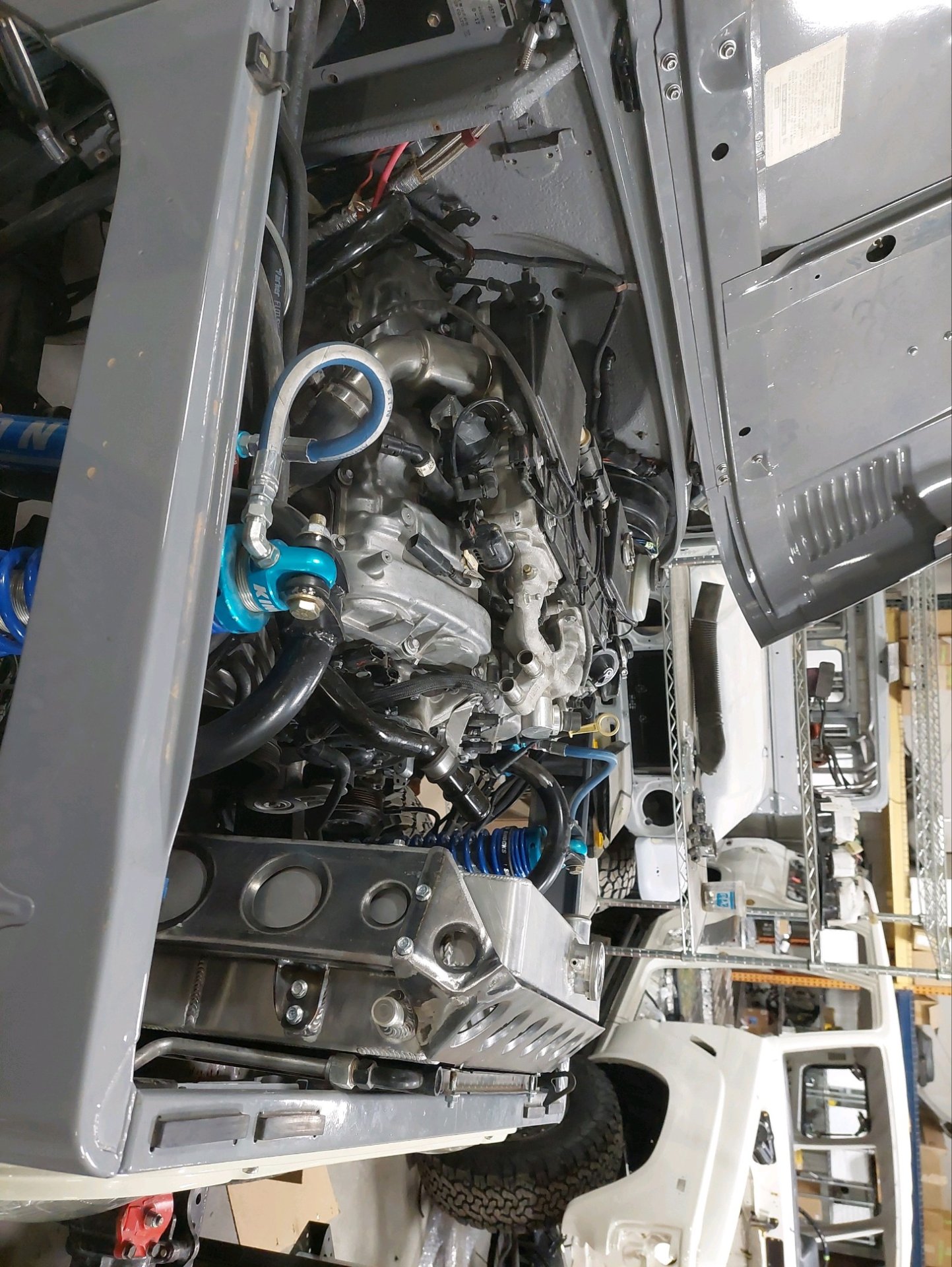

*excited monkey noises*
It fits like it was meant to be.
Full access to run the exhaust, which is a massive win, cause I wasn't sure if that was going to be possible.

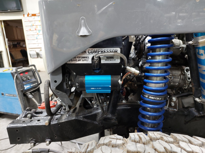

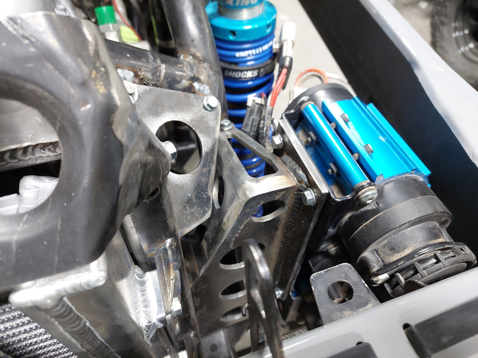

ARB Comp mount
Tucks into the dead space nicely.

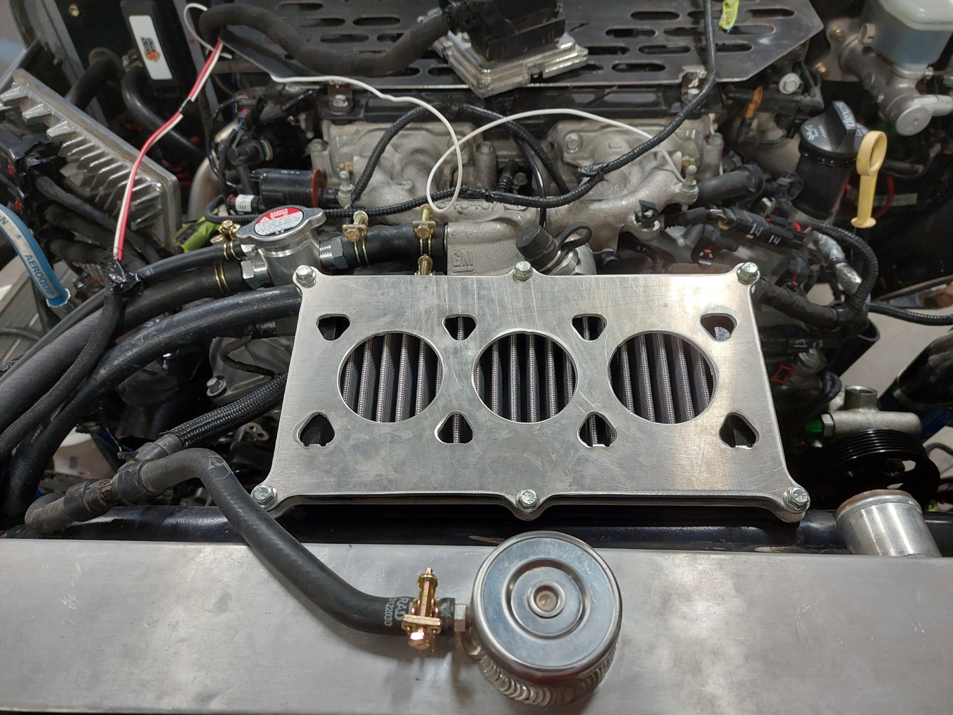

Start on the air box. I love aluminum.
Air filter fits great. It's an AEM Dryflow, like I always run. Should theoretically flow about 2x the necessary volume for this engine.
Inital test fit of the box.
Mounts cut out and dimple died.
Tucks in nicely.
I'm not sure if I like the lid.
First intake tube mocked in.
First hole cut.
Driver side tube
MAF Bungs.
Done! Lots of bungs that had to be welded.
ARB manifold mount.
Fits awesome, everything clears.
All that is left is the ECM / TCM mount, and P/S resi.
I didn't like the airbox lid so I remade it.
Much better.
