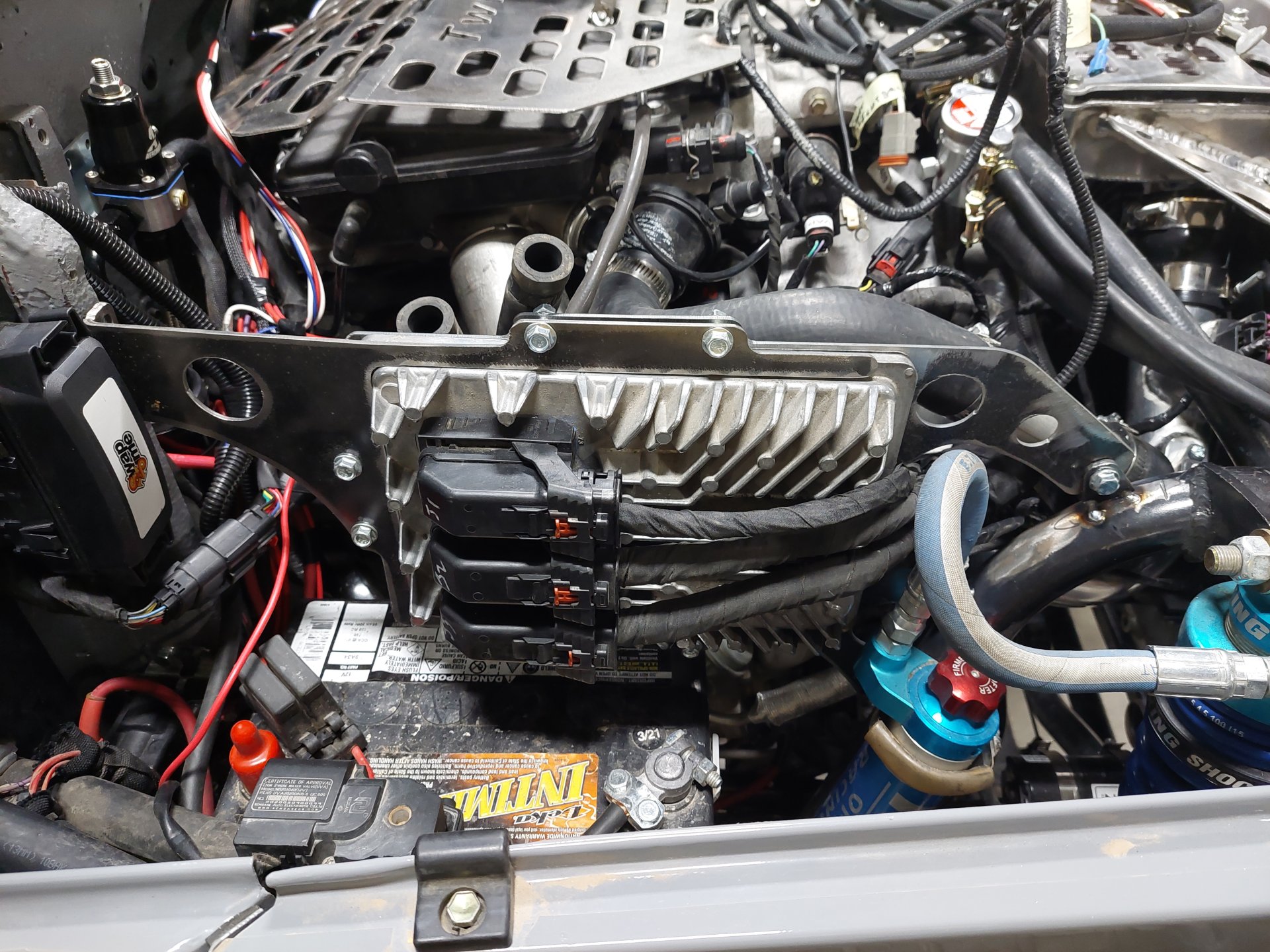

ECM Mount
TCM mount

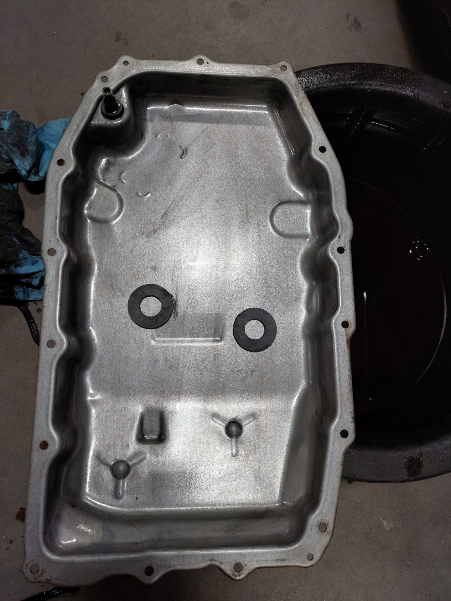

Pan off.

A quick pan wipedown.

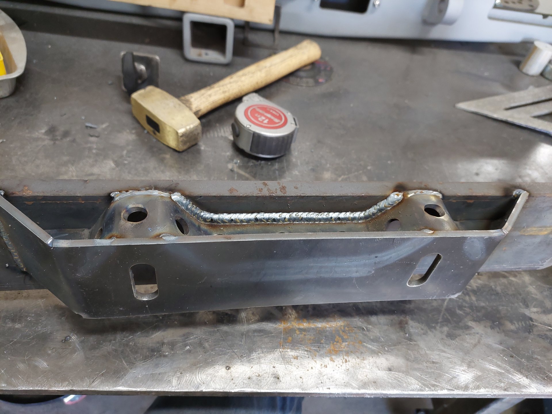

Crossmember time.
8l90 tailhousing mount.
A fun fold later.
A quick test fit.
Welded up.

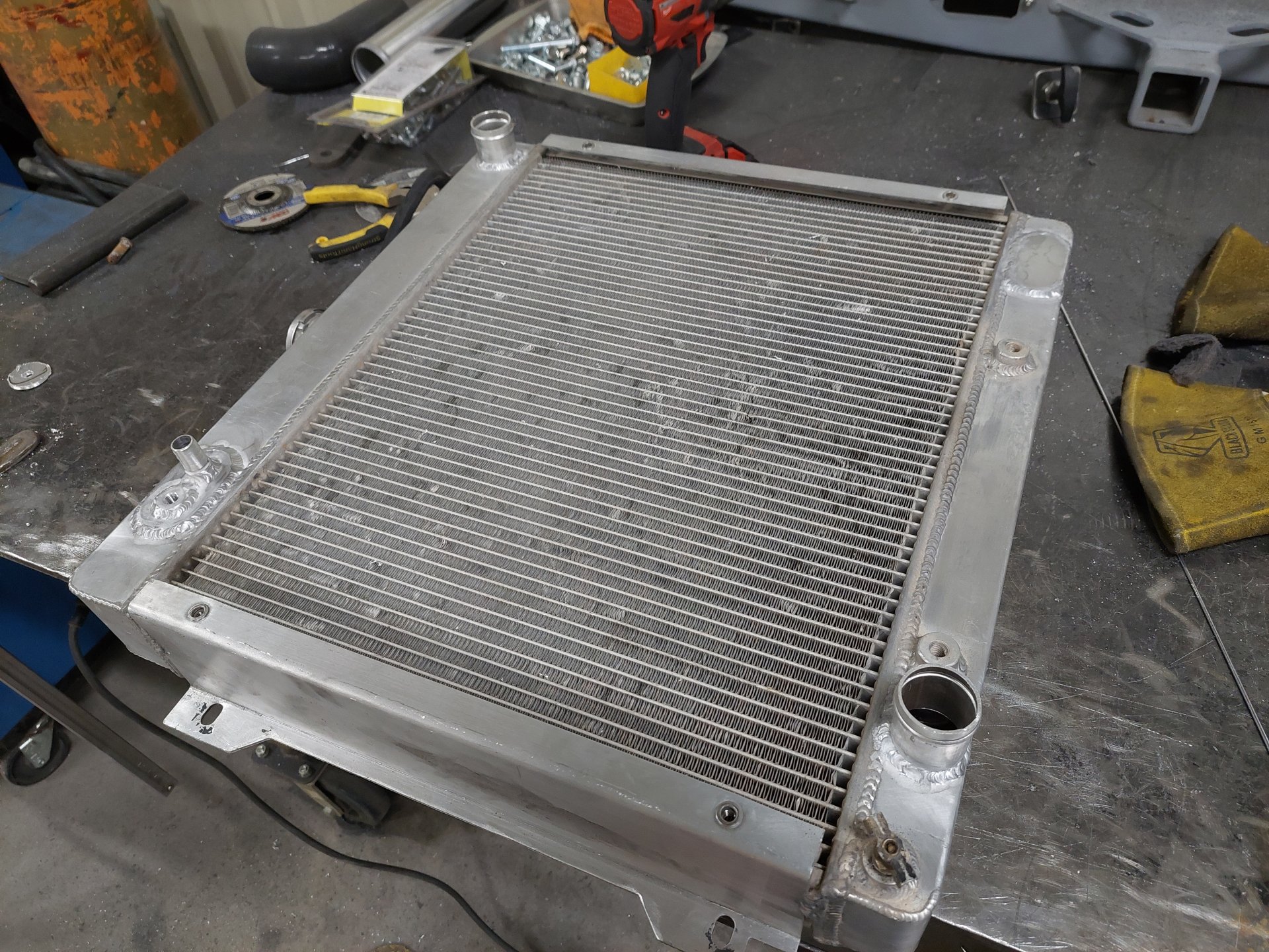

Anyways, radiator time.
Had to switch sides for both inlet and outlet, added in a temp sensor bung, and a 5/8 hose barb for the oil cooler outlet.

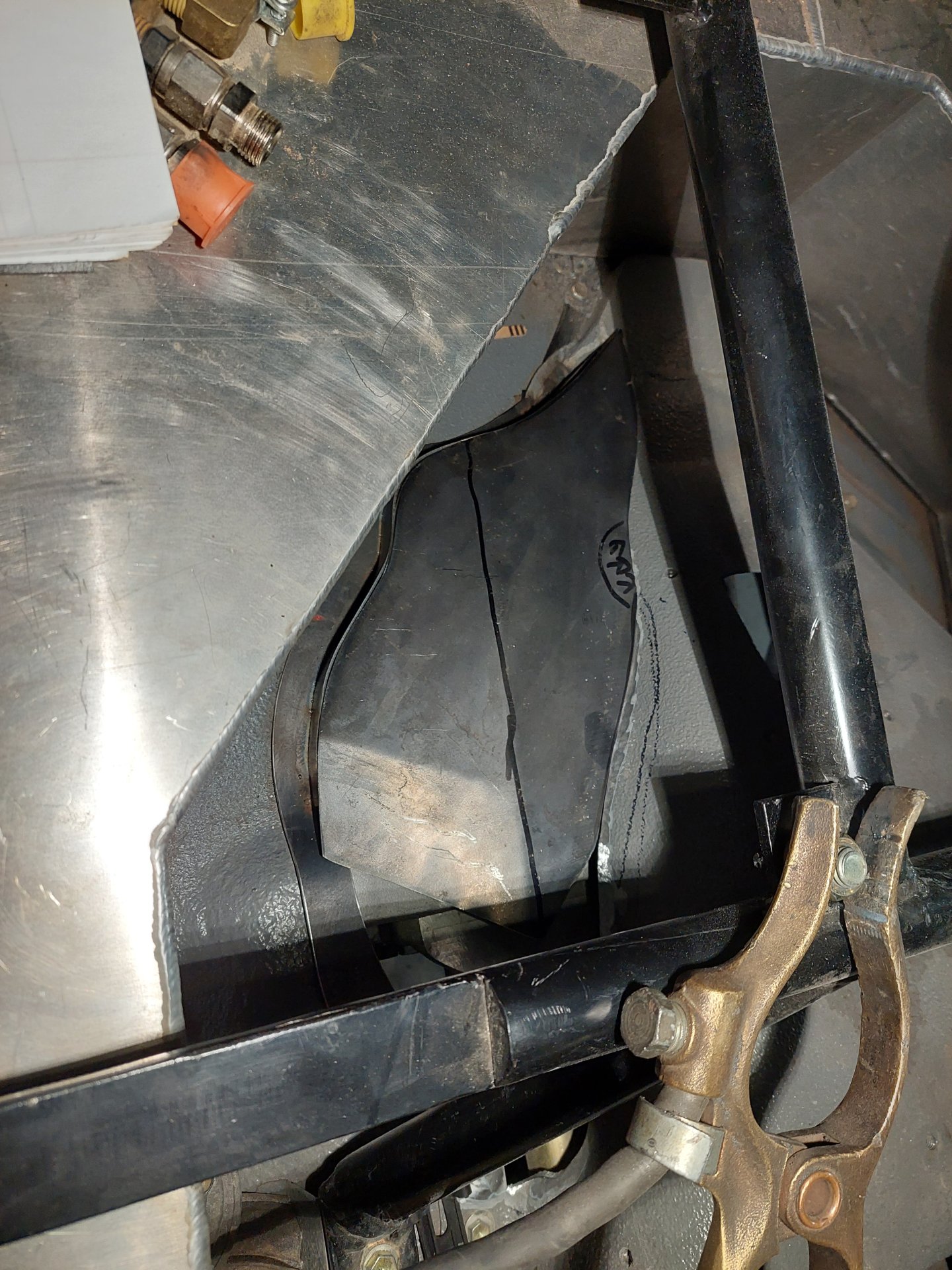

Everything drawn out on where to hack.
Cover plate #1
Cover plate #2
All done!

Ecm
