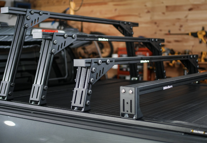

Check out all of the bed rack systems, how those guys are incorporating 80/20 as cross bars mated to steel frames. Billie Bars comes to mind as one example...
there are many more also. hth!
