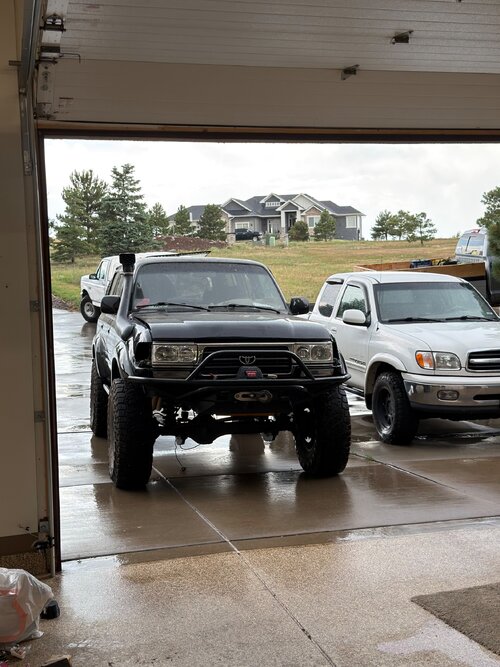

Hi,

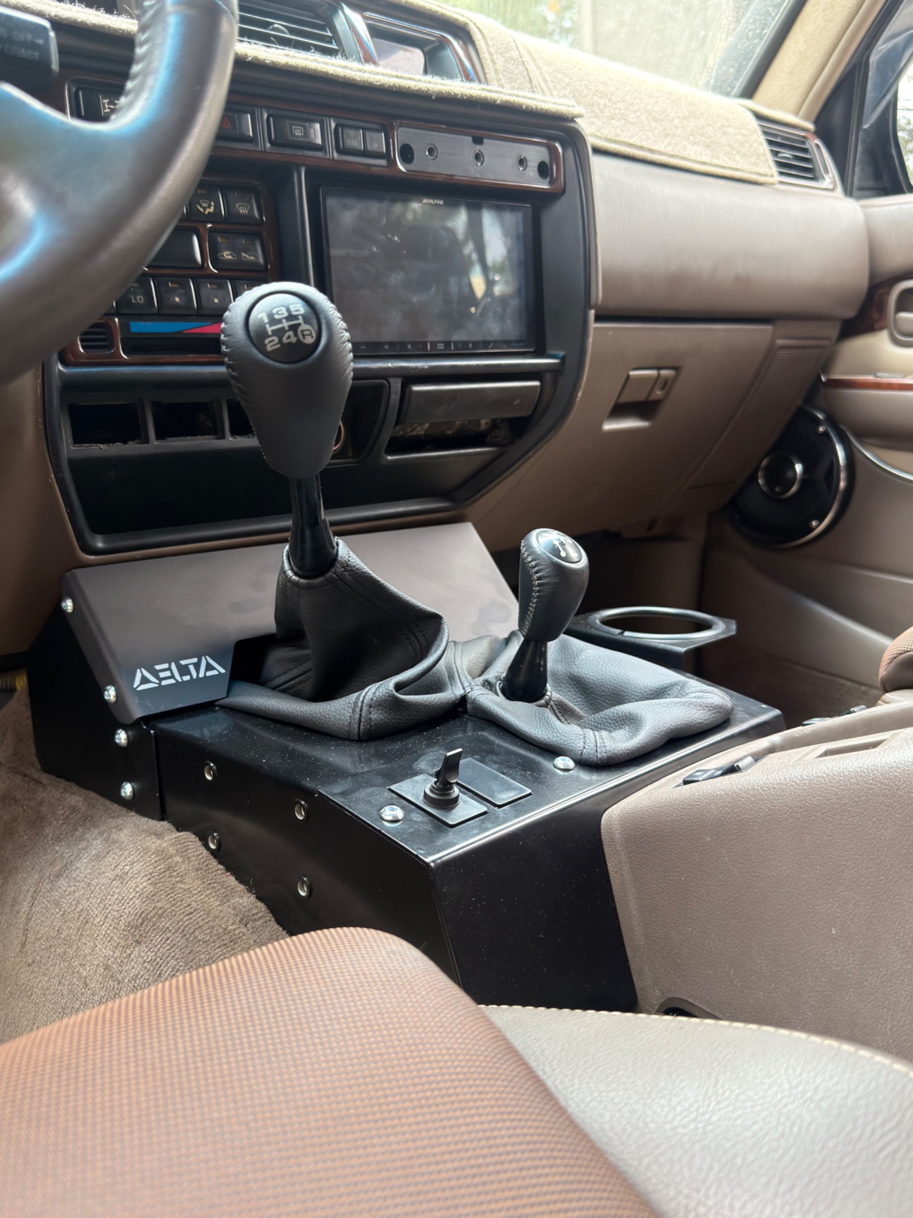

I rebuilt the engine in my cruiser and swapped in a 5 speed manual and it runs great. But I have this death wobble issue that has arrised since parking it. We for the life of us can’t figure out what it could be. It had a little steering wheel wobble before I parked it, but now it is awful. We thought maybe it was the wheel bearings that were slightly loose and we tighten them up but it is still scary bad starting at around 40 MPH and starts without hitting a bump or anything. It has a Red Head Steering box on it, and everything underneath seems tight and its all pretty new stuff down there (Iron Man panhard has been on there for a couple of years and we can't see any play, and the Delta arms have are maybe 2 years old). We are thinking it might be the tires. We did go get them rotated and balanced and that didn’t change anything, but they could potentially have permant flat spots. Discount Tire will warranty the tires if we can prove the theory by swapping tires and providing video evidence the shake goes away (which is awesome).
So is anyone in the Monument/Colorado Springs area that would be willing to come over and swap tires with me to prove this theory? Tire size doesn't matter, just need the bolt pattern that fits an 80.
Anyone that could help I would greatly appreciate. Happy to pay for your time, or beer or whatever it takes. Thanks!

5 speed in an 80 is sweet!
