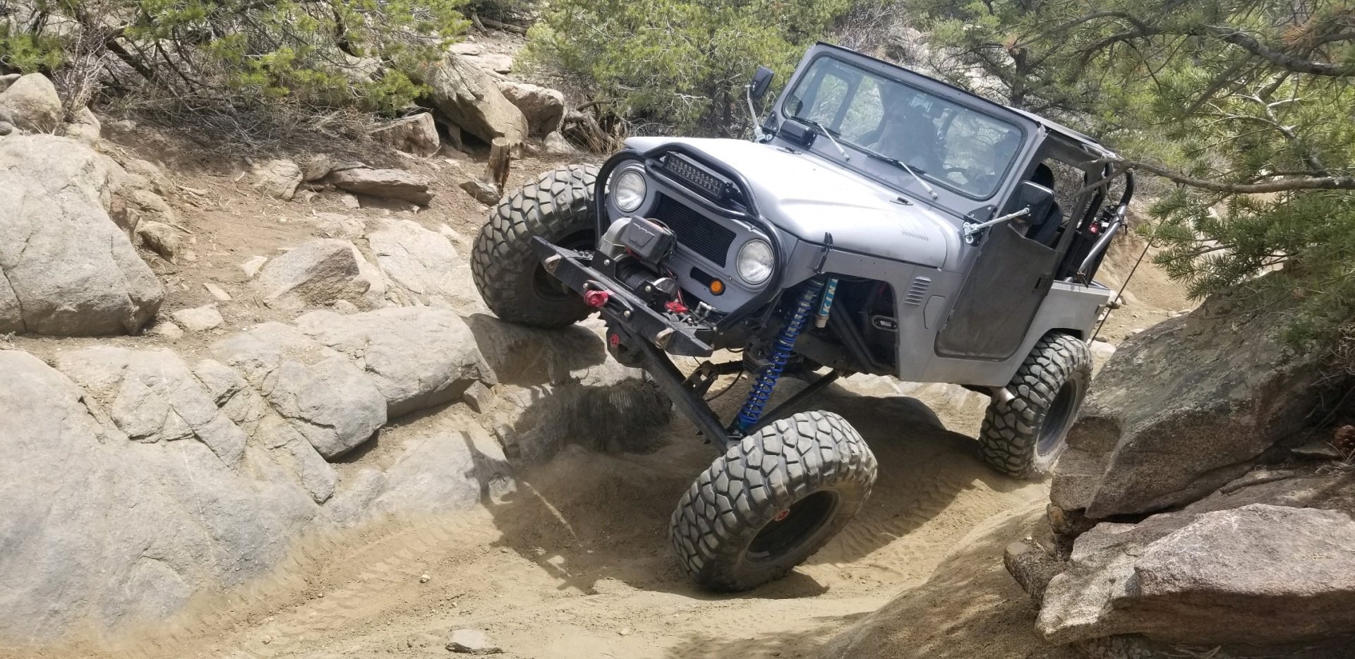

Last Sunday I decided to go run Chinaman Gulch with some of the Rising Sun 4x4 guys. I decided to drive the cruiser out and back to add some highway miles to break everything in. It was a ton of fun, I scared my mom a few times, and got to drive the cruiser which is always great.
With no radiator shroud, and a lot of slow, uphill crawling, I was running really hot. I was able to keep it under control with a lot of water on the radiator and the heater constantly running, but on the final descent out, I started to really gain heat that I could not seem to get rid of. Once I got to 220, I stopped and shut off my engine. Looking back, not the smartest move shutting off my engine. Now, at Cruise Moab, I added a tap to my lower radiator hose to get my heater because I thought that I needed suction through the heater core, so I cut my lower hose and added it in. It needed pressure, so I just added some exhaust tube to rejoin the two pieces of radiator hose as a quick fix to keep me running for Cruise Moab. When I stopped and shut off my engine, opened the hood, and started spraying some water on the radiator my lower hose blew off. It covered my shoes really well and burned my left foot. I'm really happy I was wearing jeans. It burned my left foot enough that I got some blisters, but it's fine now. Now, the patch that I added had no flanges, and the pressure from the sudden heat buildup, and the shutdown of the engine probably overcame the clamping force of the hose clamps and slid the hose off.
I wish my lower hose was the only problem that day. I'm guessing we easily added 3+ gallons of water to the rad and block, and I still had to add almost another 2 when we got back to the Gunsmoke. I knew that hose was eventually going to bite me in the ass, and it did. I have plans on trying to keep a bit cooler on the trail, but that will be happening once this is driving again.

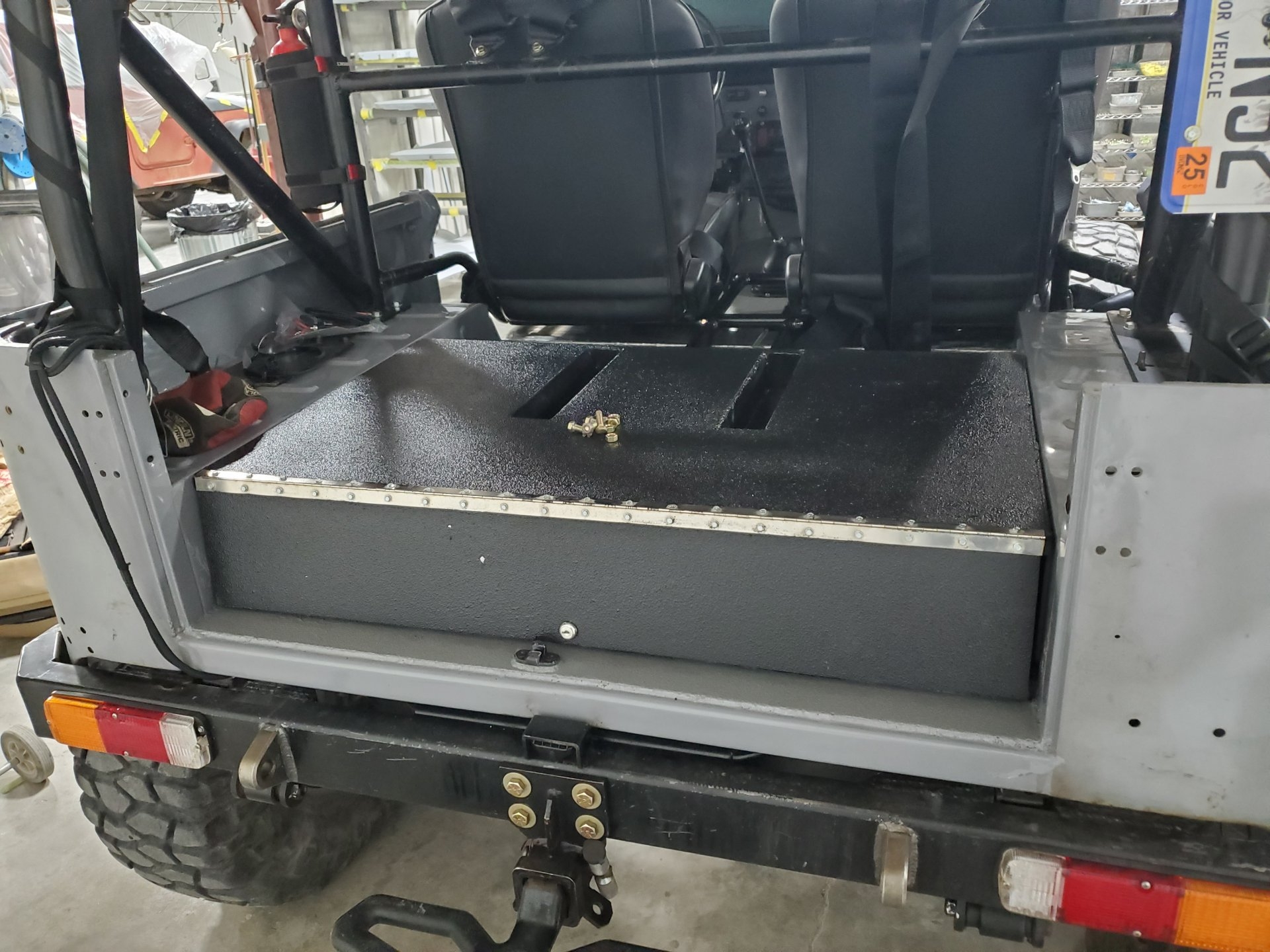

I got my rear box lined as well since everybody ends up walking on it.

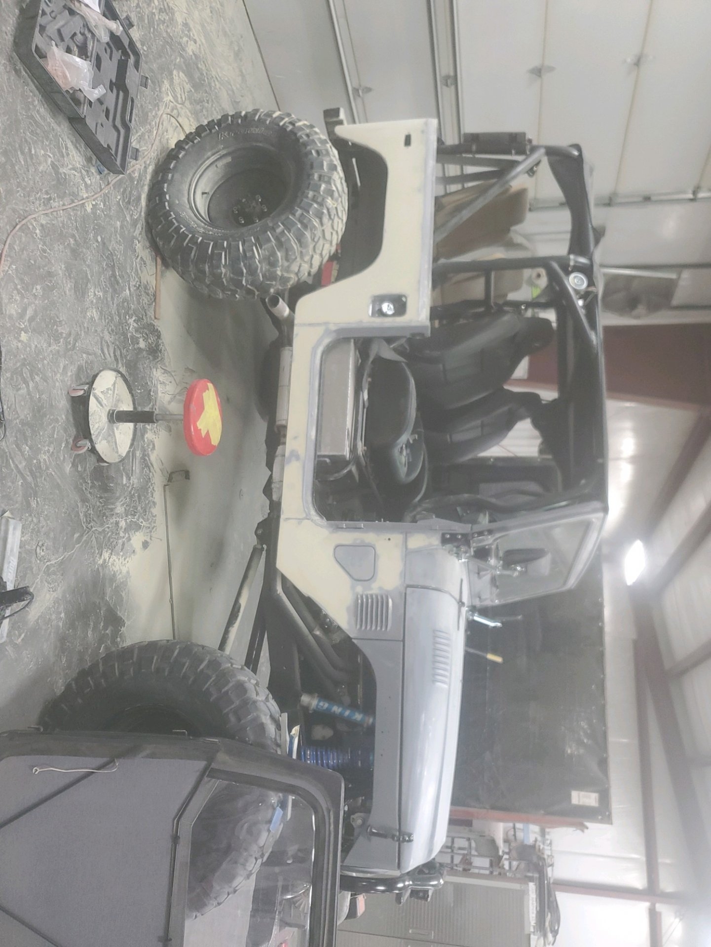

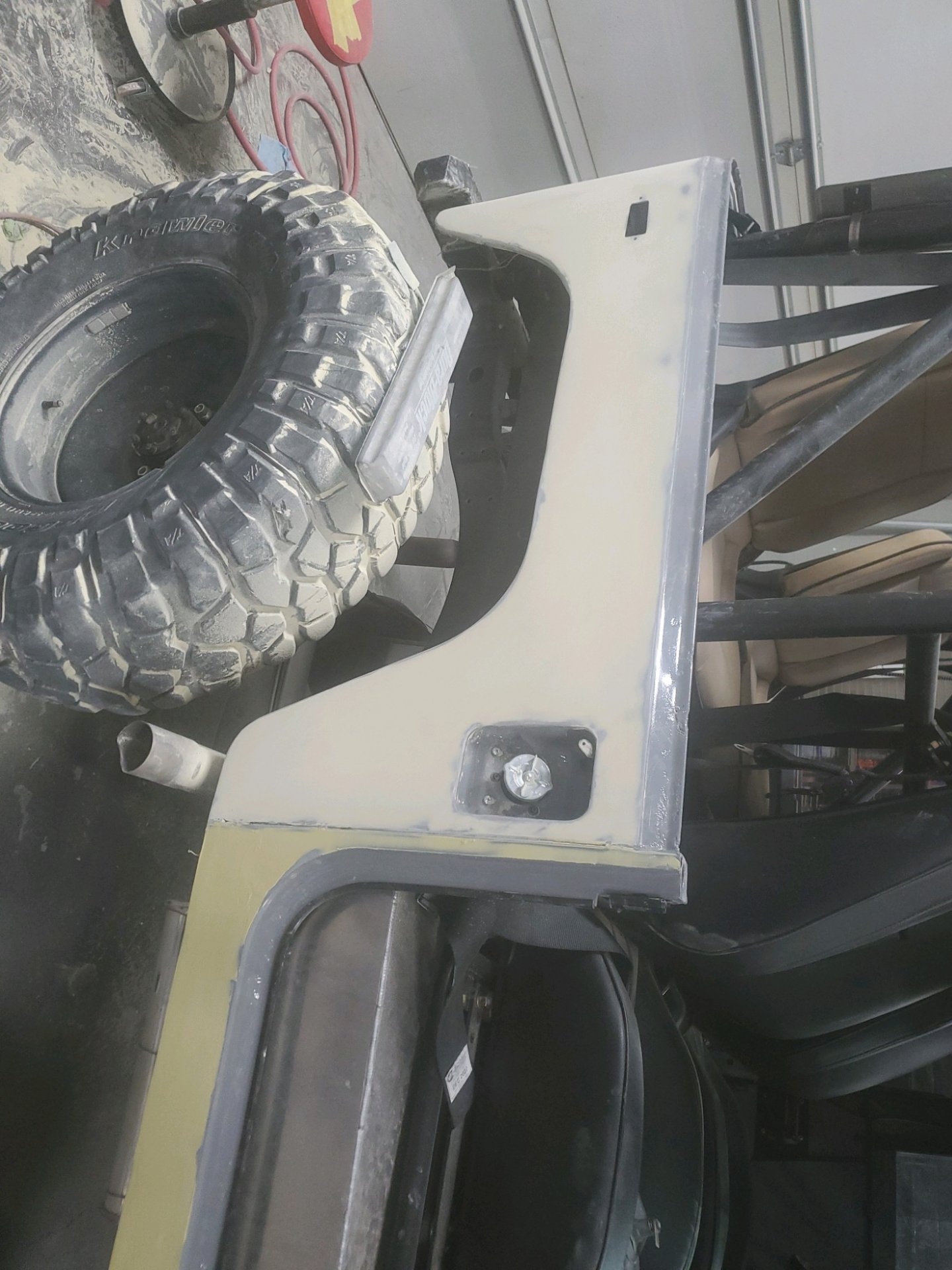

Rear wheel well move.
Taped out.
Moved up 2", and backwards 2".
Looking much better.
Driver Side moved.

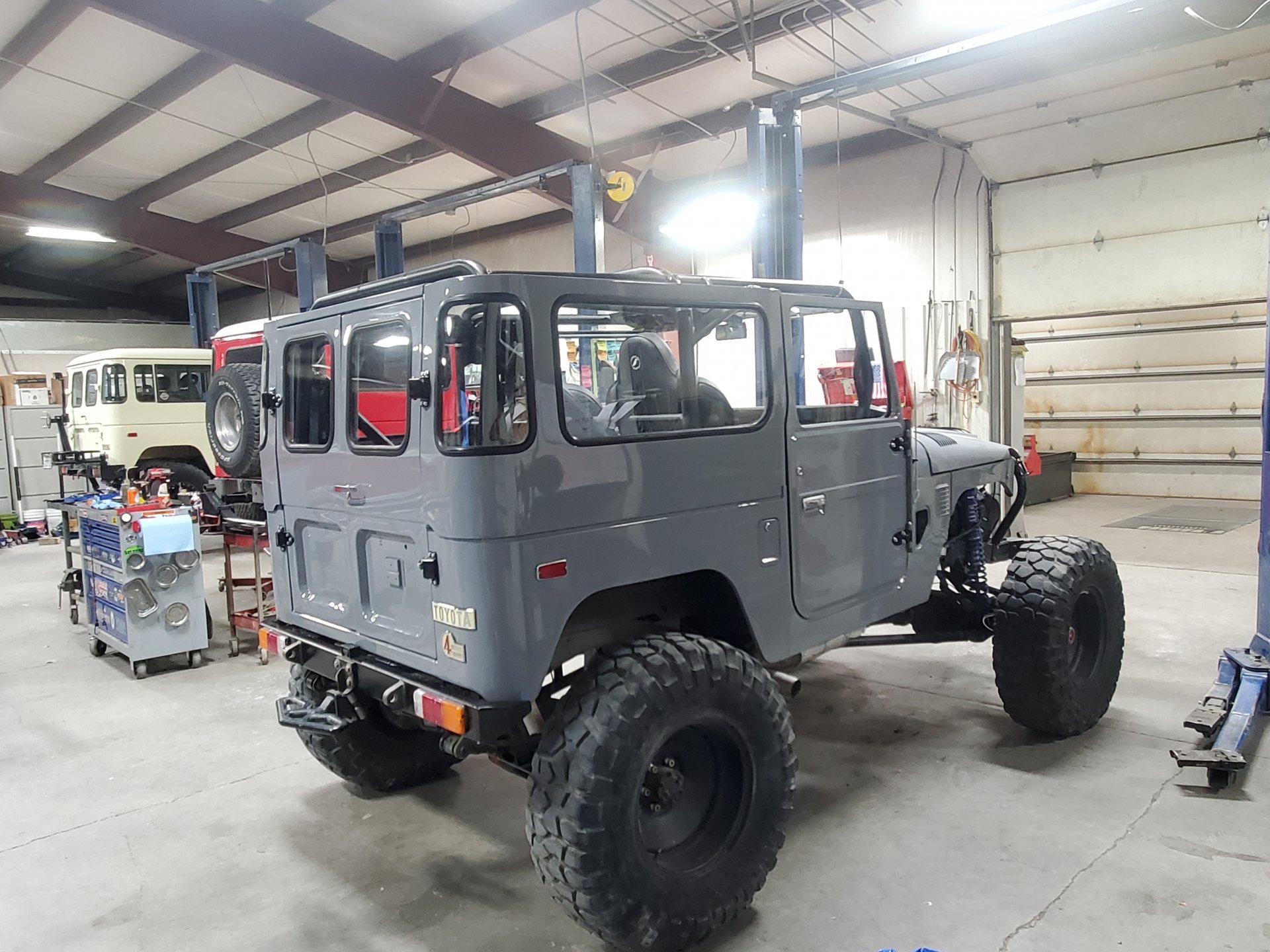

More paint, Cygnus White, this time.
Windshield, top, and bezel installed.

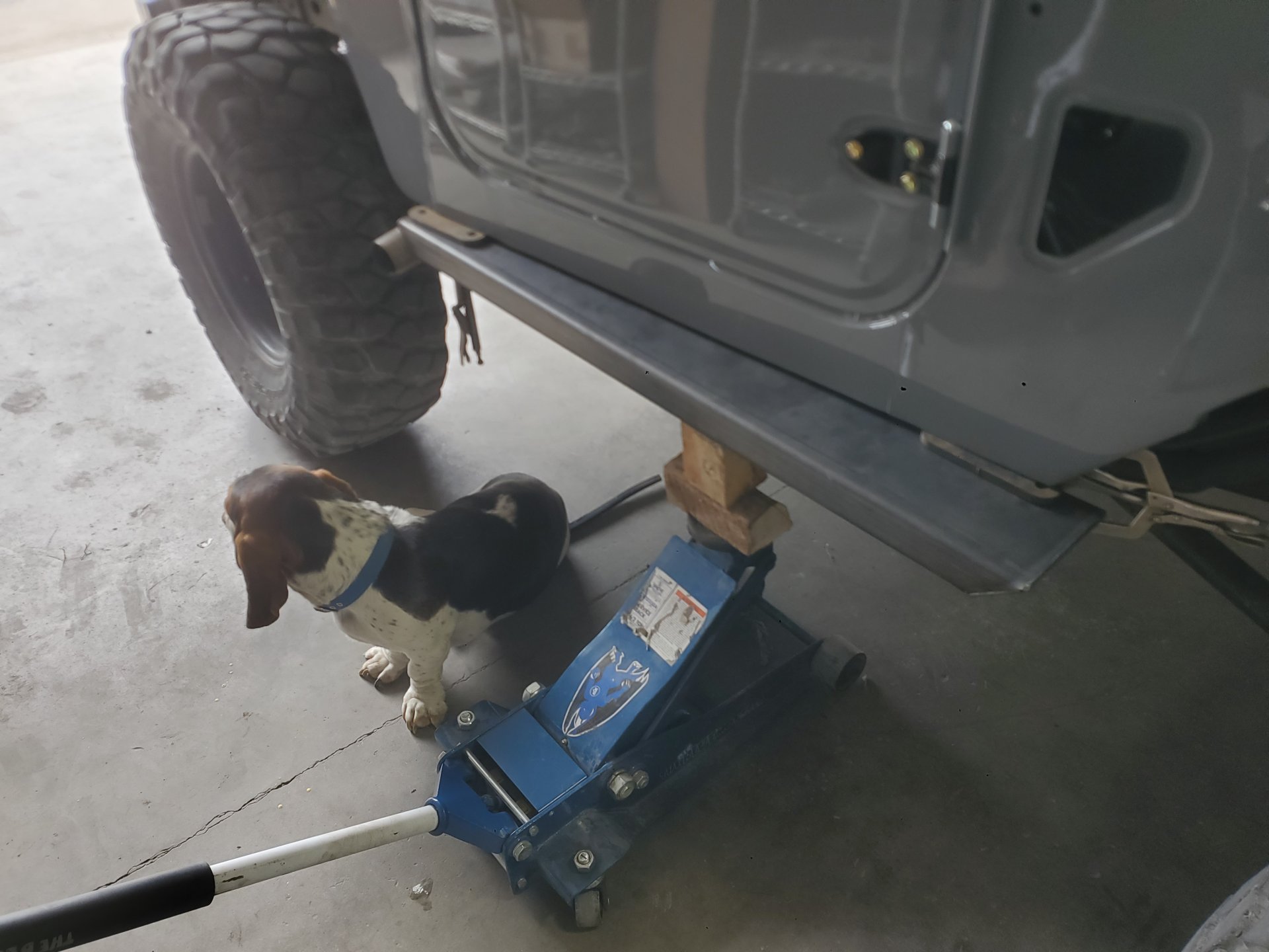

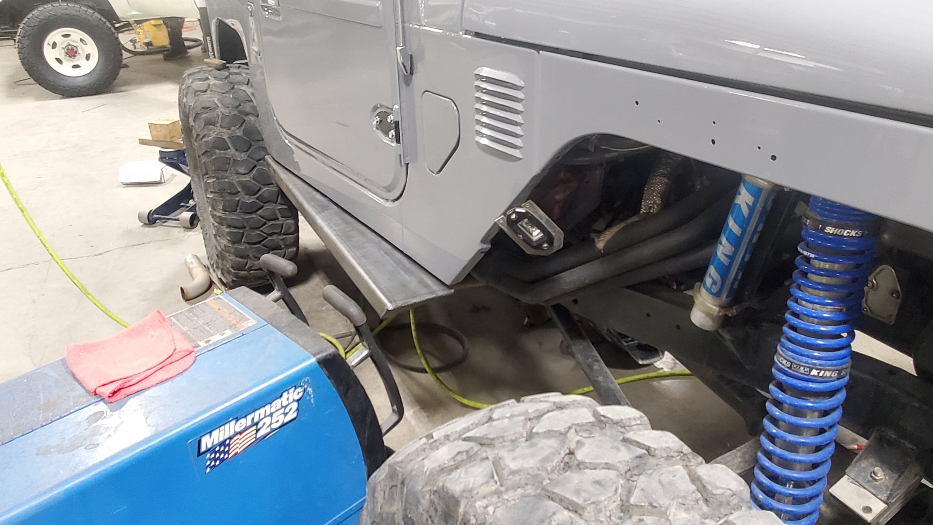

Alex was really kind and folded up some sliders for me. They are 3/16" plate, gusseted.
Truman, being the center of attention, as usual.
Mounting these was a massive PITA due to my exhaust, but I was able to get 3 non-bent cross members welded to the frame. Two are 1.5" x .120 wall DOM, and the other is a slightly notched, vertical standing 1/2" x 2" solid flat bar.

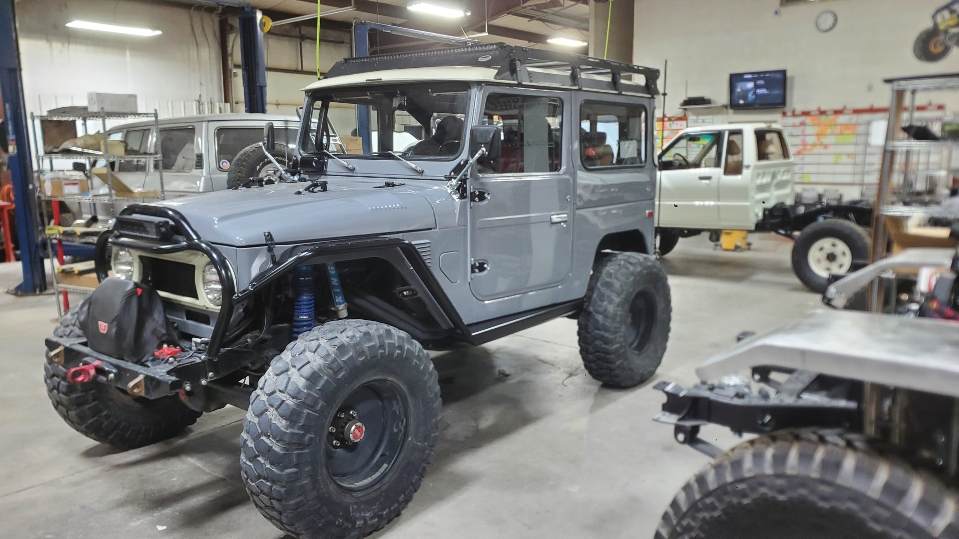

Tube fenders.
I got some pieces bent, but the lengths and angles were just a tad bit funky, so I had to shorten and notch it some.
These have tube clamps on both ends so everything is fully removable.
One side skinned.
I really like the way these look, but they are a bit heepish.
