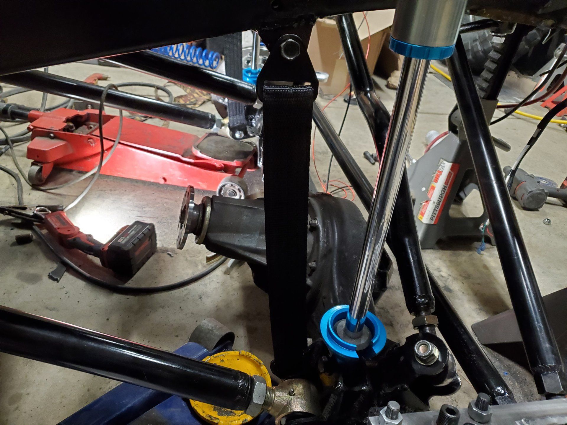

Limit straps installed. I still need to do bump stops, but I'll do that today.

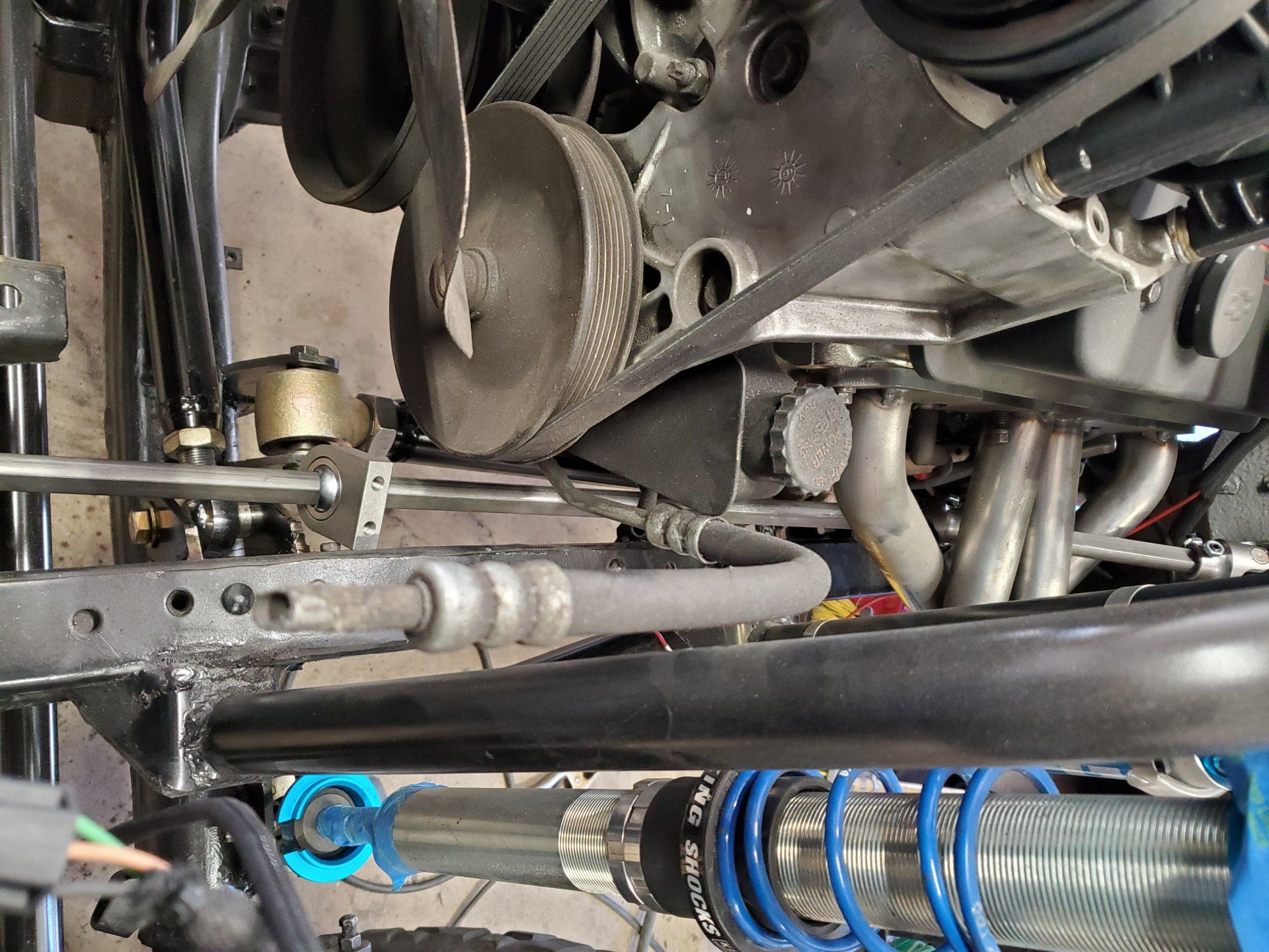

I also got my steering linkage built. It is fully removable from the column joint down so I can get my headers out.
The turning radius is pretty good for a Saginaw box, so I am happy.

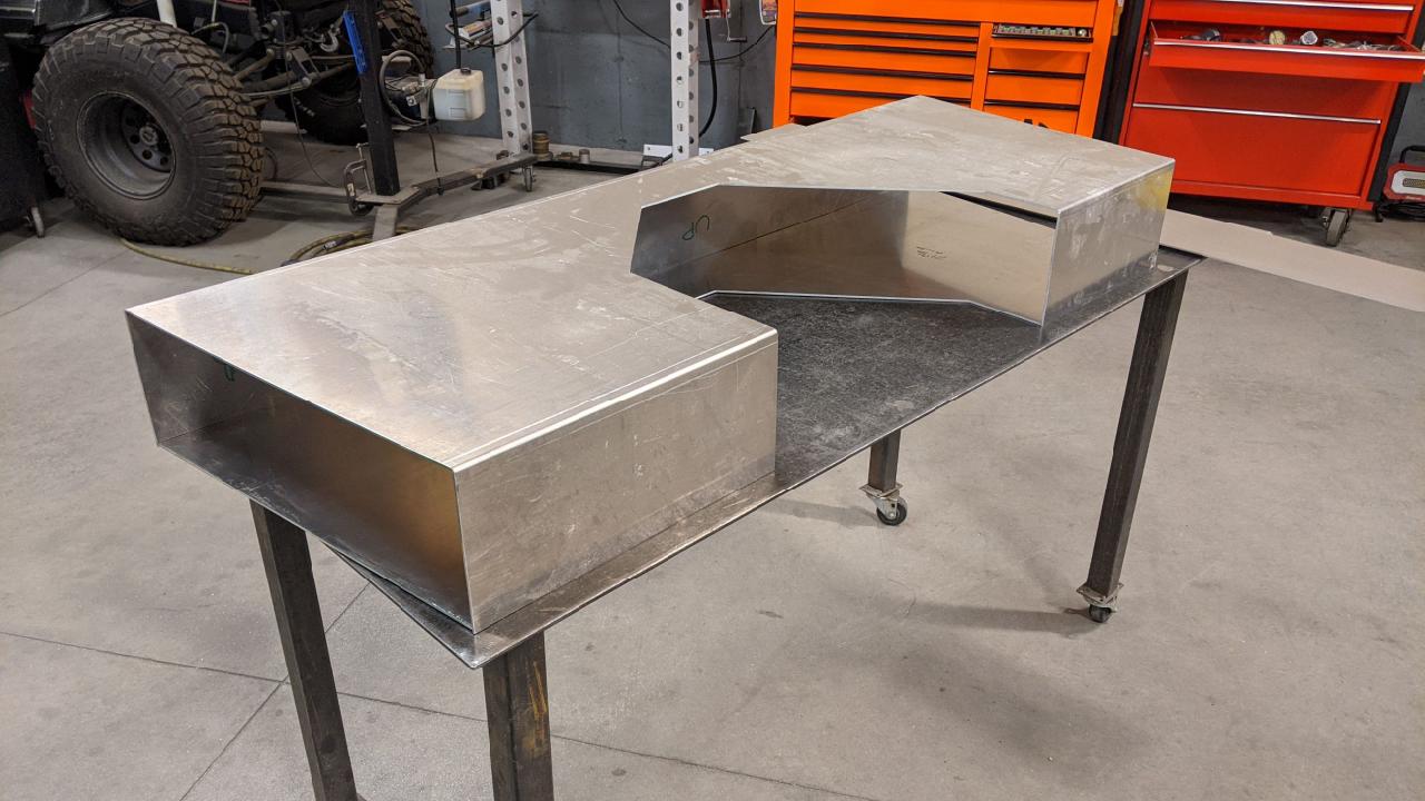

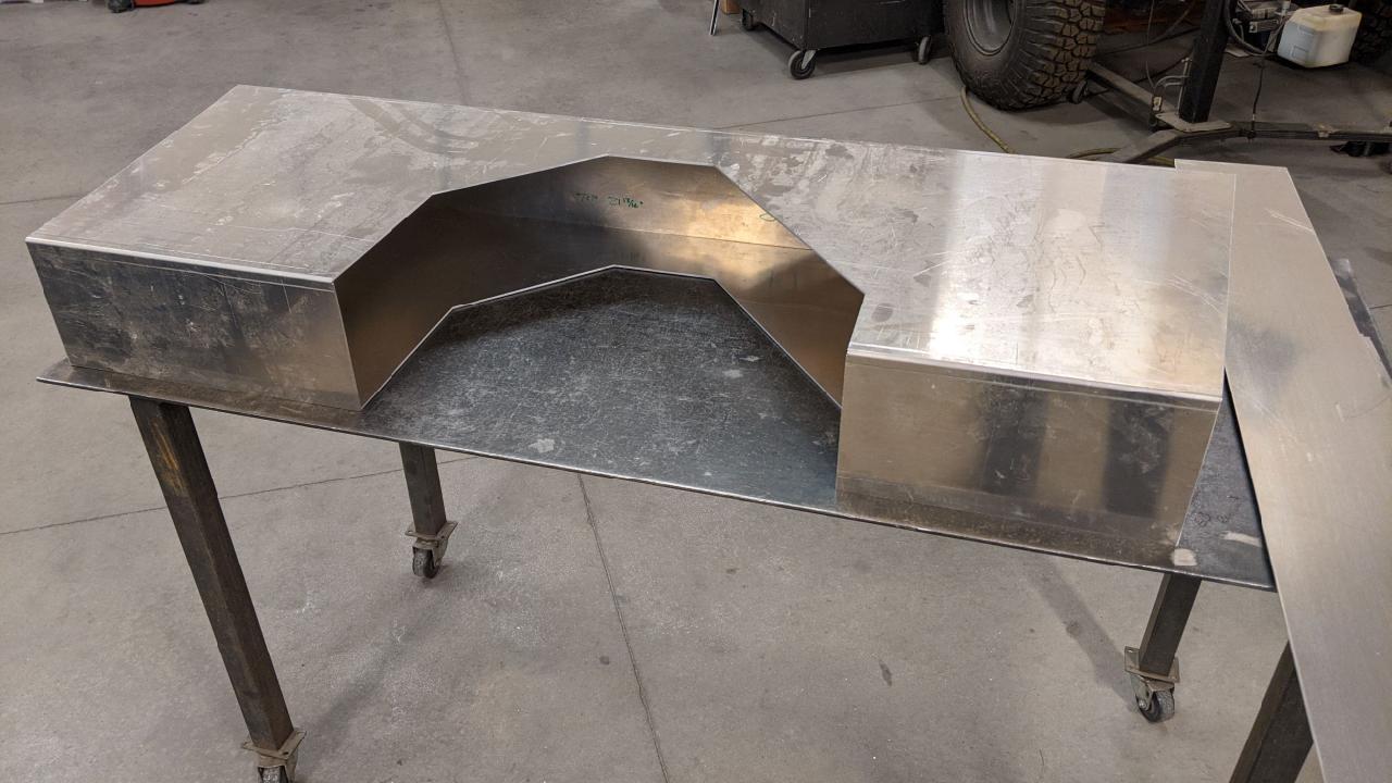

I then started working on my fuel tank.
More CAD
Testing with my seat frame.

A quick test fit of the fuel tank, now being welded up.

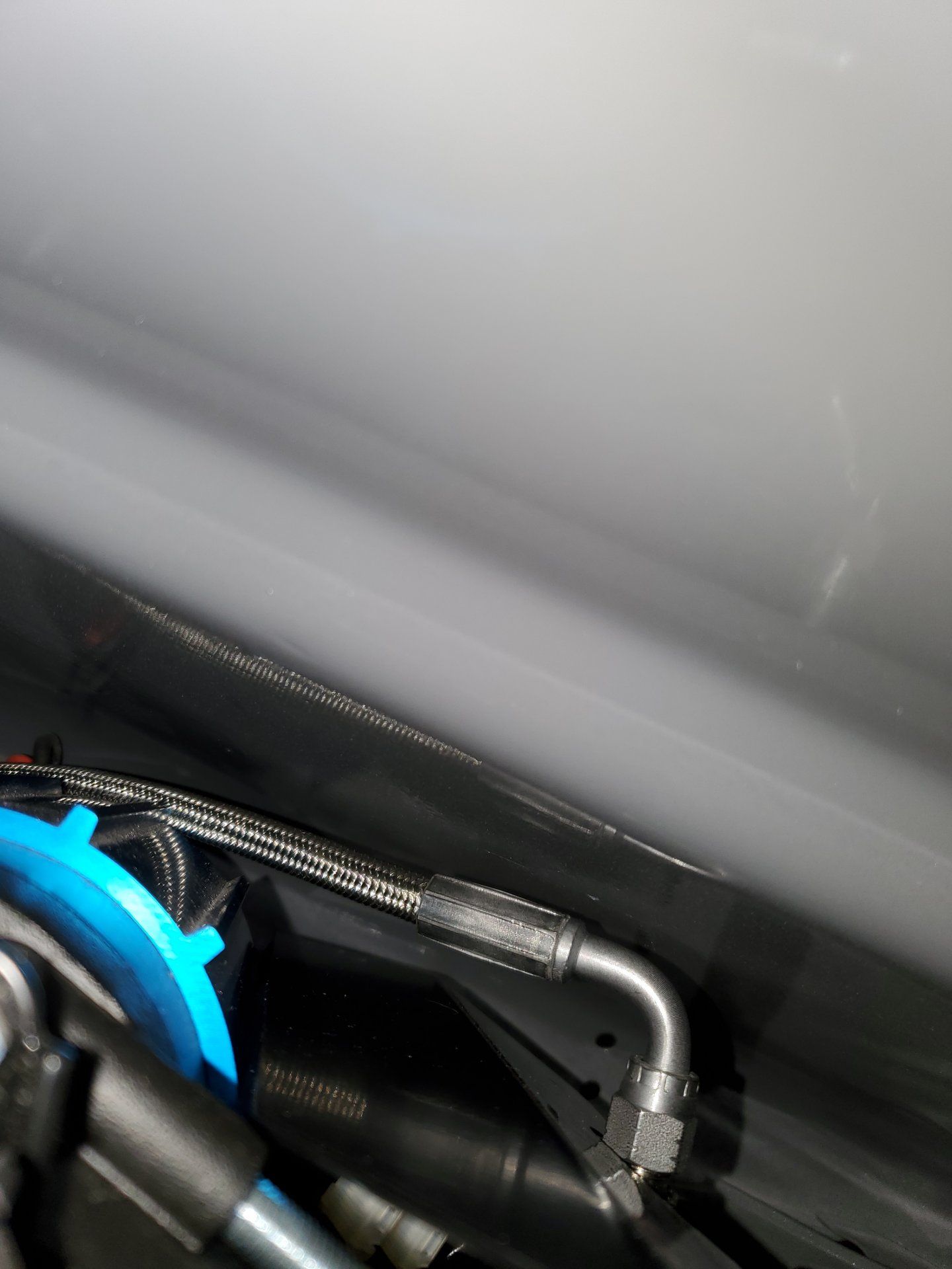

Power steering lines run. I like the heaver looking AN fittings and hydraulic hose, so that's what I had made.
