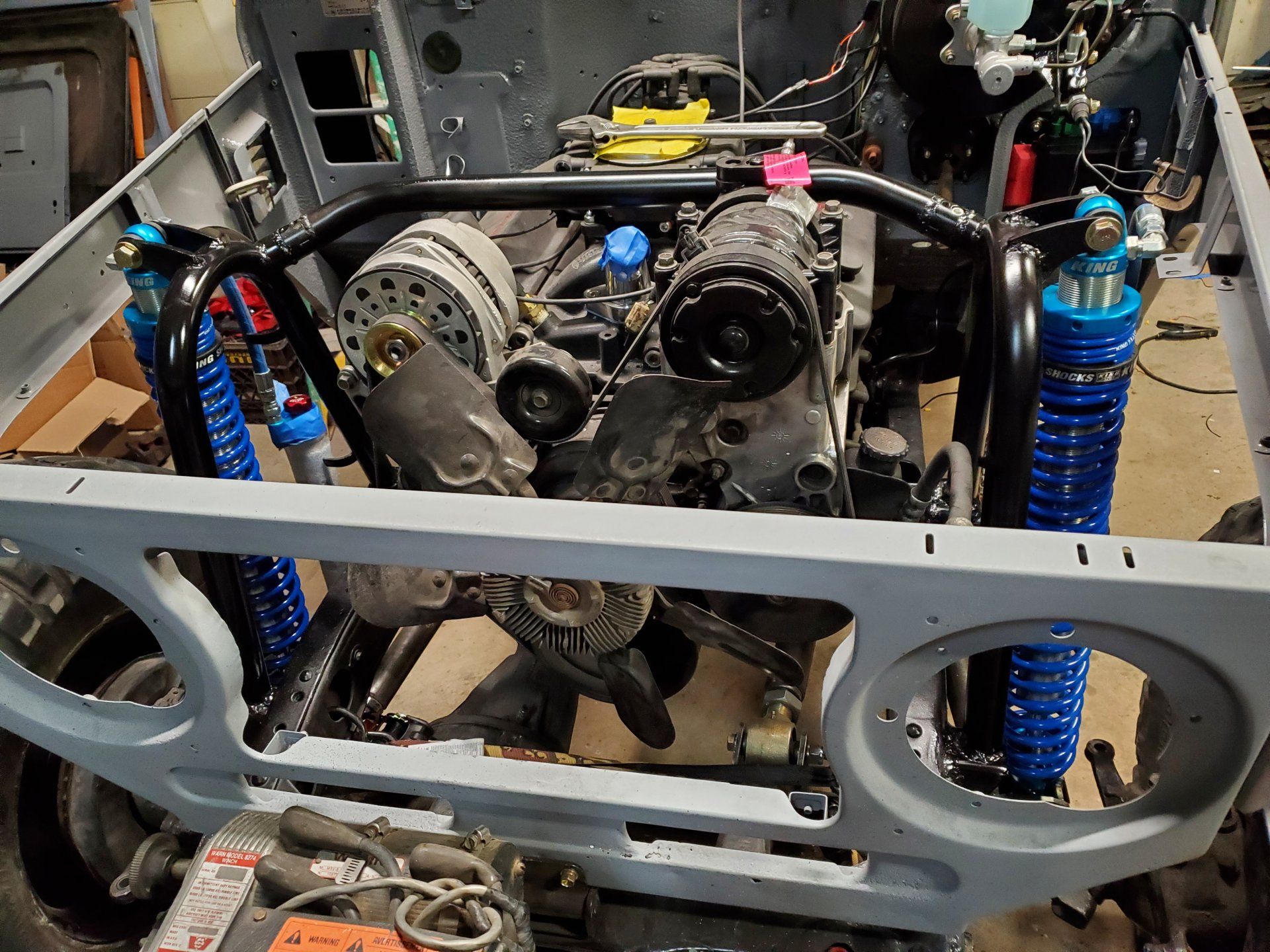

I decided to get my shock hoops all fully burned in today.
Burned in.
Hoops cleaned up and painted.
I'm really glad that nothing moved, and the crossmember fit perfectly after that much heat.

Installing coilovers with springs is difficult without a lift.
Link geometry looks great at full droop.
Sitting about an inch low on its own weight. It has been over a year since that tub was fully on four wheels.
The coilovers look nice with springs on.
Sitting at ride height. Ben @ Filthy Motorsports nailed the spring rates for this.

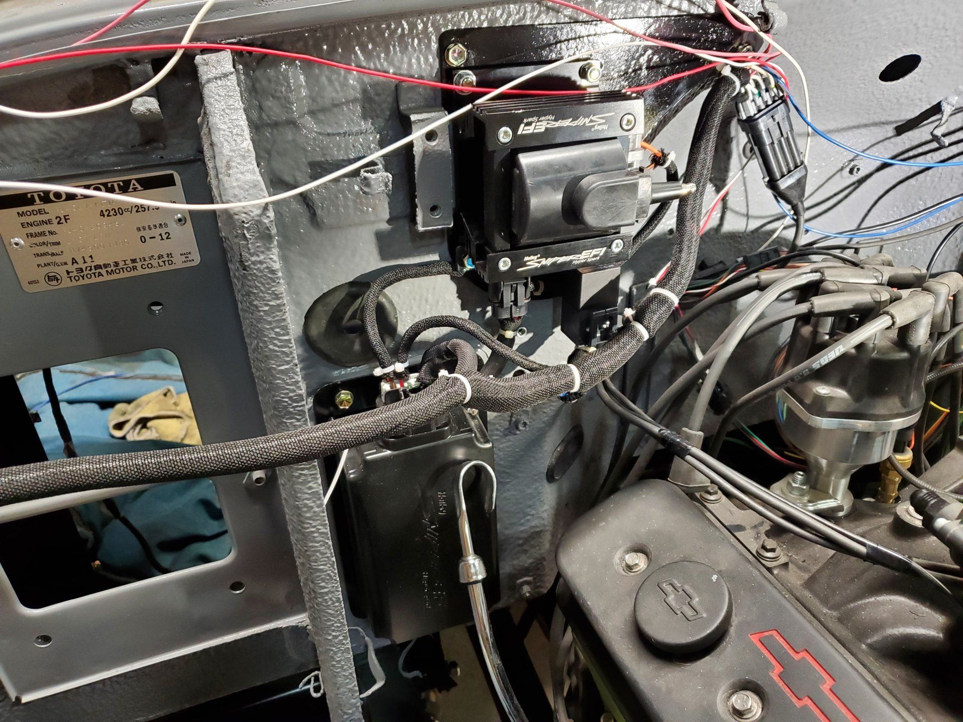

I then started working on sniper wiring.
Plate started for the coil driver.
Attached.
Computer mounted. Its closer to the exhaust than I would like it, but I'll build a heat shield for it. That combined with a ceramic coating on the headers should keep it pretty cool.
Sniper wiring mostly cleaned up.

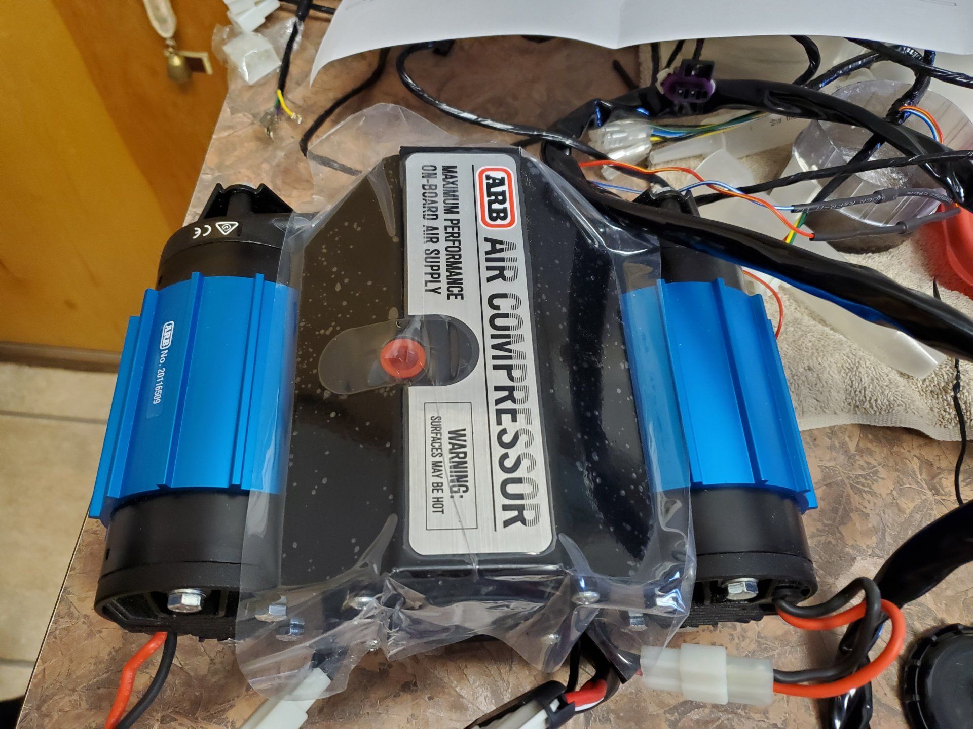

Air compressor finally showed up.

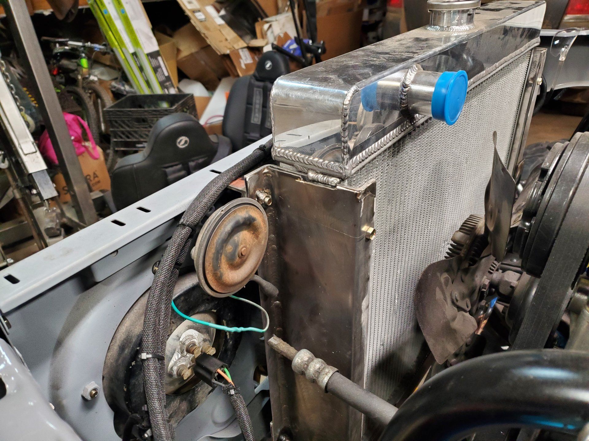

I put some 1400 degree paint in there so it looks a bit funny, but hopefully it wont burn off. I will be ceramic coating and wrapping eveything under there to help with heat, and I will probably end up stealing @GA Architect 's heat shielded floor mat idea as well.
They aren't pretty, but I'm not too worried.

Horns installed.

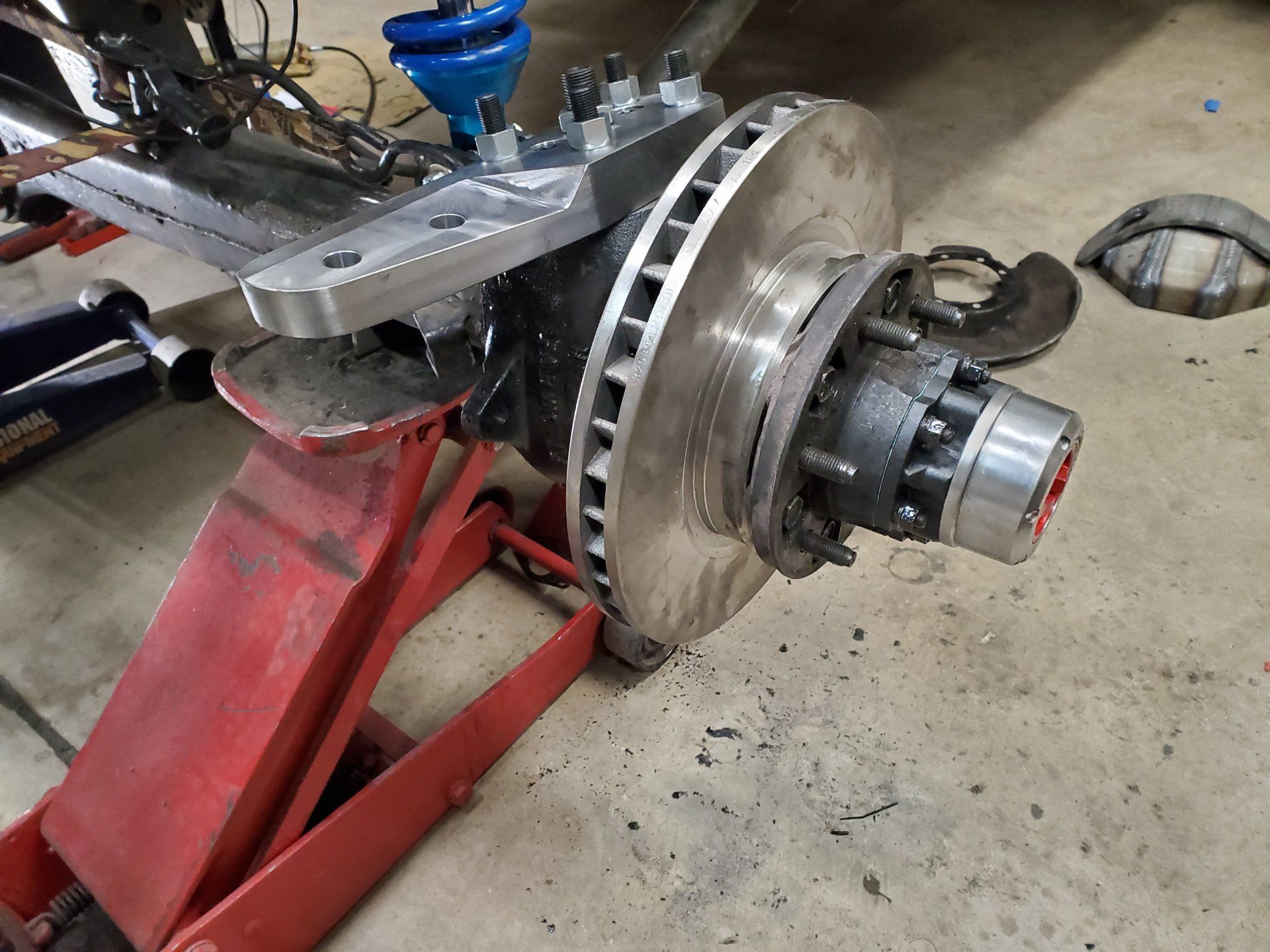

My Hellfire Knuckles showed up today, so the final piece to this puzzle is here, after about 8 months of waiting.
They are beefy as can be, so I'm happy.
Have I ever mentioned that ih8birfields? I'm extra glad that I didn't pack the knuckles with grease last time I stuck them on.
One side on with my fuseable link (the AVM hubs) installed.
Other side on.
I'm going to have my machinist drill out the original tapers, and I have some weld-in inserts that should allow me to flip my drag link and tie rod to the bottom of the arms, so no frame clearancing will be needed.

I got my steering arms drilled out today, there was no way I was trying to go though all 5 holes with my little press.
I wish I could have tig'd these, but mig will have to do.
The tie rod gets really close to my diff. Do I need more space than this? I really don't want to have to notch or bend the link if possible.
Turn radius looks great.
Full stuff clearance is pretty good, but I'm having a hell of a time trying to get my panhard packaged in.
