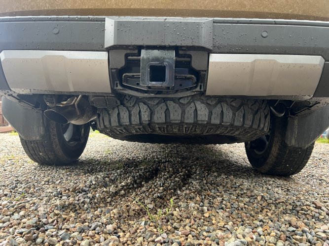

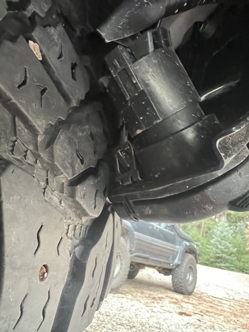

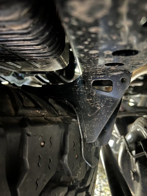

I’m going to say that a 34” tire does not fit. If you let some air out I’m sure it would. This is a worn 315/75r16 from my 80. Measured just over 34” with a level. It took a floor jack under it to get her in that far. The tire is not completely up to the frame in the rear but is contacting the forward spare tire brackets. I nearly lifted the whole truck off the ground in an attempt to raise it more. It’s also contacting the trailer wiring bracket. I’m going to say that 275/70r18 is the max spare tire without modification.

I was thinking that is going to be the deciding factor in what size tires I can go to without adding a swingout. You just proved it. I like to do a 5 tire rotation. At least they put the same nice alloy wheel on the spare instead of some cheap stamped steel unit.

There are reports out there of 285/70r18 fitting under the truck. I’m going to say it comes down to which tire manufacture you go with as that size is +/-34”. But yah I’m not going to exceed my OEM spare location’s size ceiling for tires either.
