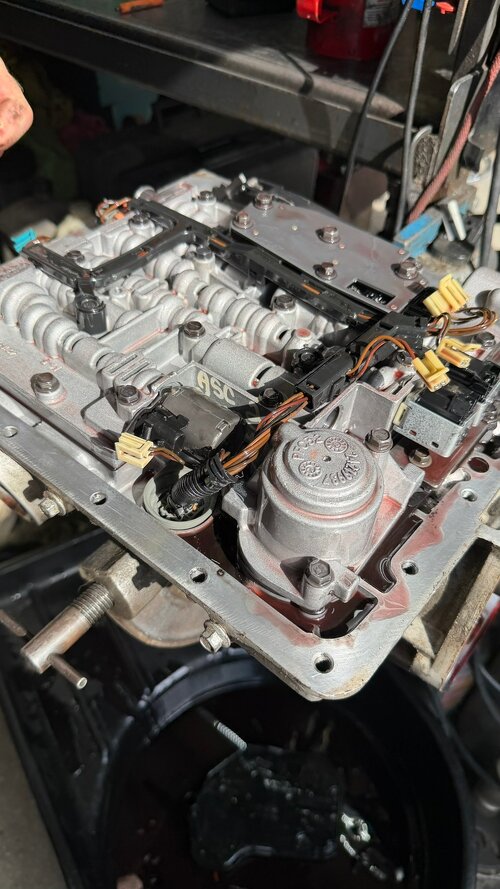

Plenty of opportunities to wrench. We have to disconnect the battery, remove the starter, disconnect the driveshaft, unbolt and separate some exhaust parts (easy bc stainless and v-band), disconnect linkages, unbolt and lower the transfer case (awkward), and finally unbolt and slide the transmission back and then lower it to the ground and roll it out on the jack. It’s actually not terrible and I know this because I had to do it another time or two definitely helps to have extra hands skill or semi skilled.

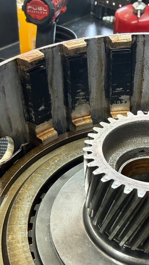

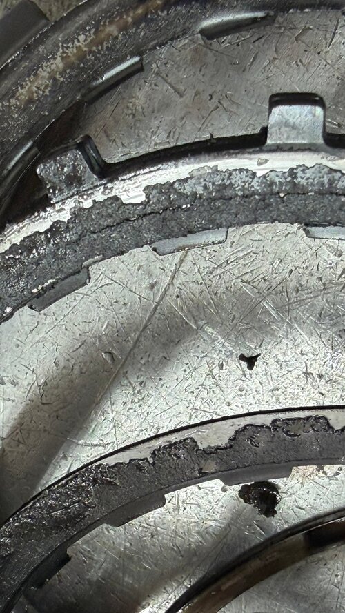

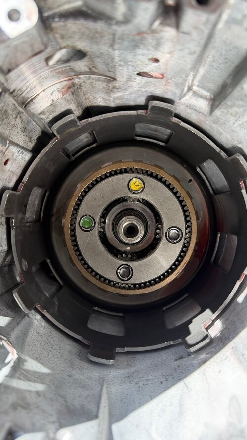

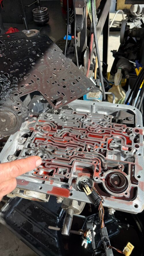

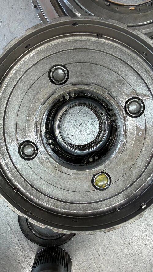

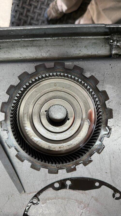

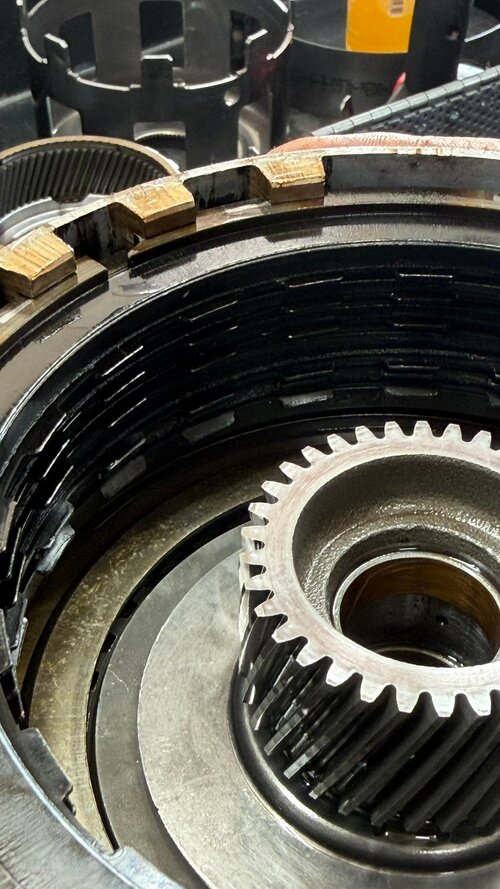

This is what is inside a 4L60. The reason I had 3rd & 4th gear is they fused together! The rest in surprisingly good shape. We will rebuild her!
