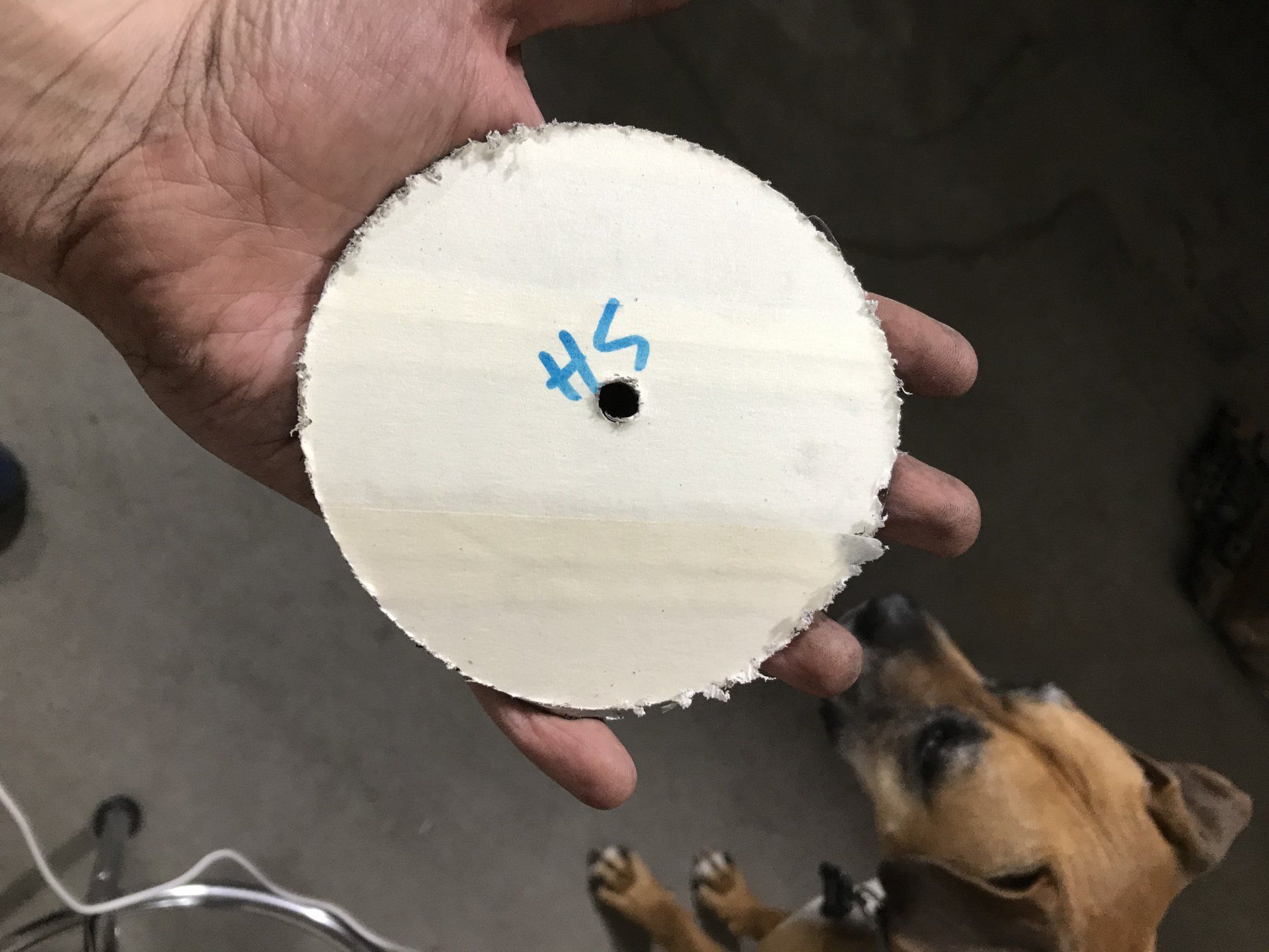

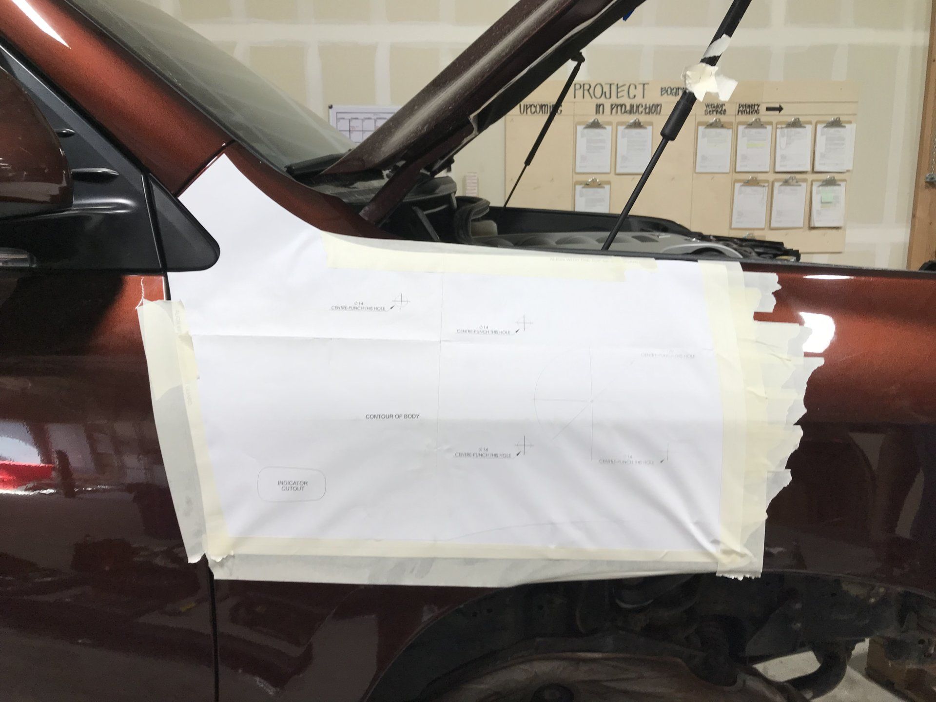

Cut a speed hole in my truck with a hole saw
468b926e-f3c4-473e-966d-7fd59bb469bd-jpeg.1960251
c786b983-5f11-4b65-8a96-0450c167cfba-jpeg.1960249
Whew... That would be a tough cut. Ha ha measure about 3 times, and stop to measure again and then cut once!
