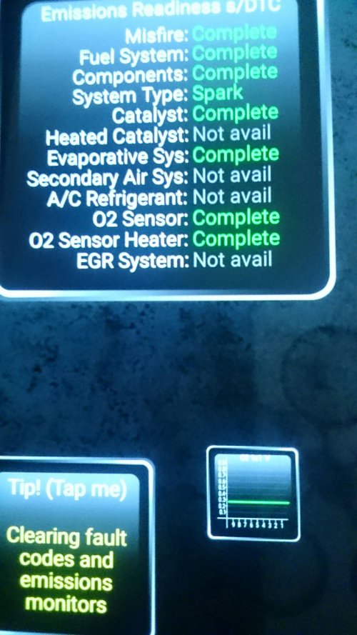

He just took it into the shop and made me wait in the hallway. I looked through the little window here n their and I think he was following some of my harness but I couldn't see much and didn't want to look creepy. 20 minutes later he came out and gave me the certificate and said "nice job on the conversion." I have a pressure sensor and a gm sender in the tank. It's a 2002 5.3 L59 from a suburban but flashed with a 03 Silverado vin. So the numbers need to comply with a 2003 Silverado. I'll try n get the sheet later for my testing numbers. I'm drive by cable and using a dakota digital cruise setup and retrofit to work with the original Toyota cruise stalk. I guess I'm glad I didn't use a Corvette vin. My Nox was kinda close, I'm using high flow cats, so I'm guessing they don't clean up the NOx too much. I think my NOx limit was 6.5 and I got 6.1. He told me they aren't as picky with the evap system. I installed the gm sender last week for evap, and I'm not sure if it passed readiness. I was told it didn't need to. But I kind of want it working since I've come this far. All the other monitors were passed last I checked a few days ago besides evap. Now that I got tags, I'm not in as much of a rush to double check the evap, but I do plan to do so.

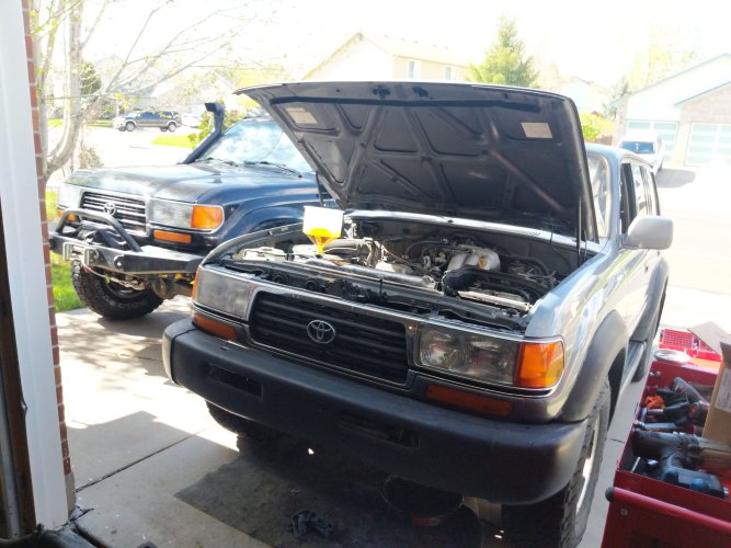

Replaced the leaking csf radiator in the new 80 I got from @BugEater
Went with an oem one, the coolant was already green so I just drained everything possible and filled with new 50/50. Then I went and cleaned the engine to try and pinpoint the oil leaks. I'm hoping it's not the timing cover.
I'm amazed at how well the engine runs with 365k. I'm thinking it had a head gasket because it looks to be MLS. Didn't these trucks come with a fiber gasket from the factory??
I need a new y pipe too. I'm going to weld the crack and pray it passes emissions.

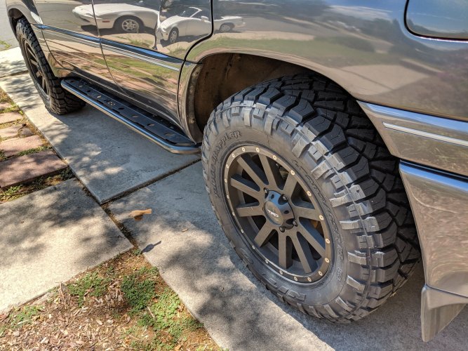

New tire day! Thanks MTSN for the recommendation on Nitto Ridge Grapplers. I went 5% bigger on the sidewall to 285/65/18 from 285/60/18 Nitto Trail Grapplers. Chunky!

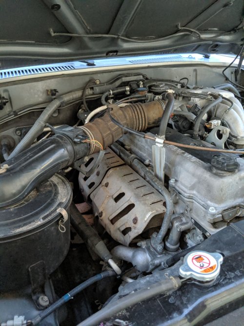

Replaced my starter and intake manifold gaskets on Saturday. Took about six hours, but considering that this was the first semi-major repair I've ever done on my own, I thought that was pretty reasonable. :D
Before (yes, I covered the intakes before doing any further work ;) ):
After:
