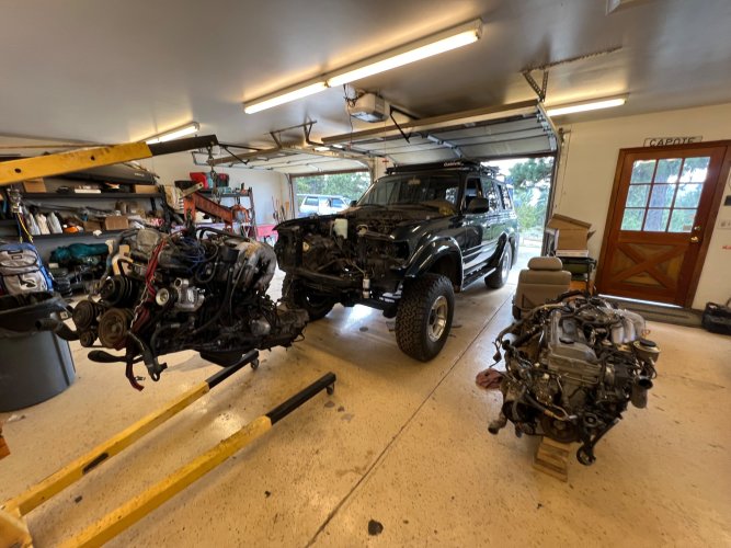

Engine went in yesterday as well as a bunch of suspension work thanks Tim, Matt, and Bruce!!! IMG_5169.jpeg

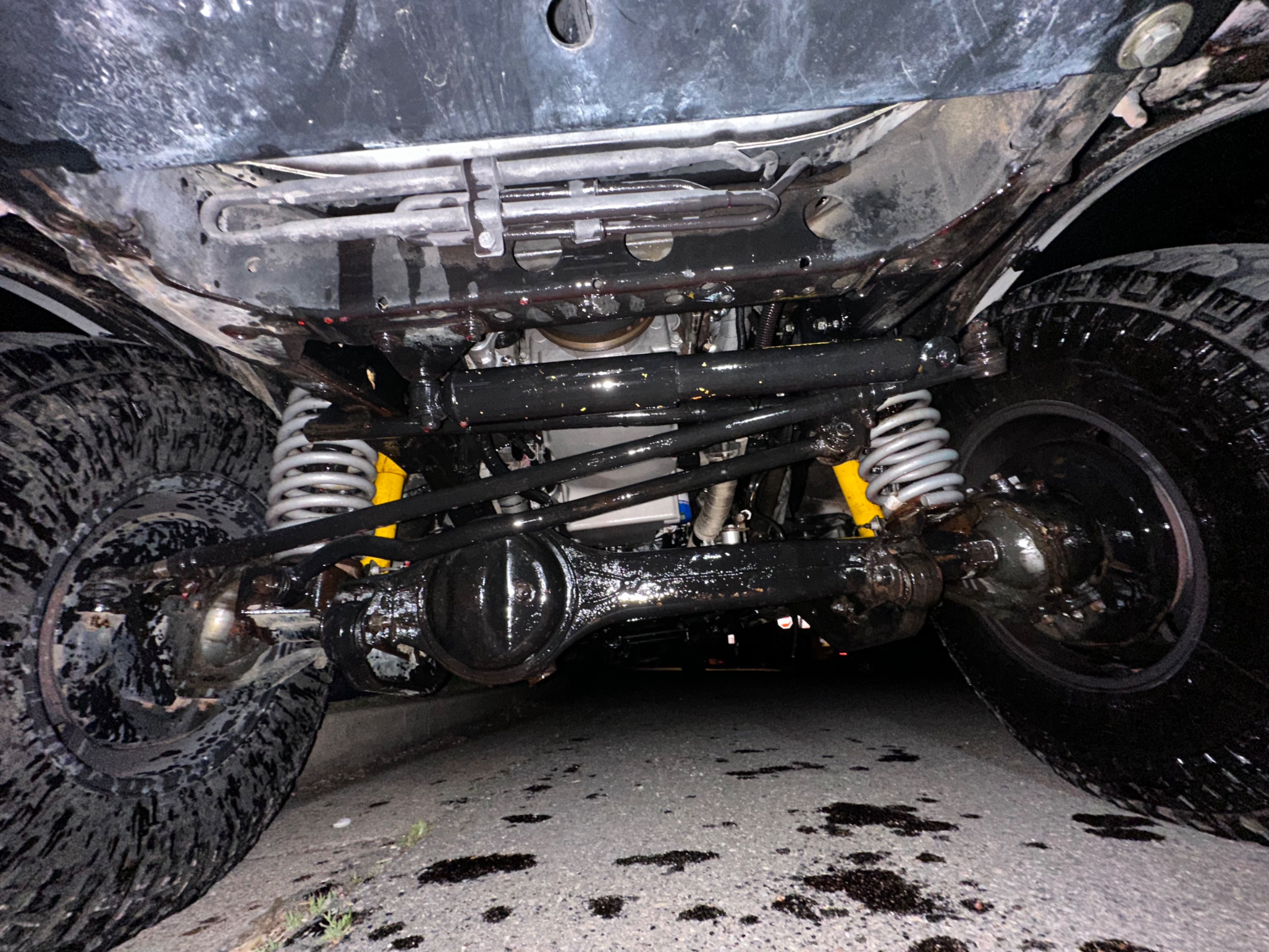

I broke LongCruiser … again.
Barely made it home.
Hope the transmission is not damaged.
I hope it’s a cooler line that blew.
Second best is that it’s the radiator transmission tank. I could even bypass that temporarily.
Arghhhhhhh
I’d need a miracle tomorrow to still be able to run it out to Moab Thursday. And if I don’t move it by Thursday I’ll surely get two tickets - street sweeping and expired registration.

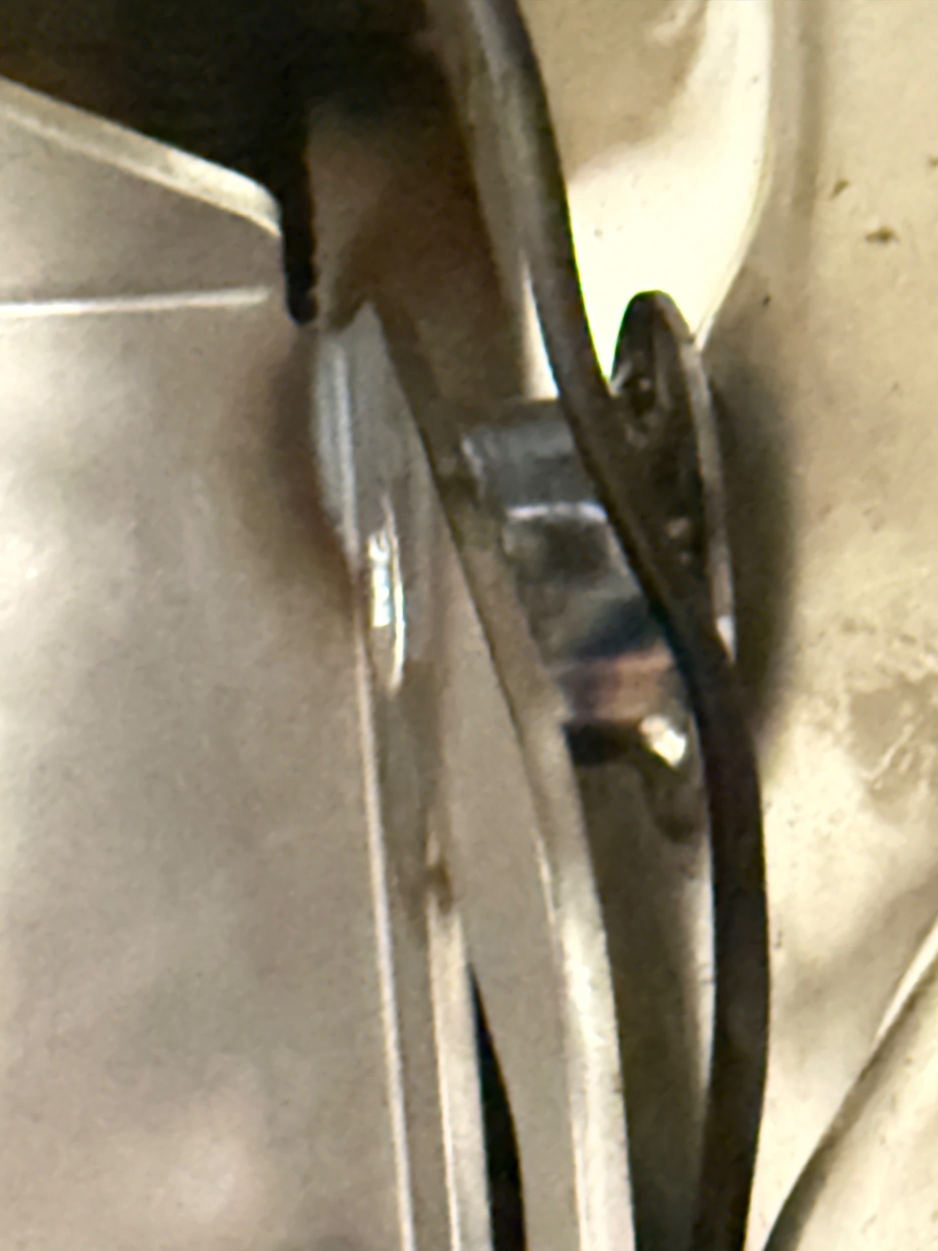

4,230
One battery box done. The next will happen after Cruise Moab.
Looking forward to seeing your solution as I’ve wanted to replace my OEM box for a long time.

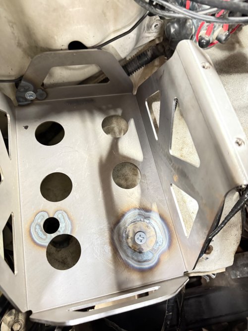

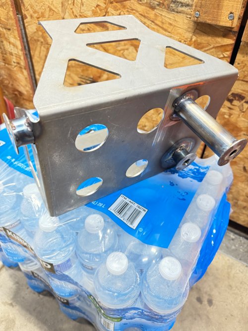

Here is the solution @MoFunna4l2unna came up with for the passenger side battery box. We will mirror it for the driver side, after Cruise Moab.
He used the factory mounting holes. The discolored smaller hole is the long leg and we used your typical Toyota m8 bolt for that. Since the box is very tight on the battery we counter sunk the two Phillips head screws. It’s solid!
Going to paint it and finish the wiring up tomorrow.
