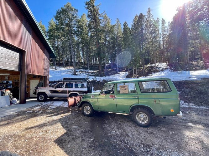

First Sunny and 50 degree day in the mountains so started pulling my camping gear together and servicing the 60 for CM2025!

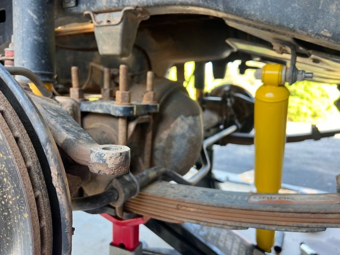

What’s wrong with this picture.
That little bolt looks out of place. Can’t think of where it should go though.
60wag
2,673
I keep some spare bolts in my truck but that is a storage location I hadn't thought of.

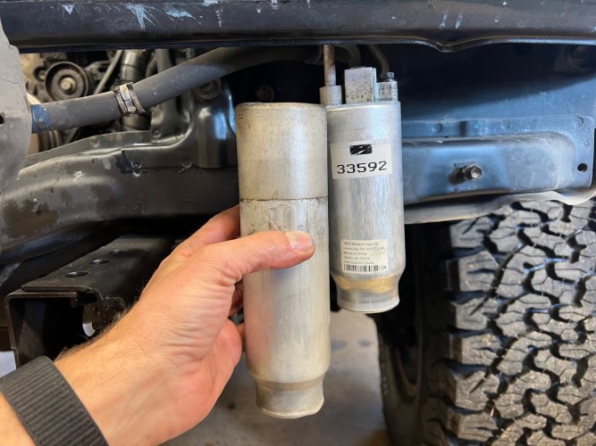

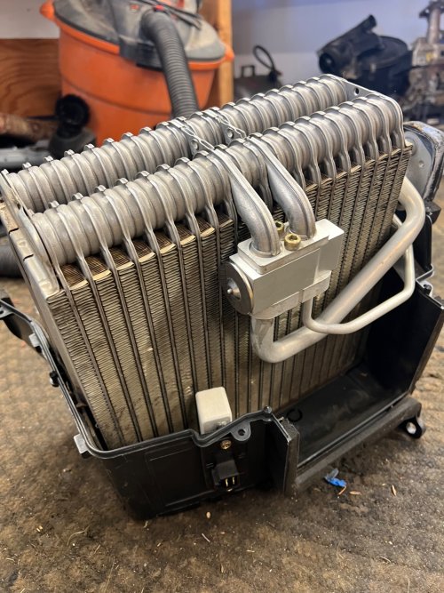

New expansion valve cleaned evaporator and drier/filter since ac system was opened.

I'm going to have to do this to mine whenever i decide i want to get the AC going again... its all been open to tons of trail dust for the last 4-1/2 years of so.

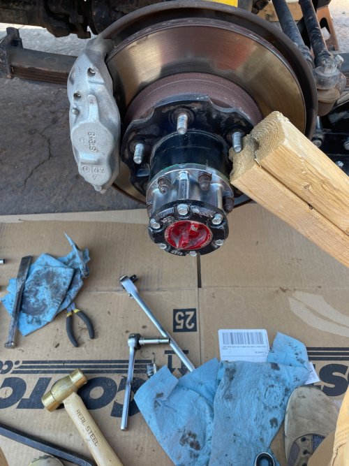

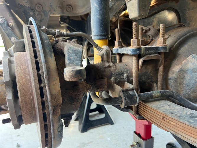

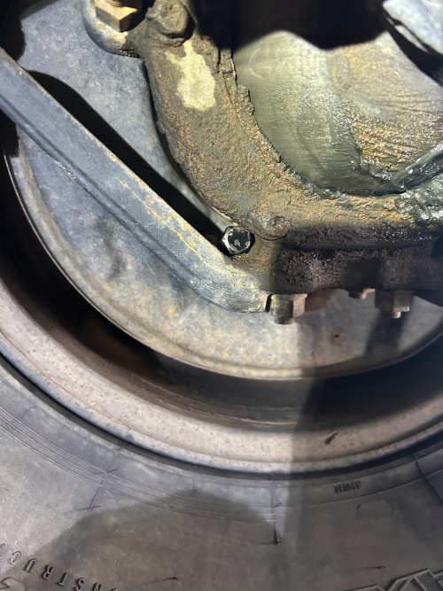

Getting ready for CM25, found a bit of play in front passenger so went in and readjusted wheel bearing. Clearly, my newish seal and rebuild has failed on this side. Goop soup. I ain't doing that until later.
Also, shock tower mount bolt was coming loose... that must be a 23 mm.
Drain and replace on trans and TC coming up.
Clutch master and slave...
Don't want to break down on the 40s run😉🥳

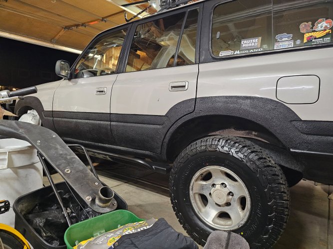

Got my rig in at Stevinson to have the front main seal and the oil pump gasket replaced before CM25. I feel like i could have done this in my garage if we added just a few more hours to each day.
Also did some touch up painting to the lower part of the body where the PO spit some rhino liner, apparently blindfolded. Driver's side done, will get the passenger side taken care of when the rig comes home.

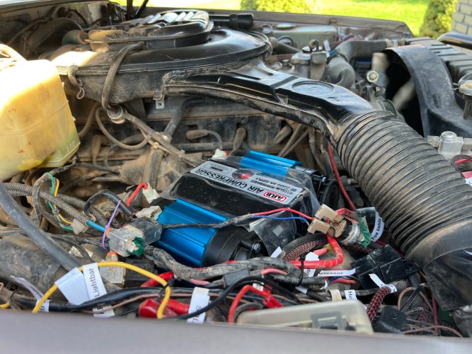

Lots of work done to my 80 this weekend. @AimCOTaco came over Friday and we prewired the dual battery set up. Got the idle adjusted a little higher on the LS. Spent Saturday moving wiring around for when @MoFunna4l2unna and I get the ruffstuff batter box mounted up Wednesday. Before that though, Tuesday after noon is dyno/tune day for the LS. Any guess to HP numbers? 5.3 truck motor. Stock other than a cam.

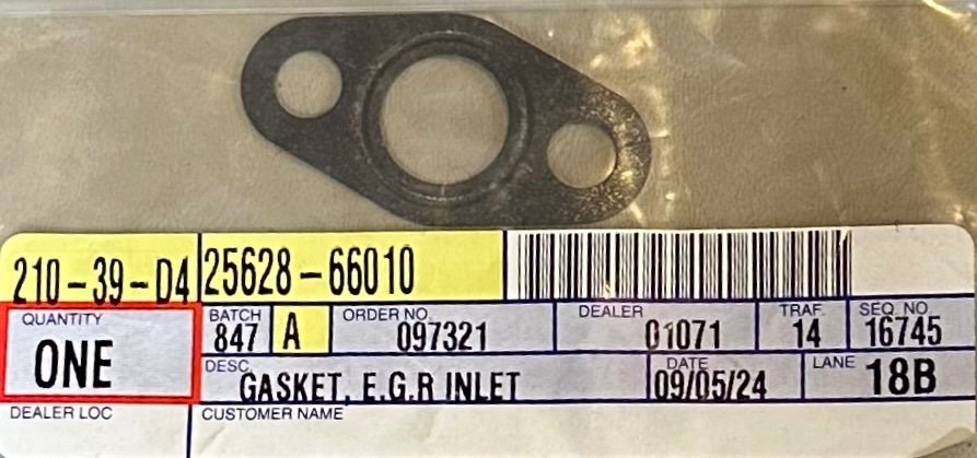

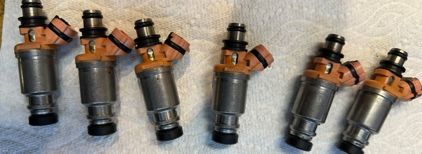

Swapped in a cleaned set of injectors. while there found my EGR pipe to head connection was loose and leaking exhaust. Took care of that too. Very tricky spot to get at. You can see it in this picture. It is BEHIND the pesky heater hose!
