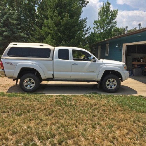

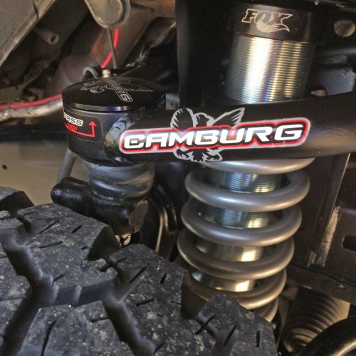

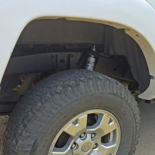

What a joy working in a stuffy garage for a couple of days in late July.
Front: Fox 2.5 IFP, Camburg Balljoint UCA
Rear: OME Dakar CS047R, Fox IFP 2.0
Alignment Monday.

BFG AT KO2 235/85R16
Oh sure, you upgrade to a V6, 6 forward gears, cruise-friggin-control, coil springs.
But pizza cutters foreva.
The stock TRD rims are maybe a little wide and definitely have too much backspace, the tires sit a little bit too far inside the wheel wells. Thinking maybe 1st gen wheels or perhaps steelies or spares. I'll have to think about this. But I think nice clearance all around, no trimming, no rubbing and I can leave on the mud flaps.

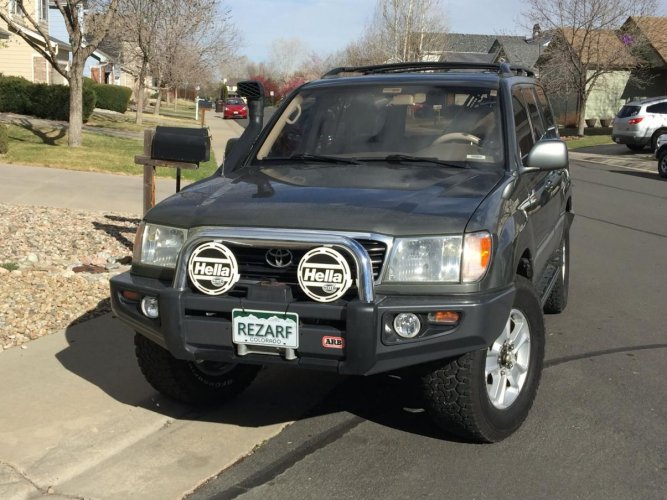

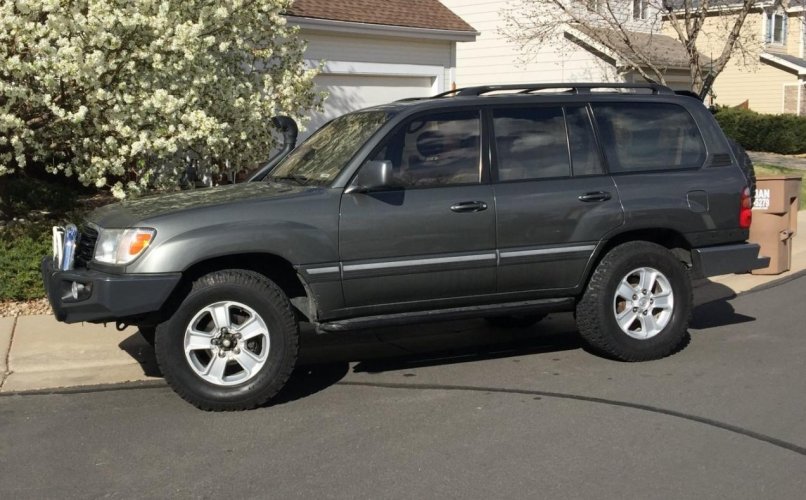

Cool Drew! Looks great. Bring it by the next time you're in Ames!
I spy photoshoped license plate. ��
8,739
in da house
looks good and updated with those wheels drew!

Thanks guys! It made a big difference in updating the look of the wheels. They are 2017 Tundra wheels but have been around for a while. The BFG AT's I scored for a song so I jumped on them and popped them on the new wheels. I bet they are 30# lighter per corner than the steelies they relpaced with the Toyo Open Country MT's I had on there. :thumb:

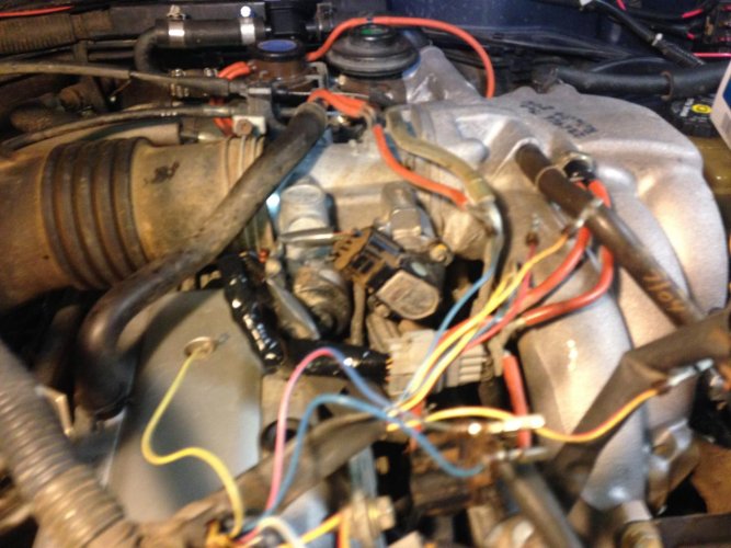

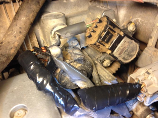

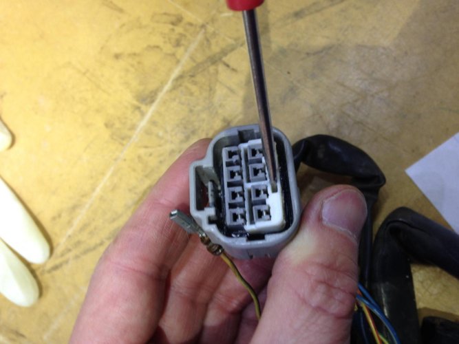

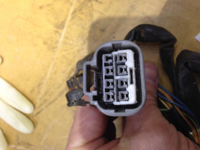

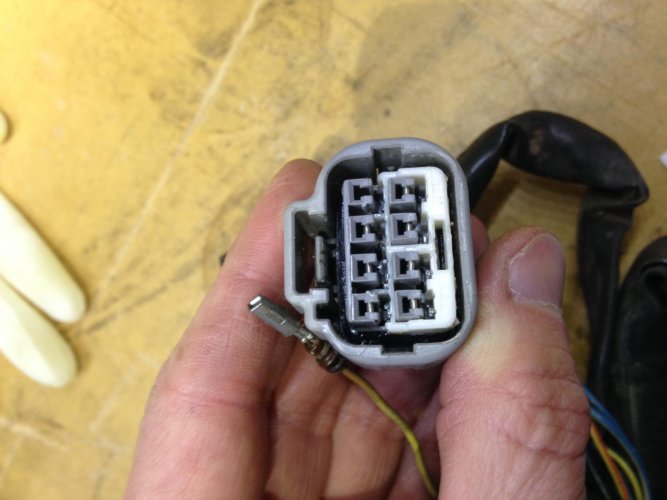

I replaced two connectors at the intake manifold, by the TPS. The tabs that lock the connectors in place had broken off. One s long time ago and the other last week. I asked Bill Van Beek where he sources connectors and he said he cannibalizes old harnesses. I had another engine harness from my rebuild 4 years ago, so there I went.
Once you figure out how to release the pins, its fairly straightforward. For the connector picture below, the white part is a lock. You pop that back with a flat blade screwdriver, then use a micro - think eyeglass sized - screwdriver to release each pin. I did them one at a time to not mix them up.
The two connectors are the ones with the fresh electrical tape on the wire loom I cut back for accesss :thumb:
