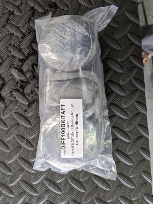

New steering rack bushings 🤘
I'd been putting these off because of the horror stories I'd seen on mud. Two hours round trip on this job, taking my time and including cleanup. :dunno:
If anyone is worried about doing them, definitely don't be. The white line kit is choice. Also a foot of all thread and some nuts and washers and it was a piece of cake.

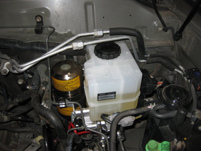

Replaced the brake MC assembly on my '99 LX 470. Did not require dashboard disassembly (which was indicated by the FSM and Timmy the Toolman), and went quite smoothly, except for the $1325 price ($35 over dealer cost) + $108 in sales tax and $15 in brake fluid.
My old one failed without warning at 310,042 miles and from some testing I did, the motor would not spin or conduct electricity. I will tear down the old motor and see if the brushes are long gone, and/or try to determine what failed.
When it failed, I got the dash alarm horn, the brake and ABS lights, and about 15 brake applications until the pedal hit the floor. But, with 3x pumps and some leg pressure, the truck stopped well, so I just drove it home and parked it. You don't totally lose all brakes, but if you've never driven a car with a bad master cylinder that required pumping the brakes, it would be unnerving.
Yeah I've 3 times had an issue with mine. All 3 times in single digits after just starting the truck. I think I've narrowed it down to the check valve just freezing open or closed but might not know for sure again if it doesn't get that cold again this winter. Basically first pedal is hard as a rock, pump it a few times and it works fine. Someone suggest spraying some silicon spray into the check valve. If we get another cold spell I'll have to do that

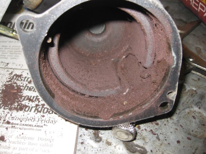

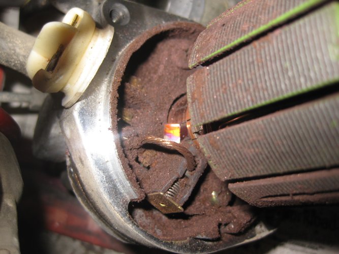

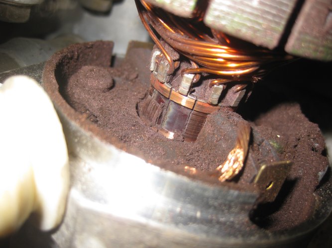

Today, I took apart the '99 LX 470 Brake Master Cylinder motor. Brushed are gone, commutator destroyed. This explains the 'no warning' loss of brake assist. Note the commutator 'plate' in the 2nd photo, sitting to the left (and turned 90 degrees) from where it should be.

gungriffin
Dec 4, 2017
1,138
2001LC on Mud seems to think that a lot of these failures are due to not pumping the brakes 25 times before topping up the brake fluid reservoir. Failure to do this causes people (often dealer techs) to overfill their reservoirs. The results in the fluid spilling out of the reservoir. He explained to me that the fluid is hygroscopic. This is a fancy term for absorbing moisture from the surrounding air. The moisture against the parts then leads to rust, contaminants and eventual failure of the motor.
9,703
looks like the brushes wore out and got sucked into the commutator after falling out of their holders ripping off the remanider of the worn out conducting pads.
