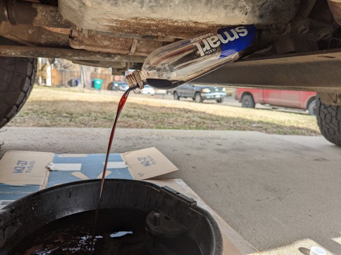

On another note, I swapped out my trans fluid today. I was able to formulate a fancy funnel to swap my ATF fluid without having to drop my transmission pan!
