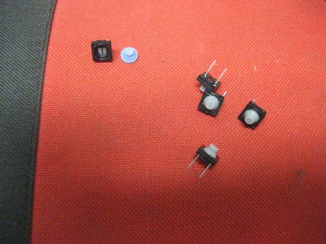

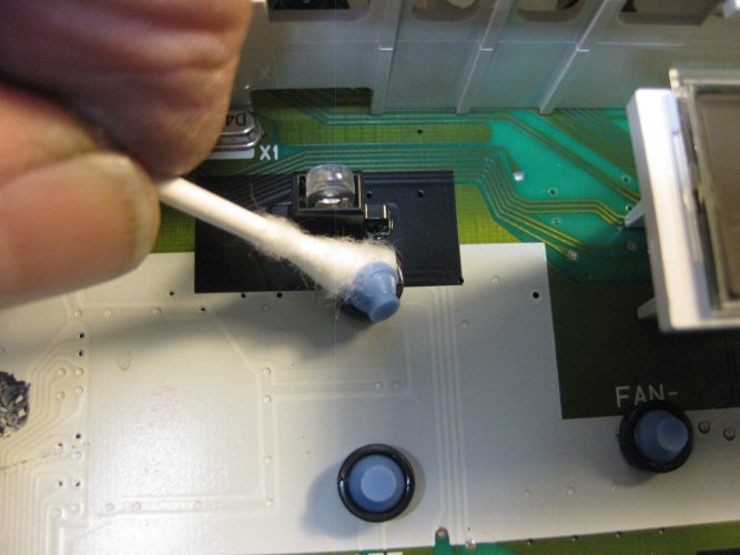

Cleaned the switches and ultimately swapped out a rubber 'hat' on the HVAC switches in my '99 LX 470. After removing all the hats and cleaning or replacing them, the climate controls work as they should. Ordered switches from overstock.com.
If the switch doesn't work after you clean it, it's because the conductive carbon on the rubber hat is worn off, and thus the hat needs to be replaced. If you have a dental explorer or scaler, it goes quickly.
