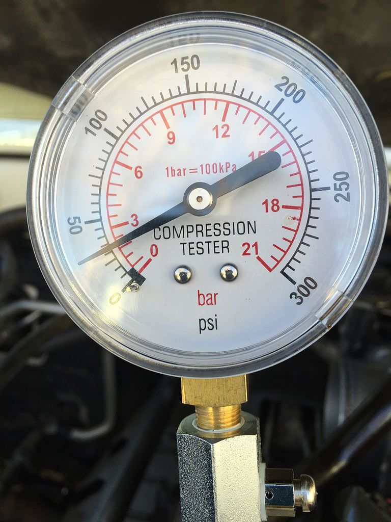

Blew a hole in every piston at the same moment?

Sudden overheat due to a blown up water pump resulting in a mangled head gasket and coolant contaminated plugs. imho.

Is the timing chain intact?

I have enough issue with Colorado emissions, I am not about to swap in something other than what came in it. I went through that years ago with a 350 in an S10 Blazer and it was a nightmare. The timing chain is in tact, just no compression. The good news is I bought a new motor and transmission. The bad news is that I called today to make arrangements to pick it up and he sold it! :( I want to go back to the days when a handshake meant something.
