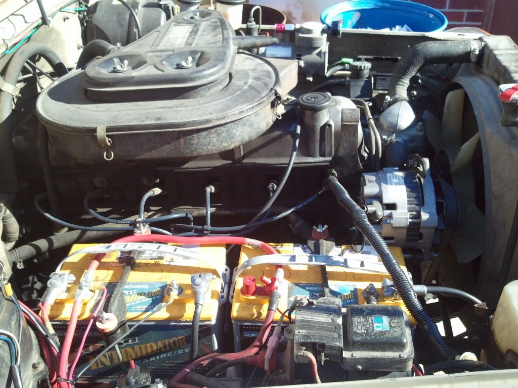

I have two dekas from Hensley. I have had this same set up on a couple of different rigs. I like the extra posts to add electrical stuff.

Hensley was great with the Blems. I returned them and got the Marine version of the Deka intemidators deep cycle and put them in my trailer dual setup.

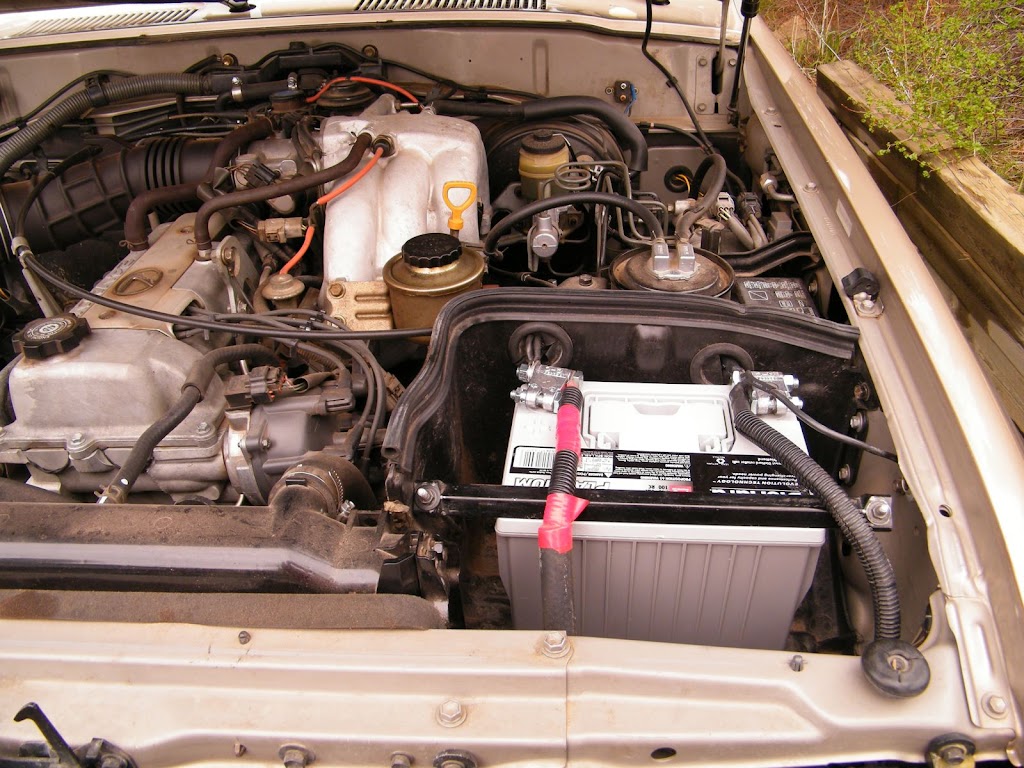

I ended up picking up a group 35. In a bit of a time crunch for this upcoming weekend and didnt feel like having to lengthen wires and such. (They were already slightly shorter due to new o-ring ends to fit the military terminals).
I called one o'rieley and stopped at another; neither had any of the superstart agm's and when I asked none of the sales people knew what I was talking about. :rolleyes:
Lots of money spent but better than battery acid dripping into the tray. The fit of the battery isn't super nice; I may try and get some shims for the side and upper back, but its pretty solid as it sits so I may just leave it. This battery is fairly small physically but it has more cca's than the group 27 that I took out of there, and weights a fair bit less. I don't have a fridge or any accessories that stay on, and really intermittent use of the winch is all I have over the stock current draw, so I think this battery will suffice for a while.
