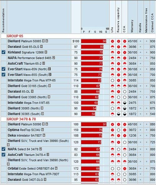

I thought others would find this of interest
The Die Hard Platinum (Odyessy), Red Top Orbital and Deka are the top three batteries based on Consumer Reports and real offroad testing
The Orbital Exide is not known for long life, found that out myself on two of them
The Deka has the outstanding reserve capacity to run the Holy graille at night, per Kevins use and Consumer Reports testing:D
It would have been interesting if they had included the Yellow and Blue Top Optimas in their test.
From Consumer Reports
Our battery-life test is based on a standard recently adopted by the Society of Automotive Engineers. Our test includes partially draining and then recharging each battery almost 3,000 times over a 10-week period, during which the battery must meet voltage and amperage limits based on real-life demands. The highest scorers maintained higher voltages and were able to withstand more cycles.
In addition to how we test car batteries for endurance, our reserve-capacity test measures how long an auto battery can supply power if the charging system fails or if you leave your headlights or accessories on. The lowest-scoring models in our test should provide 1½ hours of power. Higher-scoring models can supply power well past 2 hours.
We also test for cold-cranking amps (CCA). That’s the measure of current that’s available at 0º F and is the primary indicator of cold-climate performance. CCA has long been a major selling point for batteries. But we believe that the industry’s claimed CCA doesn’t reflect real-world conditions because batteries are charged at a higher voltage than the 14.5 volts provided by most vehicles’ alternators. Our CCA test is based on more realistic charging voltages and amperage demands, and our results show each battery’s relative cranking power, regardless of the manufacturer’s claims.

Romer...thanks for posting this CR data. Makes me feel OK about my DieHard Platinum.:cheers: I will say that it is the HEAVIEST battery I have ever picked up!!! I'm about 6'3" and it took everything to get it up and seated in the battery tray!!!

You are right there....these batteries are definately heavy! The group 31 Deka I have is 71#'s!!!!!!!!!!! :eek: Royal biatch to get in and out of the battery box! :rant:

So why didn't CR recommend the top three? :confused:
Oh yeah... they are CR. :rolleyes:
17,795
Their "best buy" recommendation is always very good quality for a great price, not the best quality at any price. But they always show you their rankings, so you can buy the top rated _____ if you so choose. That's almost never the bargain.
