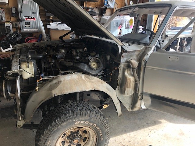

well, I can't say enough about the exhaust fan, like file this one under the"should have done that years ago" column.. wow what a difference. I was able to sand right in front of it, then instead of shaking the piece off I blew it into the fan with the air gun. Almost no dust got onto the floor, let alone into the air. Then I emptied 1/2 a can of primer out onto it, twice. I could go in the house for 5 minutes then come back to the garage and it was like I hadn't even been painting. Night and day compared to before I had any fan in the door. I still don't have the intake fan hooked up, or any plastic blocking off the 40, but for spraying one part in the corner of the room this is awesome. Will have to look at the ground outside the door tomorrow, see if I can see any of my dust or overspray.
I then took off the passenger side fenders. Like most projects the second side takes about half the time as the first side took. The inside of the fender has some muddy needle-like dirt on it, but other than that this side is actually cleaner than the DS was..
