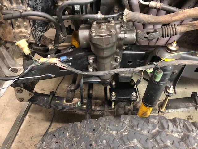

and I pulled that inner fender. totally worth it, as I have a bunch more access to the body. Spent a little time tonight just wiping stuff off.
It would also be a good time to lower that bump stop.
