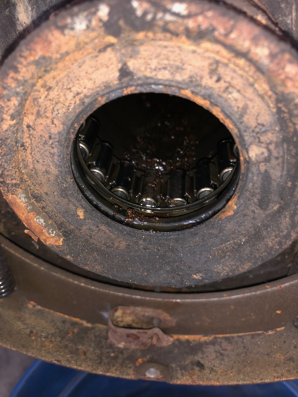

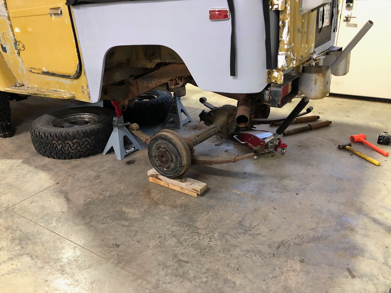

Awhile back when I installed the rear driveshaft, I noticed that the flange on the differential had a bunch of play it. And when I say a bunch, it would move up and down 1/4". The pinion nut was still staked in the original position and looked like it had never been messed with. I am guessing the crush sleeve somehow went bad?

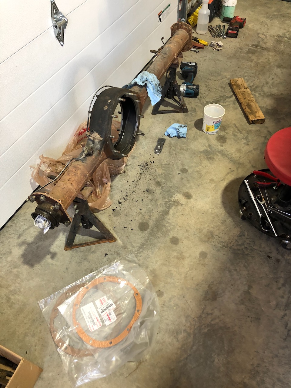

I decided to swap out the rear third member over the holidays because I had another axle in good condition. After taking the third member out, I made the decision to swap the entire axle because the housing had some rust and debris in it - and the donor one is in great shape.
A look in the hold to see the rusty debris...
full
full
New Toyota gaskets going on the third member.

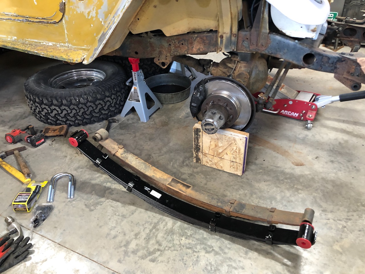

Because I had the axle completely out, I decided to order a new 2.5" suspension kit. I believe the shocks on the 40 were original and surprisingly, were still all in good working condition.

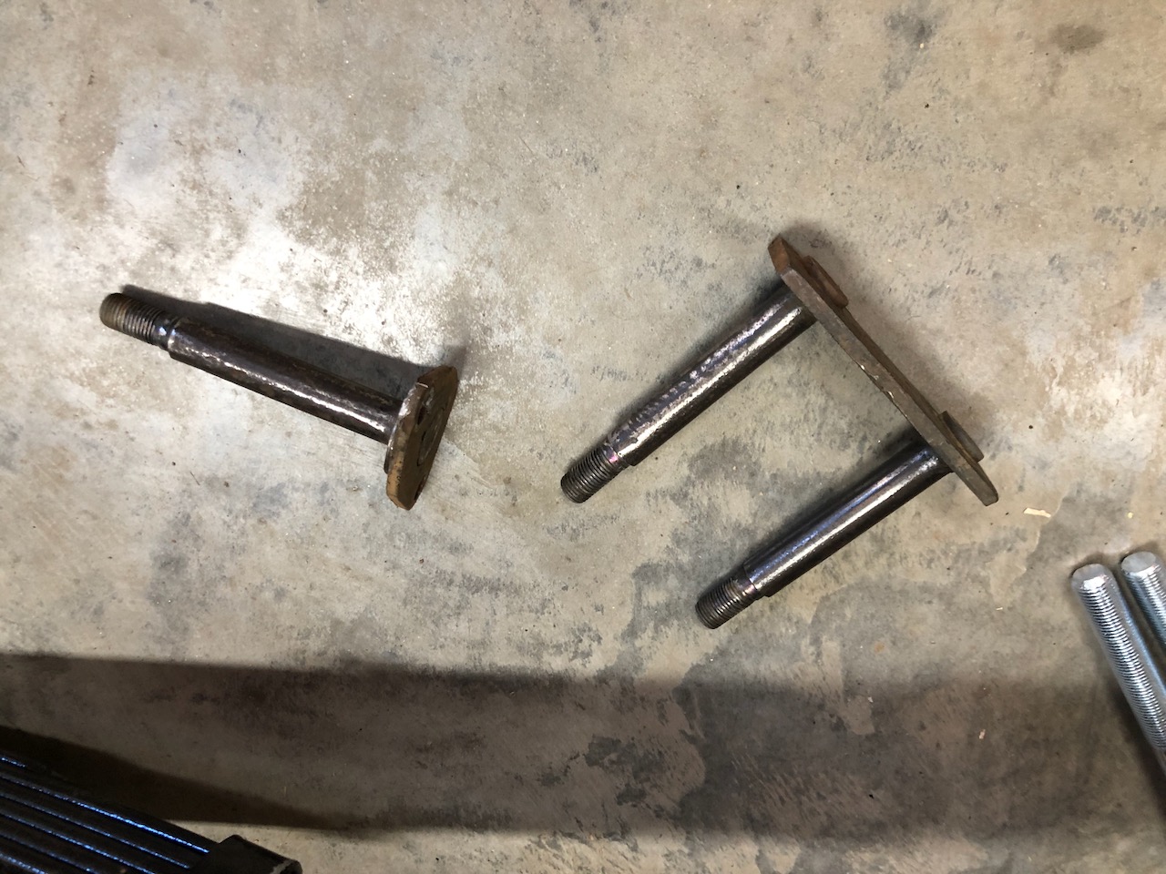

The original leaf spring pins and shackles all came out without too much fuss and were in good enough shape to hit them with the grinder for a
little cleanup and reinstall with new bushings. The leaf springs came with new bushings and I used Energy Suspension bushings on the shackles.
full
full
full
The lift is from Pro Comp and I am impressed with the quality of the leaf springs. And most importantly, the spring length is well designed. I hate when companies add more arch to leaf springs without increasing the length and the shackle angle ends up vertical. I had this happen with Old Man Emu springs on the back of a an old 1st gen Toyota pickup and it rode like crap. The shackle angle is great with these Pro Comp springs and the rear wheel looks like it is centered in the wheel well.

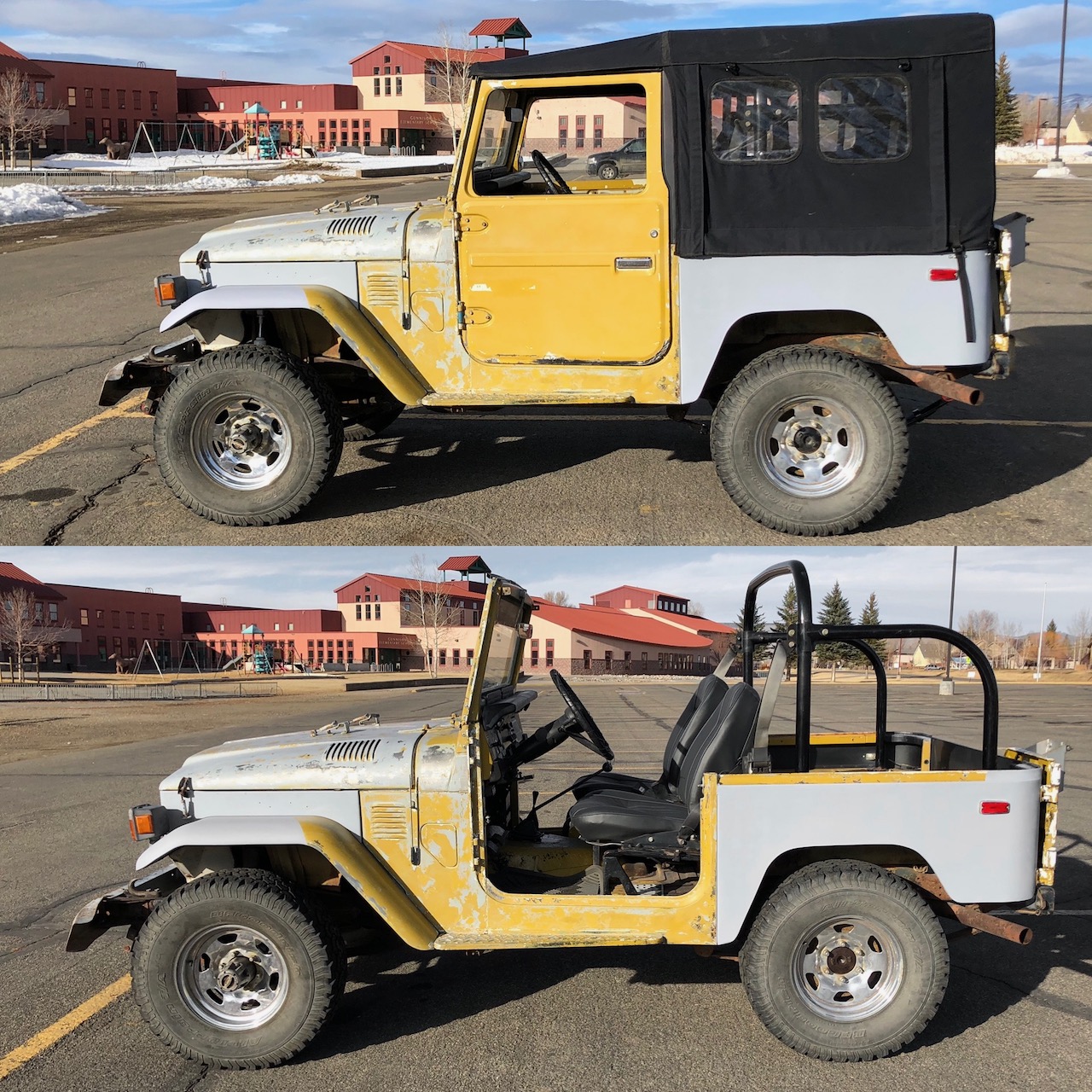

A comparison picture of the lift and stock. There is no spare tire mounted or weight in the back for either of these pictures.
I like that the height of the lift is mild. I'm sure it would look really good with some 33x10.5s.

I agree about the 33x10.5, it's what I run on all my cruisers. Nice compromise between highway manners and off road capability (and I can lift the spare LOL). I had 35 x 12.5 on my HZJ75 and they were just a bit much.

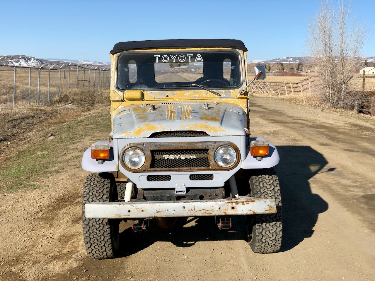

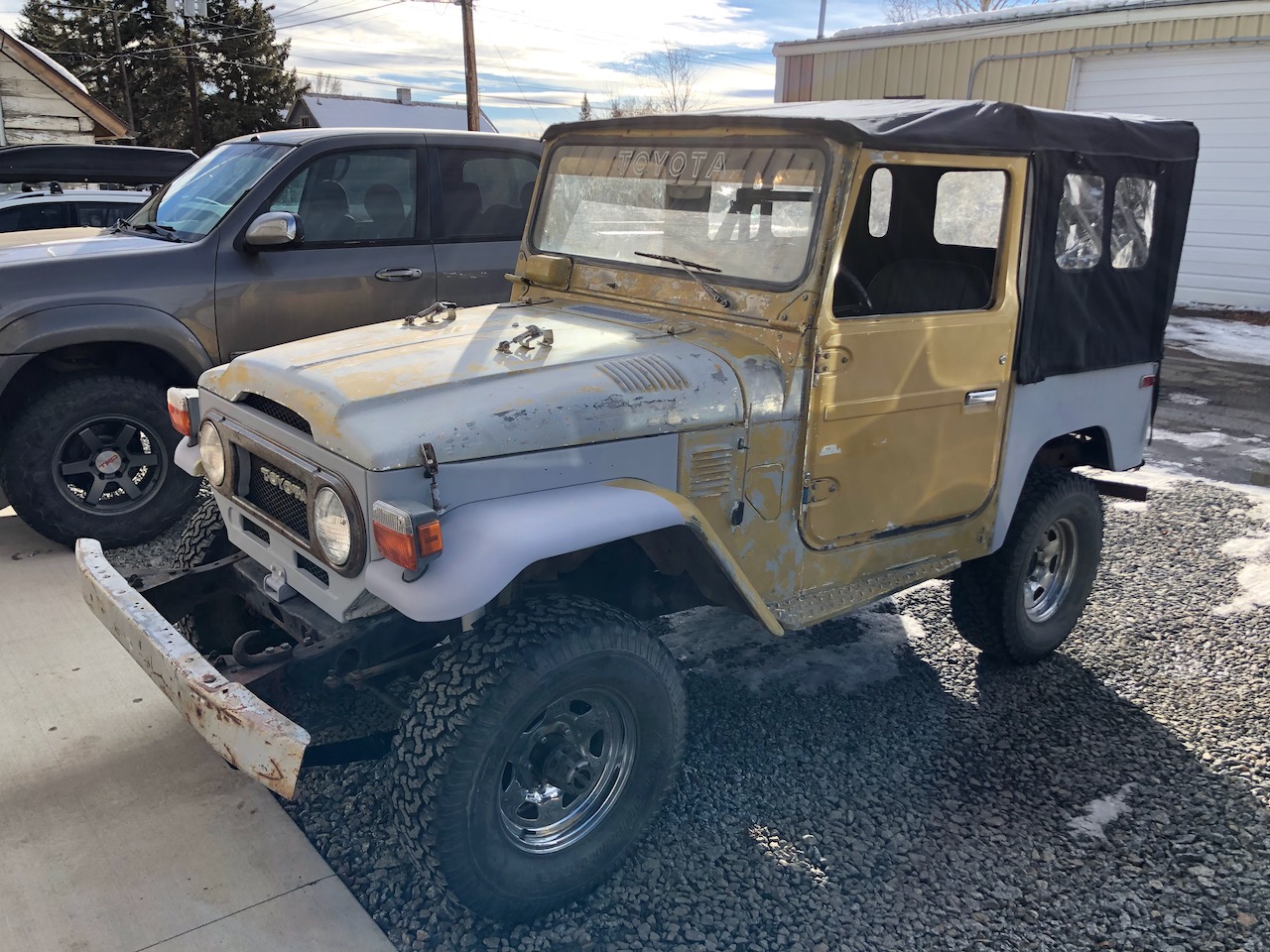

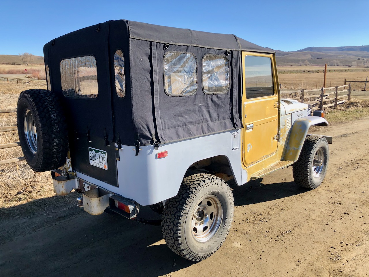

I'm certainly overdue on an update. This spring the Mustard with Mayo moved onto a new owner. Sad to see it go, but I want to build what I originally intended to (a stretched 40) and needed the funds to do so. A few nice pictures from this spring.

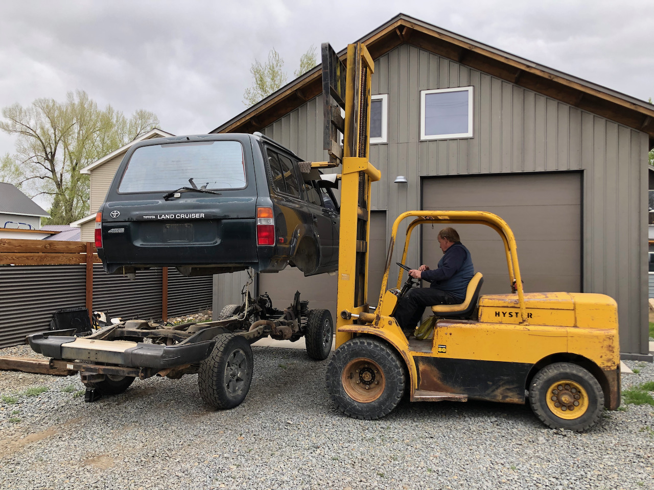

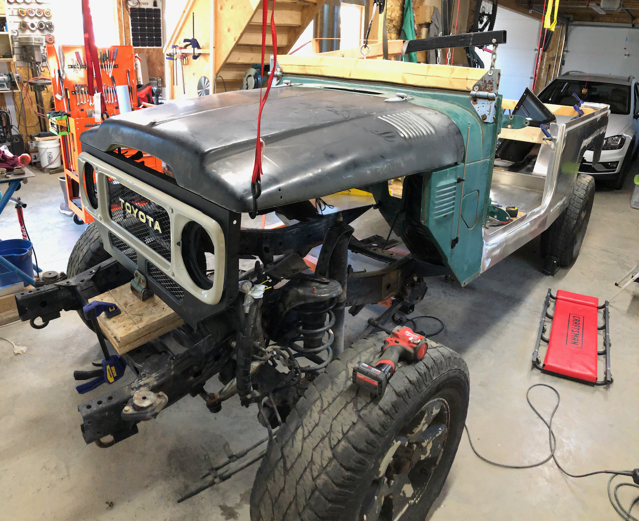

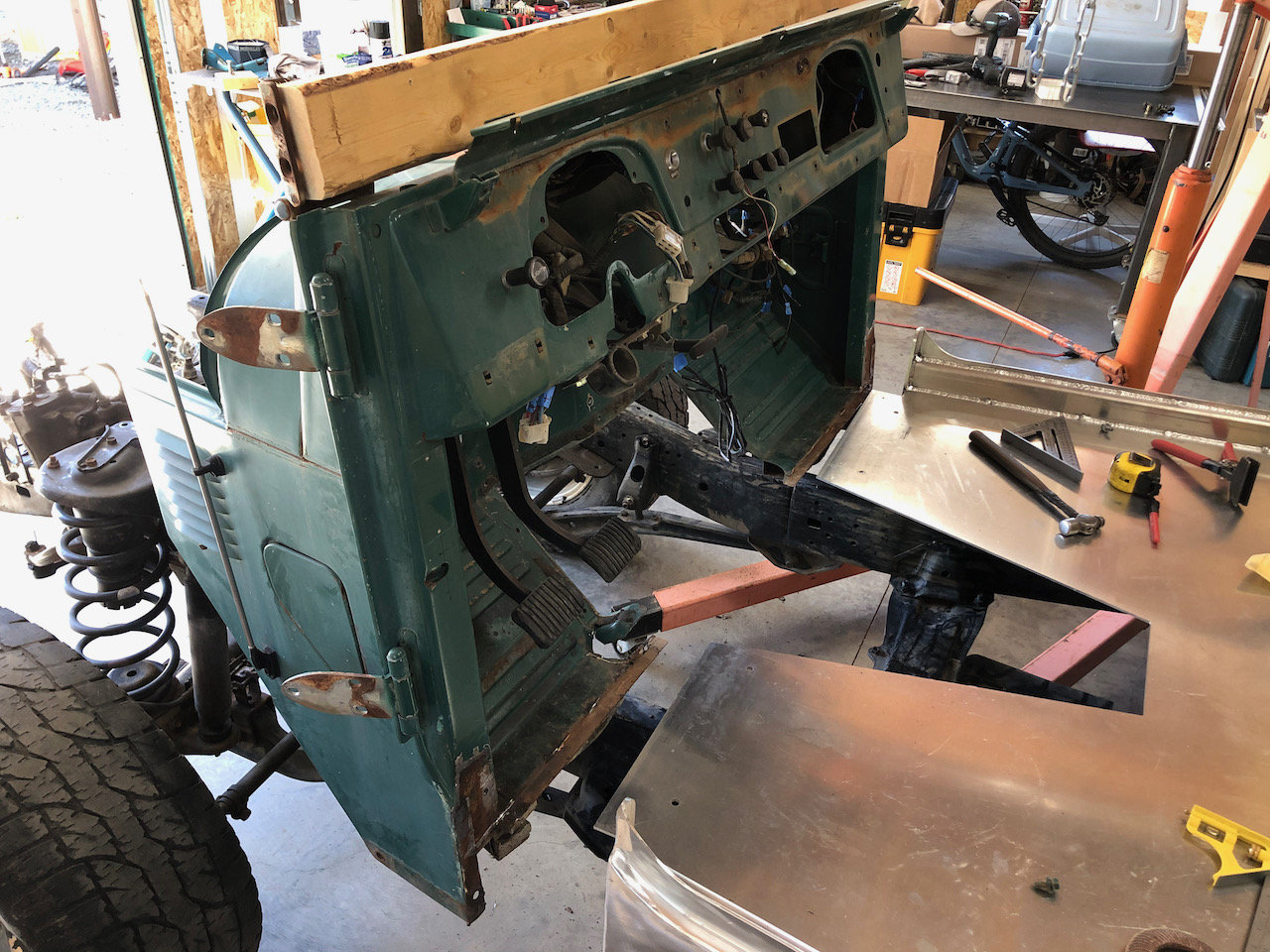

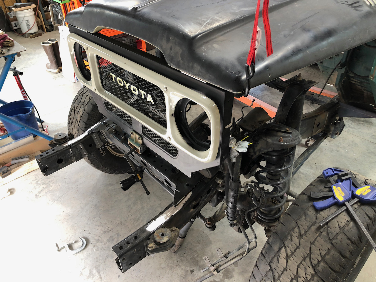

And a little teaser of starting to fulfill my original vision for a 40 build. Of course it has morphed some. I think it is probably best to start a new build thread since this is a separate truck, but thought it would be good to introduce it here. I will post a link to the new build thread when I start one.

Reminds me a little of when Gary Coberly put an FJ45 body onto and FZJ80 chassis and motor. If memory serves, he decided he wanted more power than the 1FZ-FE and ended up replacing it with a 2UZ-FE.
