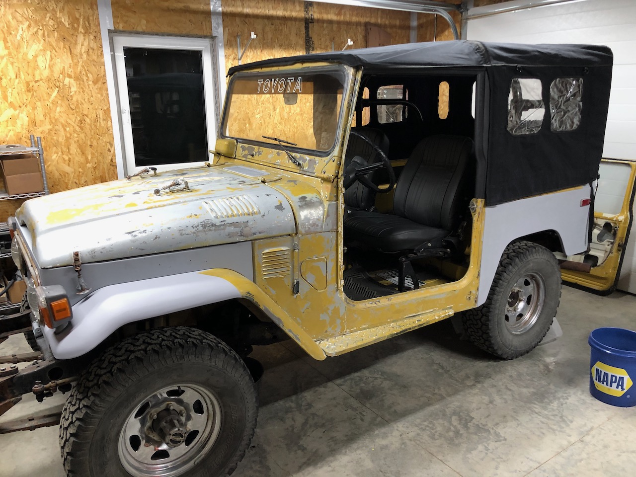

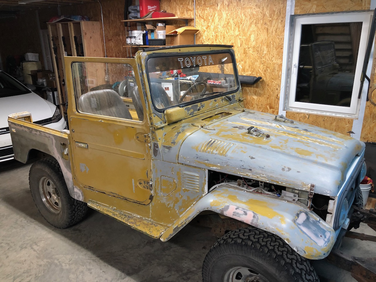

I found a set of mustard doors with a similar paint patina to the rest of the 40.
full
Unfortunately, the driver-side glass was broken in shipping. Anyone have a spare driver-side window in their parts stash?

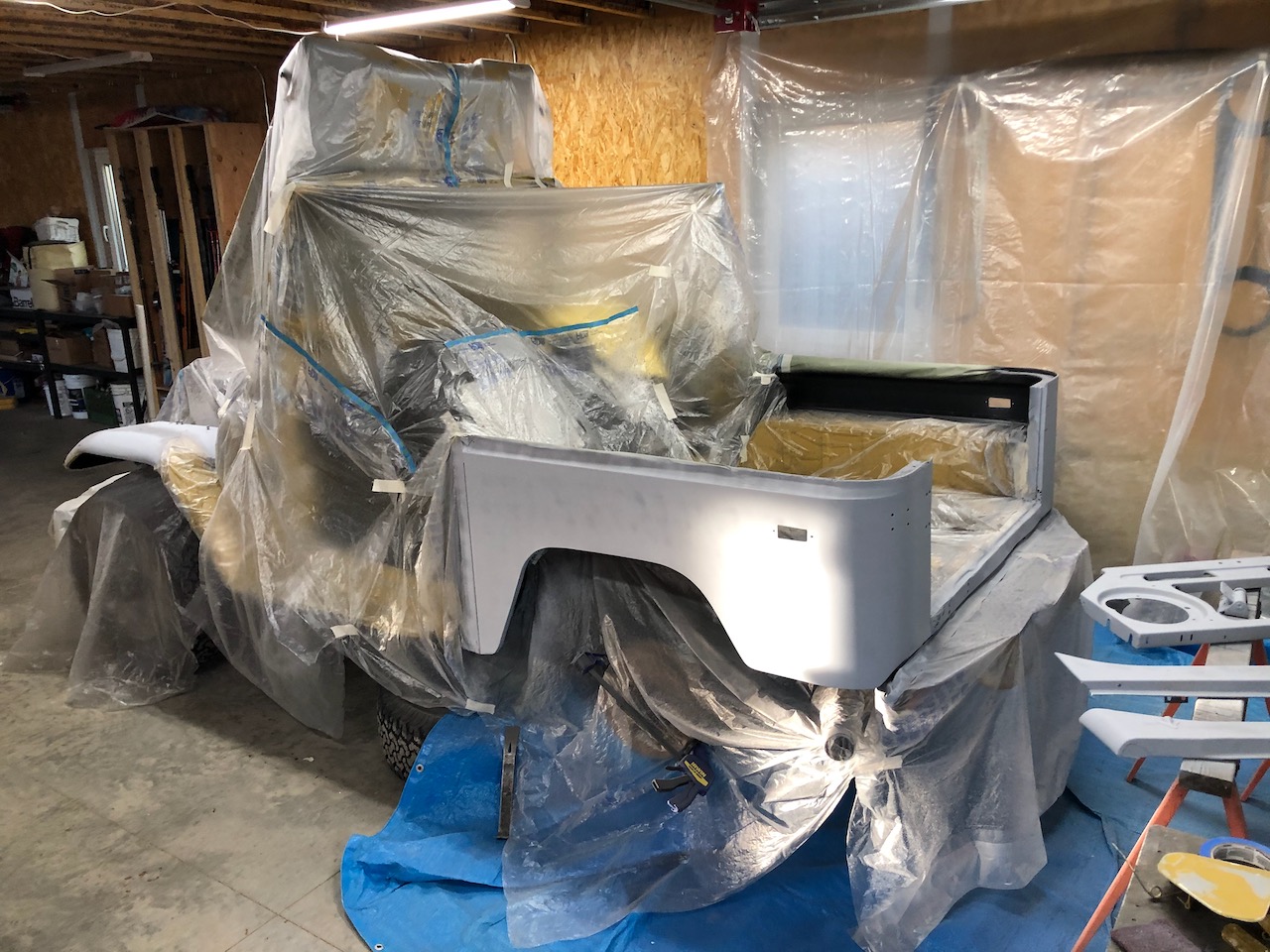

Got everything prepped for paint and starting spraying over the weekend. I used minimal filler over the weld areas to smooth them out. The new paint is gray to match the primer gray color on the hood.
You might wonder why I'm not painting the whole thing? I like the original paint character with the patchy yellow... we will see how the look of my mis-match paint turns out.

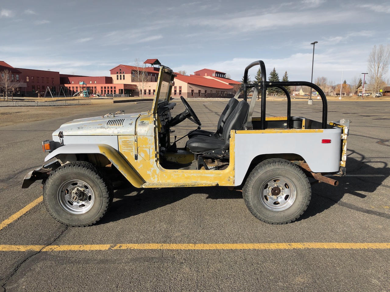

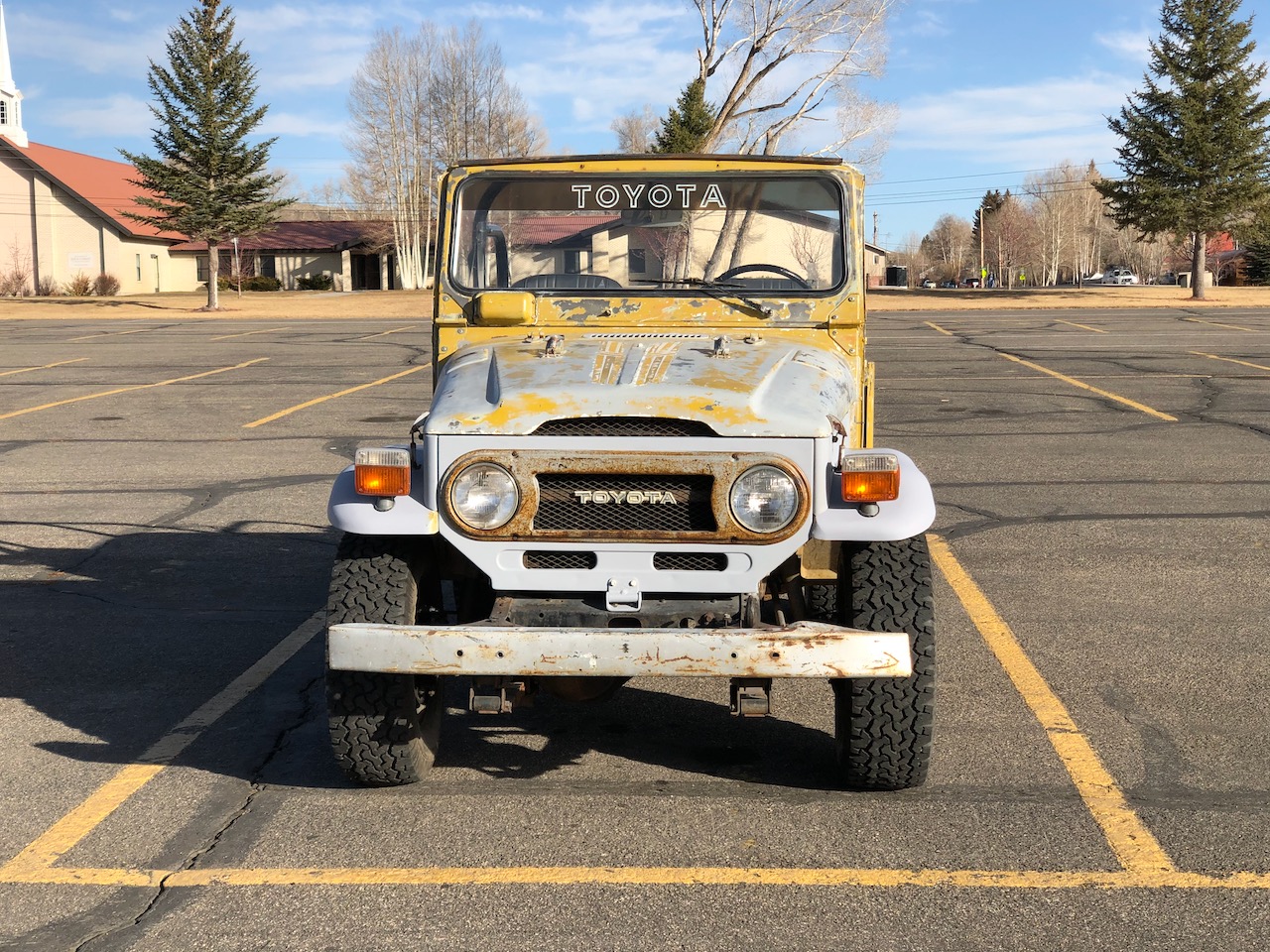

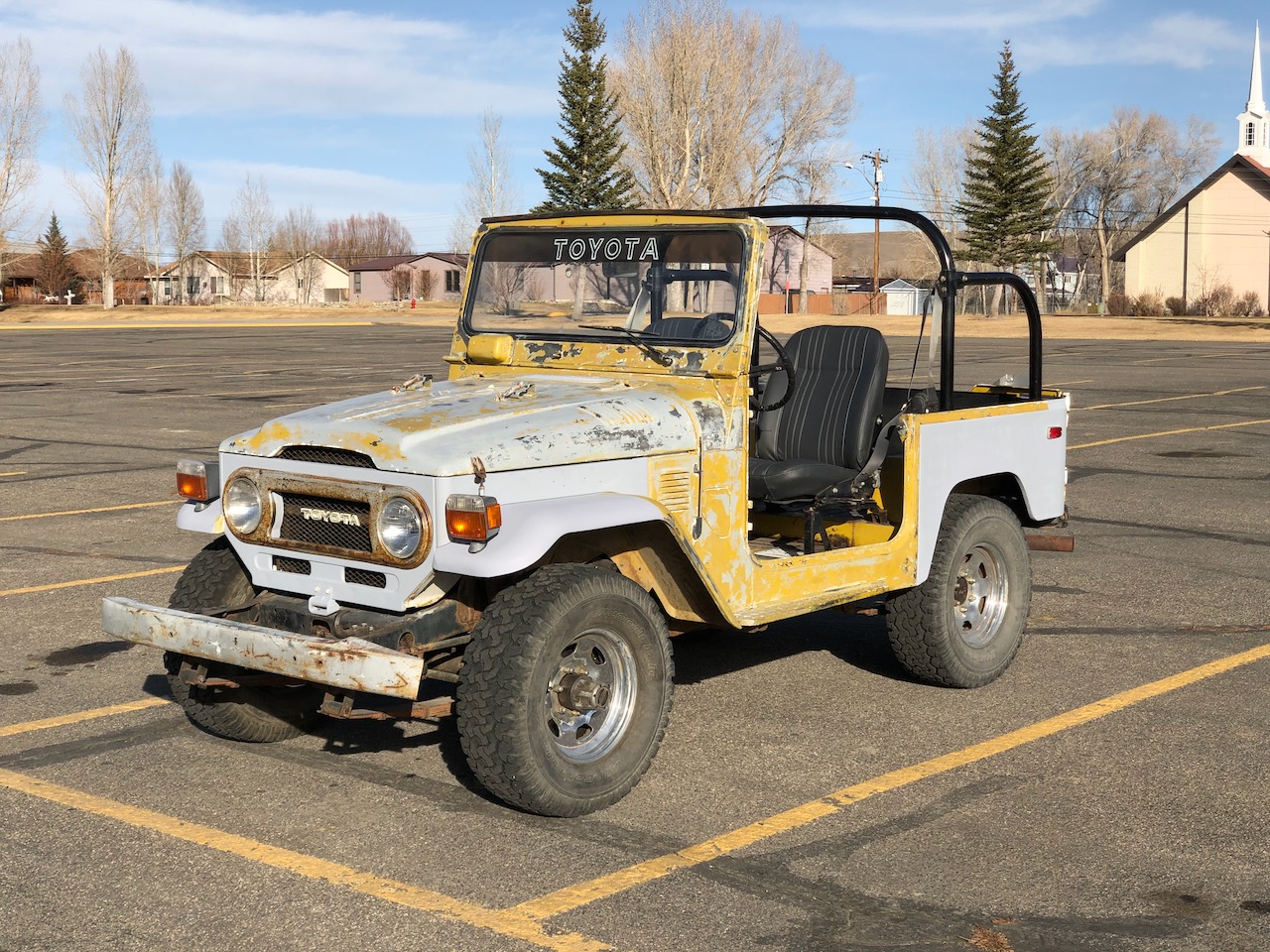

I pulled all of the masking and put it back together to get it out into the sunlight. I managed to hit the last warm afternoon we had to get to enjoy driving around town. The 40 is such a blast to drive without doors and a top.
full
full
full
full

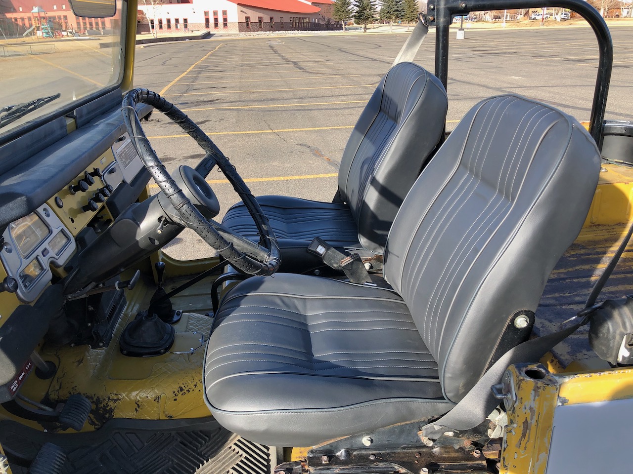

I also installed new front seat upholstery from Cruiser Corps along with buttoning up some other interior stuff like installing shift boots. Seeing the new seats, my wife was even excited to take it for a drive around the block.
I am not sure if I like the mis-match paint better than re-painting the whole thing... however, if it has shiny new paint then I feel like everything else needs to go to the next level. Definitely a slippery slope.

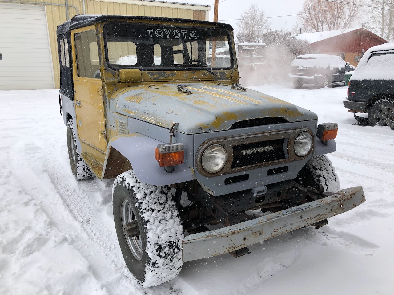

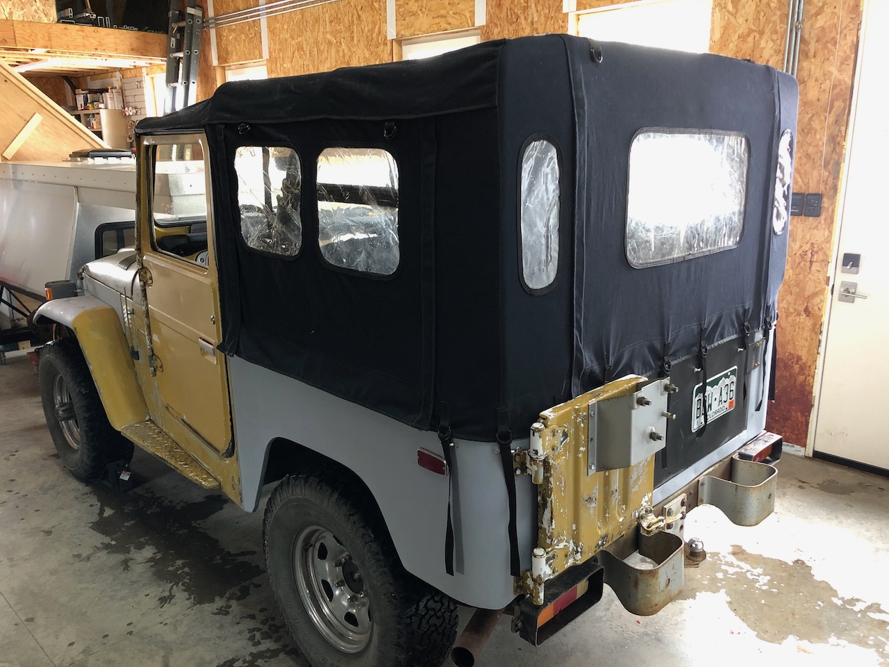

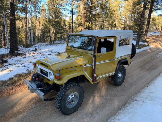

Abe will like this action - I installed the soft top I got from him. The top is a simple canvas fabric one that he had made in Pakistan. This first picture is during installation and before I pulled it tight by installing the footman loops and twist locks.
full

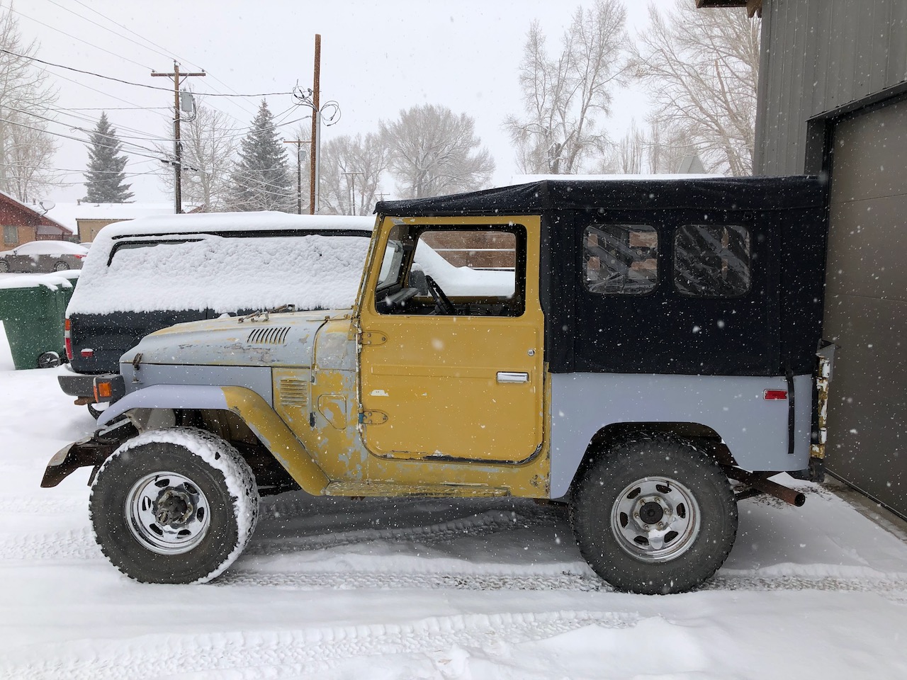

I had to shuffle stuff around in the garage today so the 40 got to pull out of the garage and feel the fresh snow for a few minutes.
full
full
full
What do you do with the extra strap length that hangs down from the footman loops? Cut it shorter and/or tie it up somehow?
I am taking this 40 further than I originally intended and I would like to start building my original vision (a soft top troopy starting with a 40 body). If anyone here is interested in the 40 as it sits - message me. Otherwise, I will paint it. And then I should probably do suspension and tires too...
gr8fulabe
Sep 3, 2005
1,760
Boulder Canyon
Nice! I have the straps left long so that people can trim as they like. Cut to the length you like, use a lighter to melt the end & seal it off.
