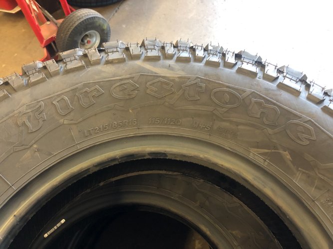

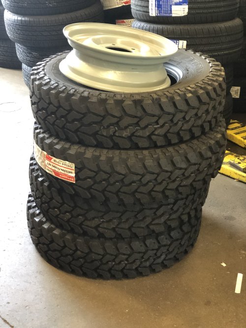

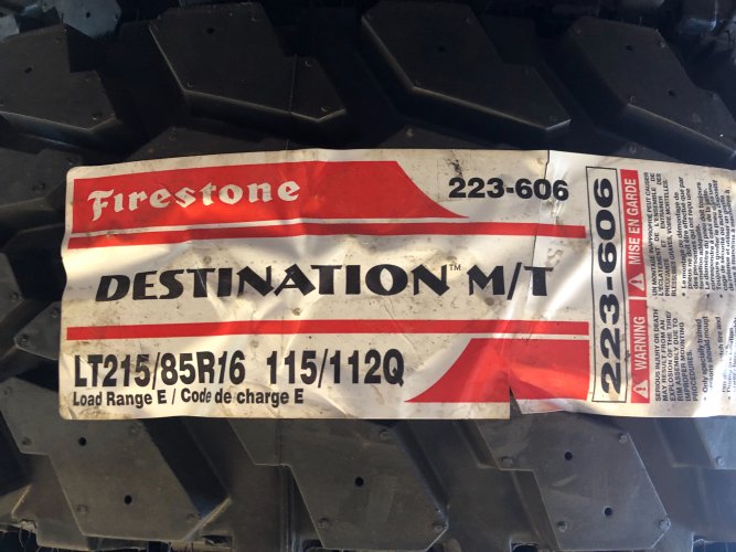

I’m jonesing for the City Racer 16” w hubcaps. Just way better tire sizes for 16….if you’re into the tall skinnies like I want.

Exactly why I eventually want 16s w stock hubcaps like City Racer sells.
