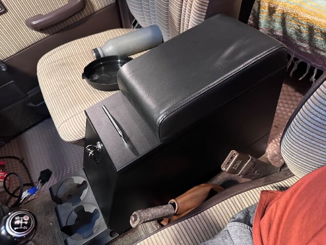

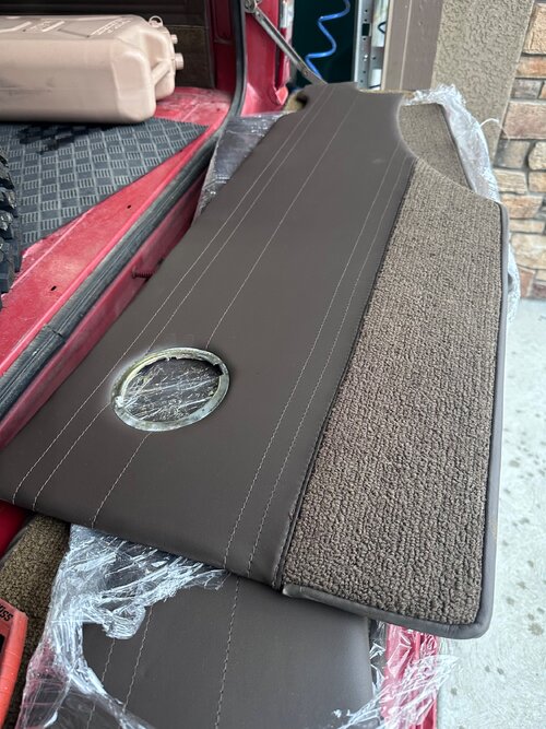

I’m not sure if I like it or hate all the blackness that takes over the cabin, maybe I’ll swap the top with a brown leather to see if I can grow to like it, but hey, cup holders—precious, cup holders.

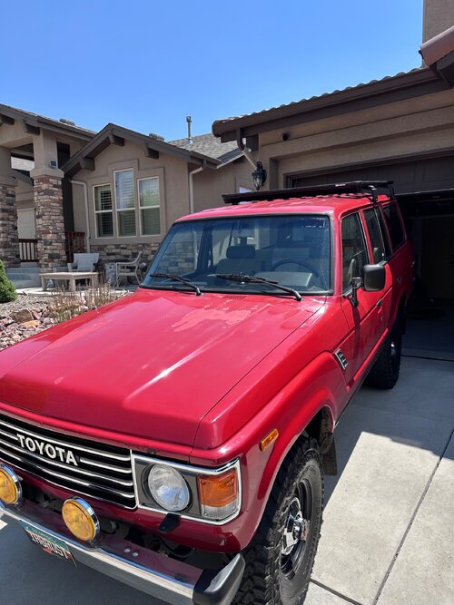

Preparing for the body and paint work. Meanwhile, I might also have a hoarding problem, I don’t know.

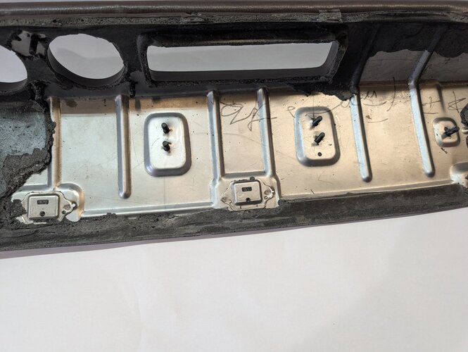

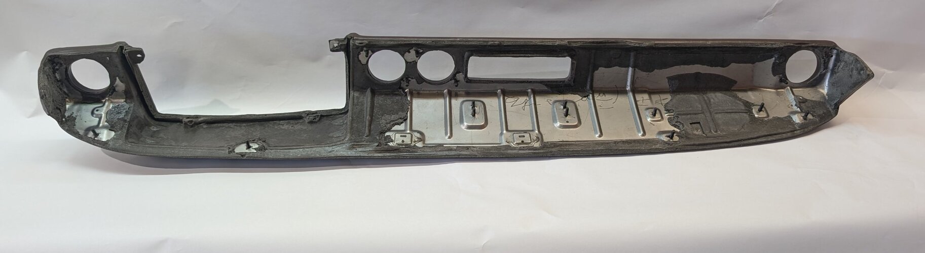

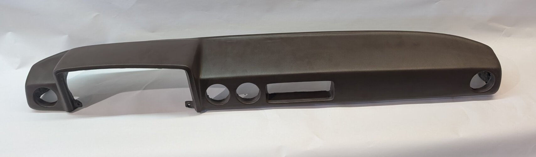

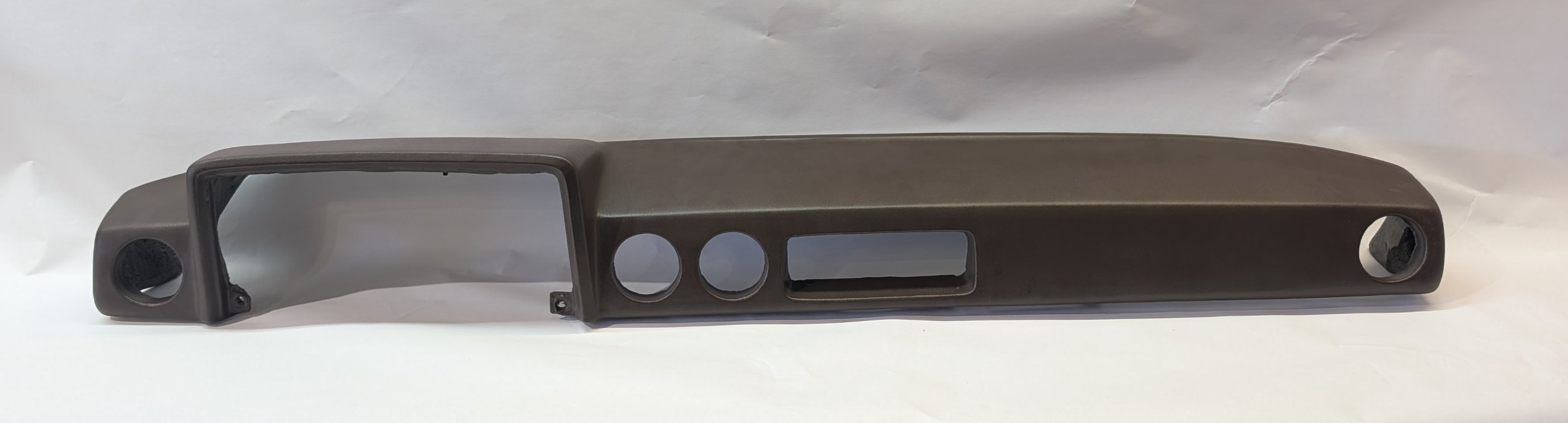

Meanwhile, I look forward to the day I install this on my rig. Looks terrific. It's not a pop, and it's not a full restoration at $1,200. It's what all FJ60 owners crave: a reasonably priced replacement that's true to form.
Dash Pic 4 First Article.jpgDash Pic 3 First Article.jpgDash Pic 2 First Article.jpgDash Pic 1 First Article.jpg
Is that the rust farmers one? Are they shipping them out now?

That is awesome to see. I have not been keeping up with the mud thread. My Dash has a very small crack developing. I am still a ways out from spending that on a replacement, but glad to see we have better options than the cap covers.
My crack is so small I am considering covering it with a RAM mount. Still not sure what the plan is with replacing my factory radio. Its nice... but for the price they go for on ebay these days I could sell it and redo the entire audio system.
