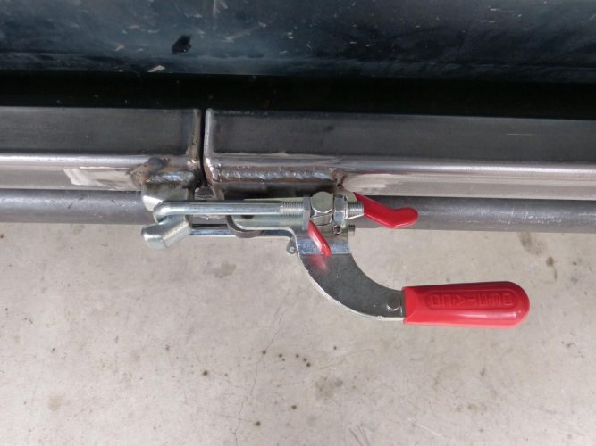

I do have to say. My Millermatic 211 is a completely different animal on 220v. Bumper shell is tacked and first two real welds are in place. Waiting for the duty cycle to catch up. Close up of the 1/4" wing and 3/16" main shell joint.

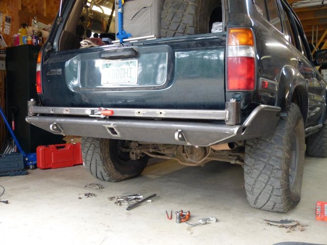

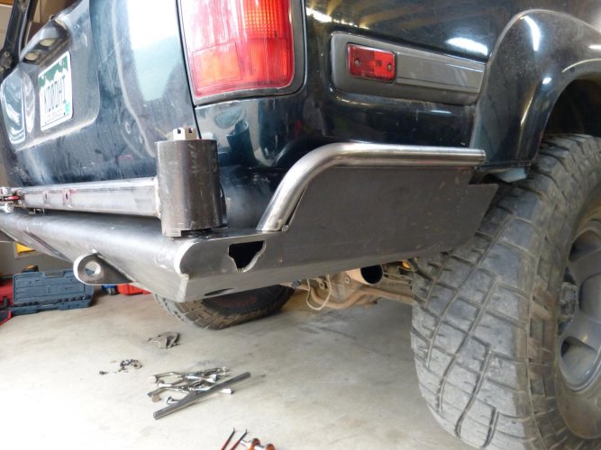

Calling a day early. I need to run to town for work and with Marianne out of town its beers and billiards here tonight for the guys in the neighborhood. Need to be back in time to clean up.
Got the swing arms in place. Need to add the outward stops and struts, then finish welding the spindles and the rest of the internal lower bumper. Side tubes are tacked in place and again need finish welding. Tomorrow I should be able to wrap it up and build the tire carrier.

That's looking great, Corbet, man those welds are sweet dude.

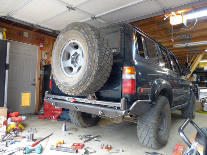

Late lunch. Got the tire on. Now I just need to pull the whole thing off and finish weld the inside of the bumper and spindles to be able to drive it.
Not sure what direction I'm going with the ladder yet. The tire carrier I pretty much just copied the 4x4 Labs design but built it from scratch. I wan't to get the hi-lift behind the tire some how. Still thinking about that. Luke generally mounts the jack on the 2nd swing arm. I might build multiple accessories for that side and don't want the have to work out a hi-lift mount each time.
Need to move the license plate somewhere too. Be nice to have it on the spare tire side.

Any particular reason you chose to mount on the passenger side swing arm?
I'm assuming your asking why the tire on the passenger side? My fridge will get moved over to that side as that is where my 12v outlets are. As the fridge will already be blocking my view I figured the tire won't make it any worse. Also if I'm on the side of the road changing a flat is seems more logical to have it on that side safety wise.

does that big ol' tire wobble any?
9,489
It does some. I have not really torqued down the two mounting bolts on the swing arm yet. I figure I should wait until its powder coated before I really pinch that clamp. But its not bad considering the wheel and tire are over 100lbs.
