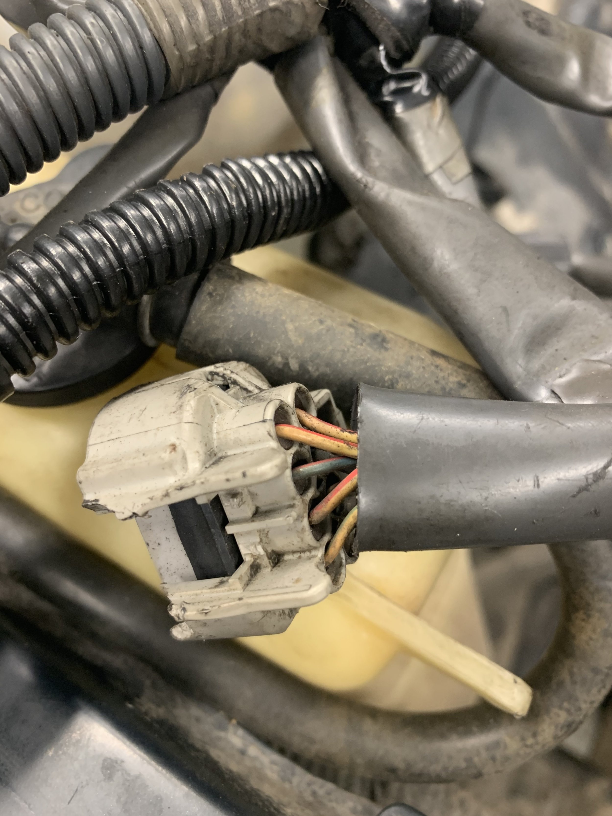

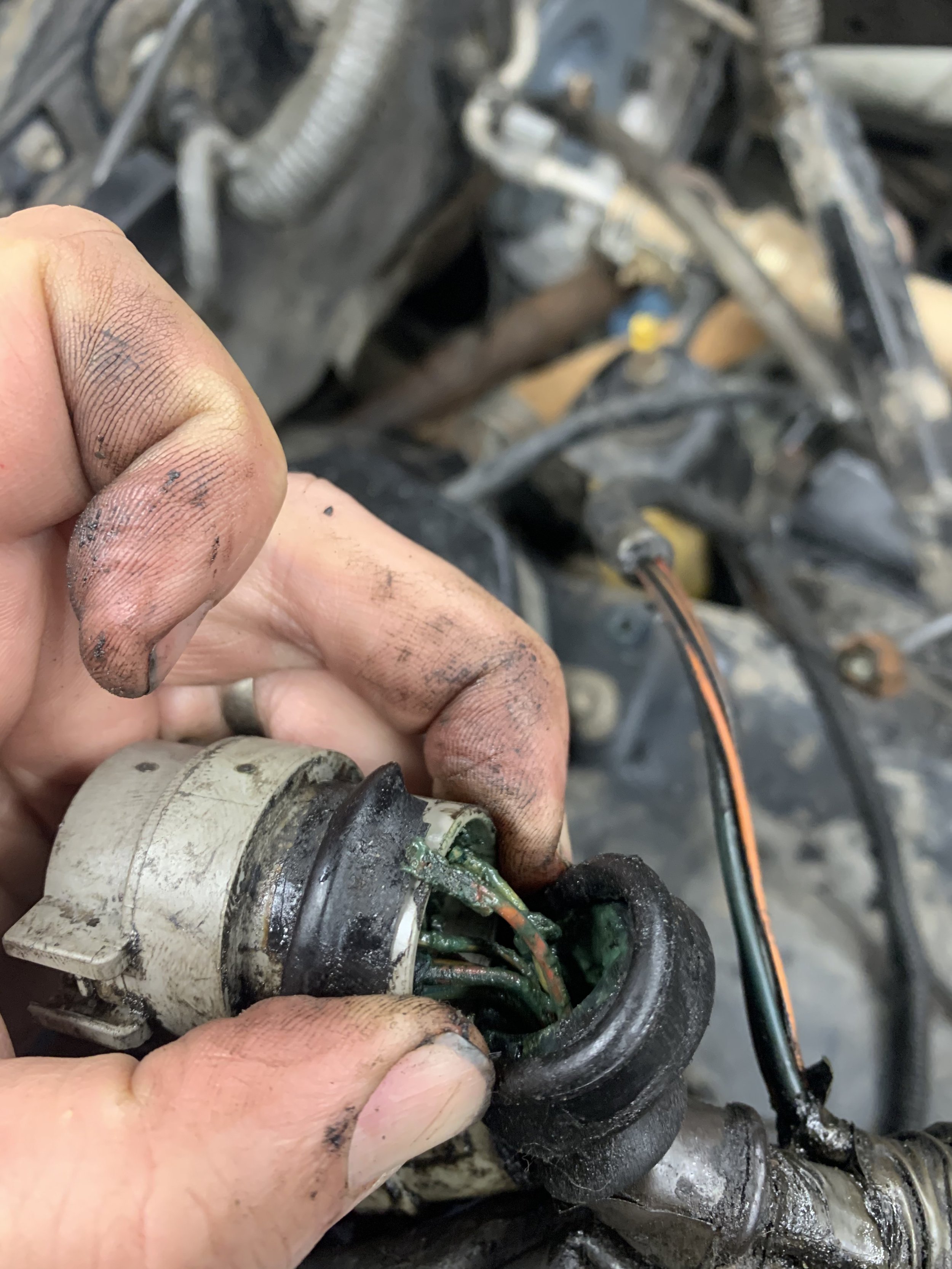

Long overdue for an update! I’m hoping to hear it run this weekend. I’ve been fighting oil drenched connectors and some corrosion.
I’ve repinned, heatshrunk, re split loomed like the entire engine harness. I’d pay stupid money for a clean nice OBD1 harness lol.
Here are some samples of what I repinned and repaired.
