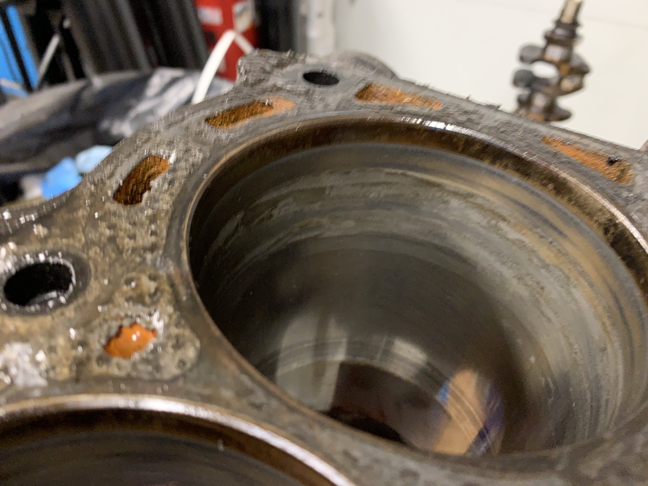

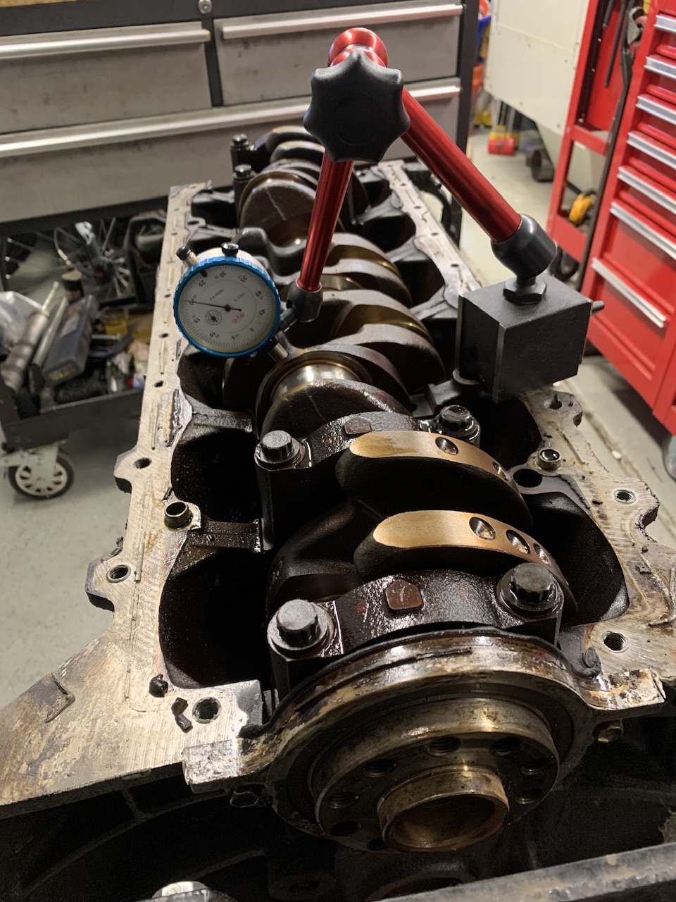

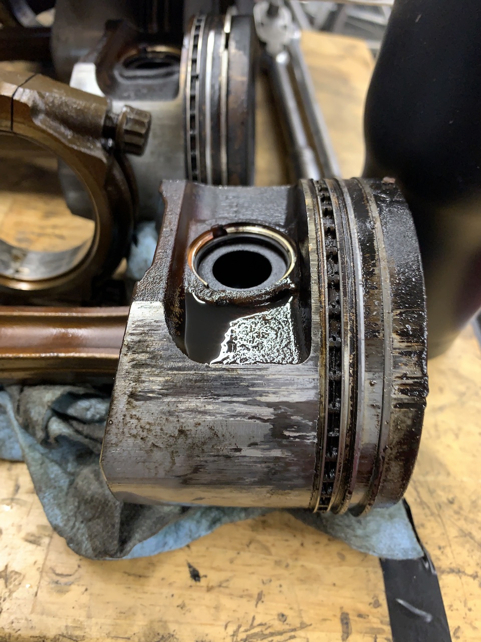

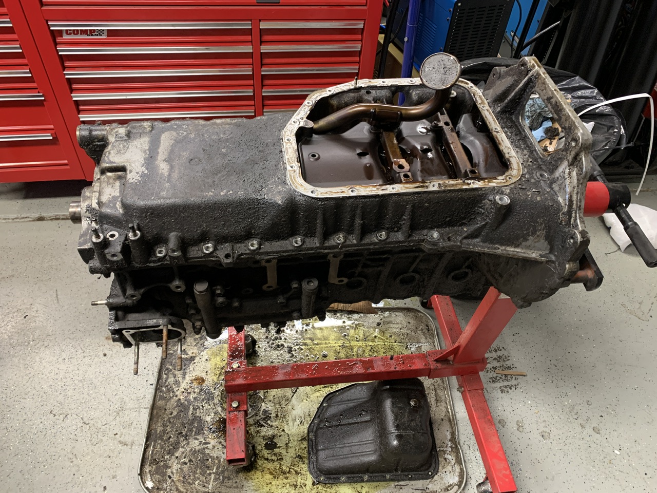

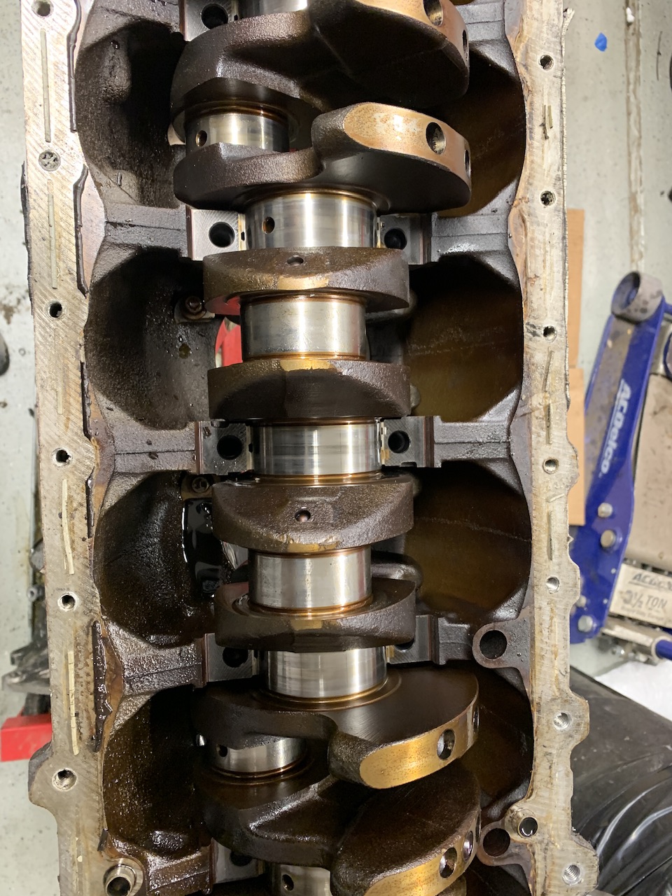

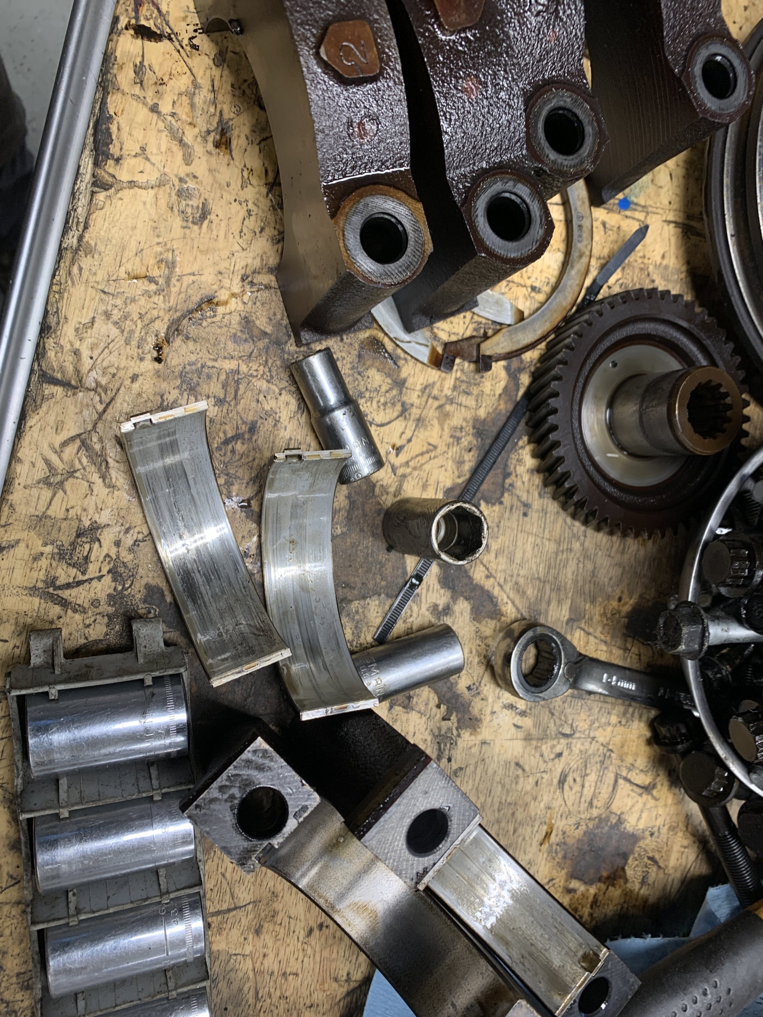

I need to get the old block off the stand. So decided to tear it down. It has a slight rod knock that when away with rpm. I figured it would be fairly catastrophic, but to my surprise, there were no spun rod or main bearings. Looks like an unfortunate case of brief oil starvation or coolant contamination. The head is in excellent and reusable shape. I might have to bore it and put it back together.
The cylinder walls and pistons are pretty hammered and will need to be bored/replaced.
Amazingly the worst spot on the crank showed about 0.0008” TIR which is way better than I expected.
Anyone need a good 1fz builder? I hate to trash it….

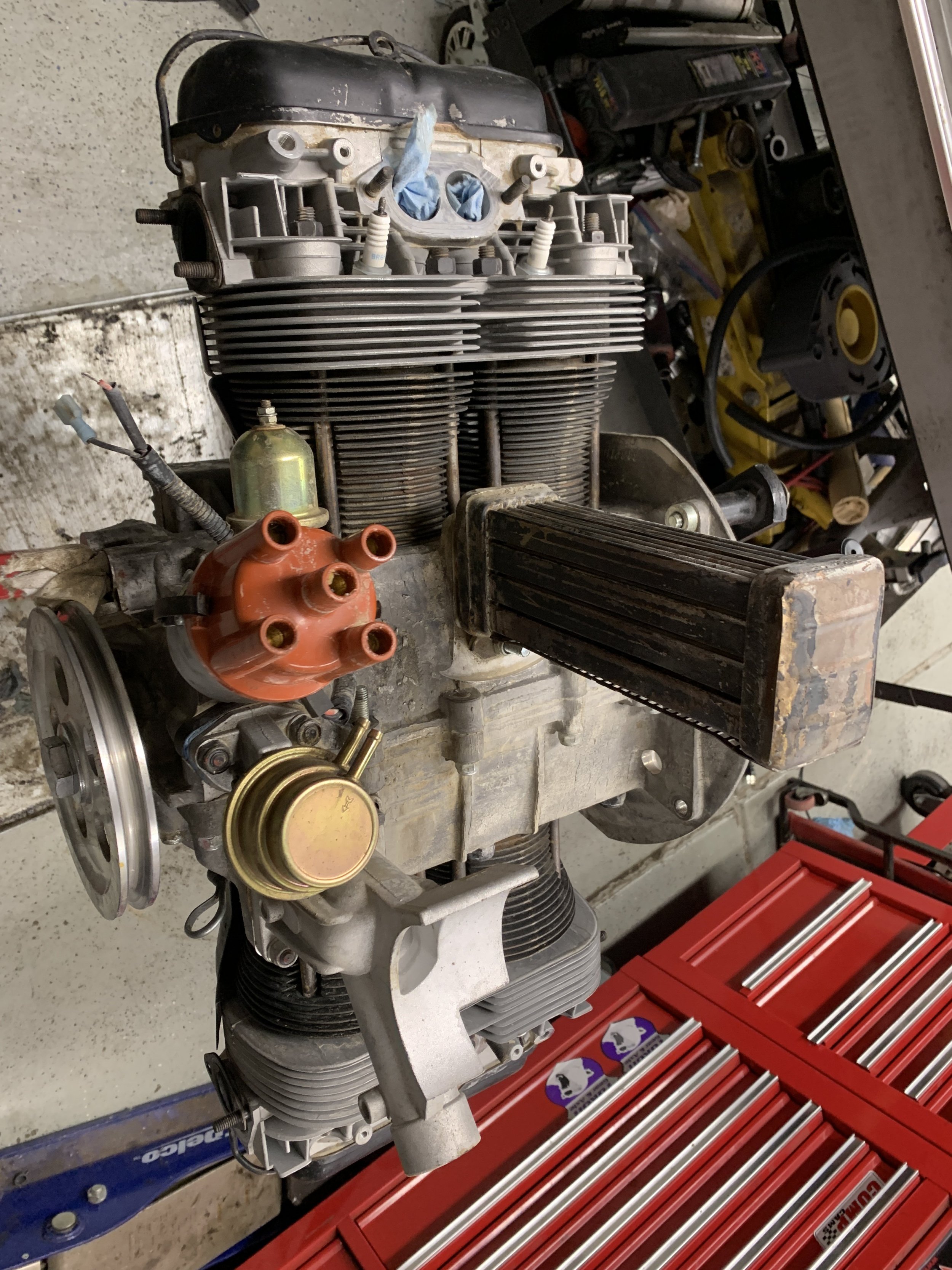

Well cranked away last night to make room for the beetle engine we’ll be running in the Norra 1000, it ingested a bunch of dirt and needs a set of eyes on it before we trust it. The 1fz is being yanked off the stand today.

sorry for the hijack - gonna pick your brain once I pick up a 1600 short block I want to build for the bus
Ha! Man I really don’t know anything about these. I have a manual to go off of, but aside from that, it’s got all your basic engine stuff that tells you how tired they are. Hopefully it’s a quick peek and she gets reassembled and sent to live another day.
Thanks @rover67 i might hit you up. I figured that’s how the cases are sealed up. What’s your flavor of anaerobic sealant? 518?
9,702
Three bond 1104 (or 1184) for case halves, threebond 1211 (or 1215) or curil T for cylinders to case, loctite 574 for any gaskets, Dow 111 (or 55) for any (viton) o rings, bearing saddl surfaces (thru bolts are oil passages in 911’s ) loctite 574
9,702
For a race motor that will come apart a lot you could use regular rtv on the case halves. It’s easier to clean up than all that shit I listed.
1104 and 1211 is some good stuff. Hell 1211 was like $40 a tube back when I messed with 2 stroke stuff back in the day. I can’t imagine what it is now. Thanks for the tips. It’s going to get the piss rallied out of it so I’ll probably take you up on some stuff.
Huh! Not as bad as I expected looks like $25.
