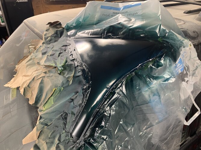

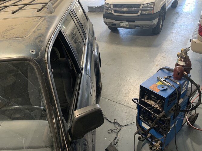

Finally getting to the item I’ve been dreading the most. The previous previous owner drilled a hole in the roof to pass a wire through for his light bar.
I had my coworker Cooper laser cut me a 20ga filler circle.
I chamfered the hole with a 100deg chamfer until I had a impeccably flush fit. My other coworker Danny tigged it in place for me.
I was so focused on getting it done, I only took one f’ing photo.
Then there was a nice divot to fill from what I suspect was the force of the drill bit. I sanded and filled with a small amount of body filler.
I’m currently in painting phase waiting for the fist coat to dry.
I hate hate hate body work. I’m no good at it, and don’t enjoy it lol. I totally could have fixed that seam sealer booger, but I’d rather be able to wash my car tomorrow lol.
