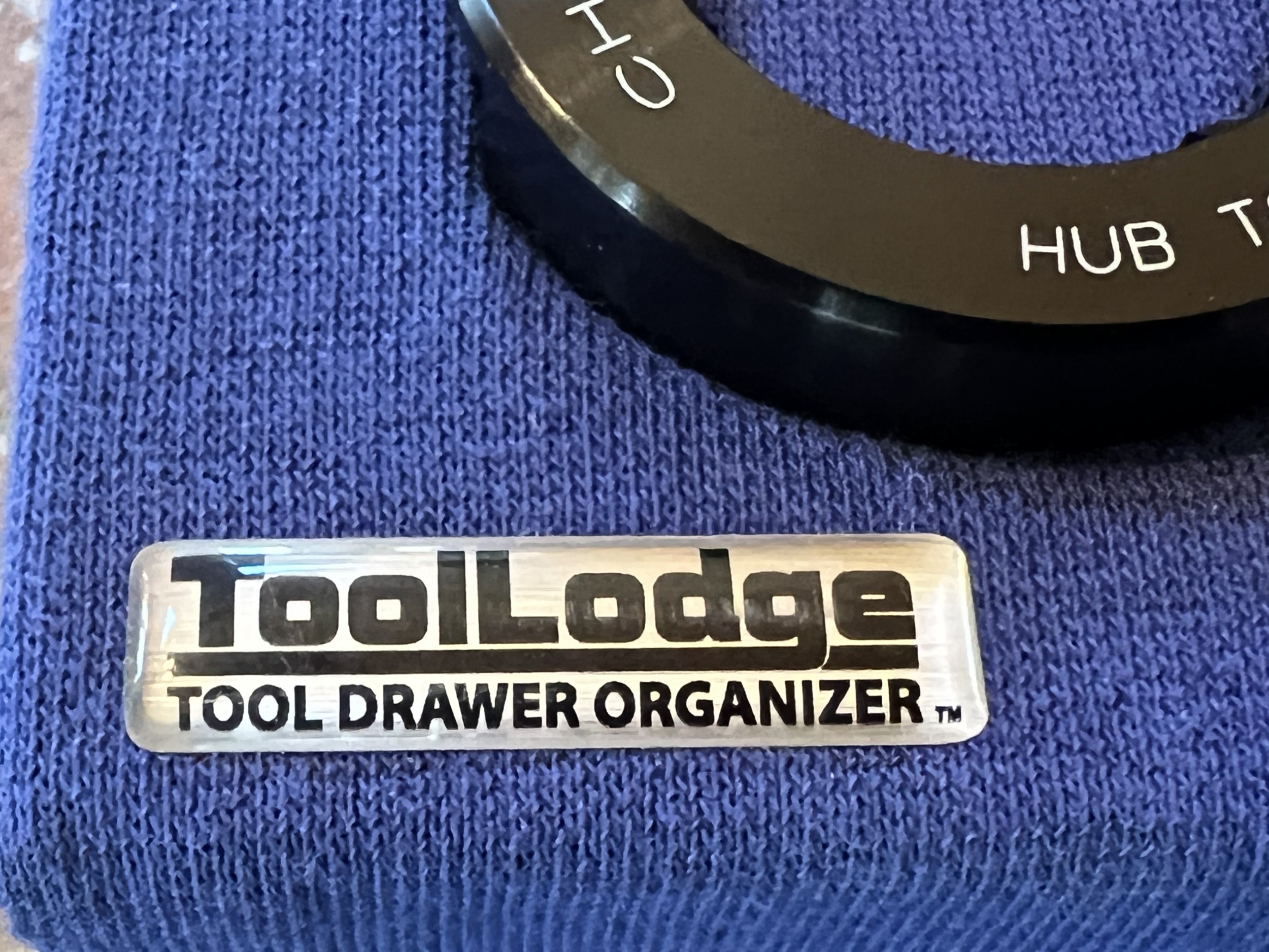

So I’ve been sitting on this Tool Lodge organizer sample for years. Perfect application for it. You simply push the tool in to make a custom form. Dead sexy tool box eye candy display.

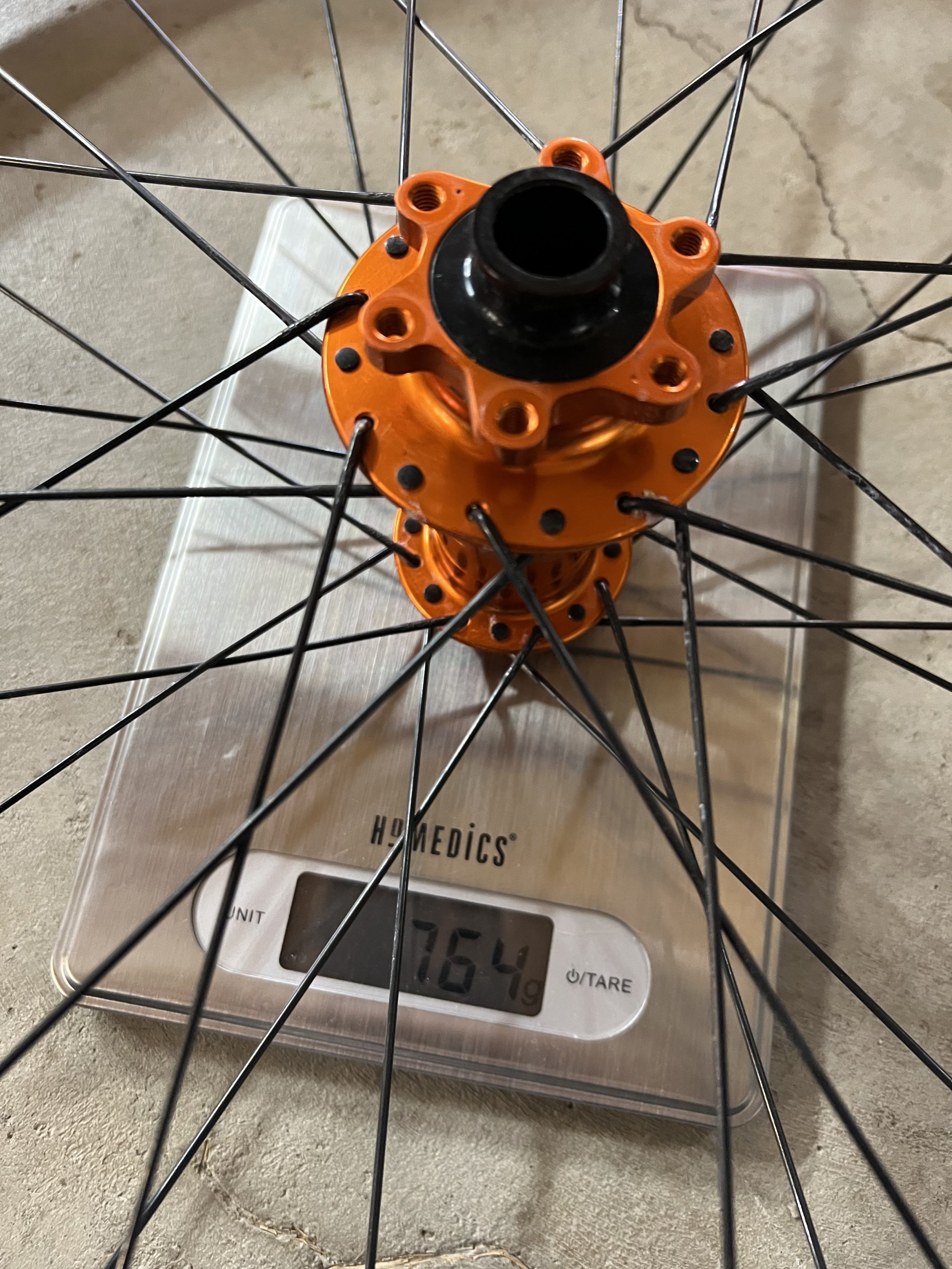

Finally getting on the Chris King/Spank 359 wheel build. DT Comps 2.0/1.8. Did my black with two silver spokes at the valve stem pattern 3x of course. I reverted back to standard alloy DT nipples. I feel they are a higher quality nipple than the new Squorx design. None of these rounded off in the tensioning process. 915g front without rim tape or valve.
I think these are my new favorite rims despite having to use nipple washers. Things tentioned up very nicely. Also helps to have a proper j-bend spoke. The king hub design is so nice with a taller flange and geometry that ends up with just 1mm difference in spoke length on each side. I will also note that adding 6mm to the Spank published ERD is the number I’ll use moving forward to compensate for rim wall thickness and nipple washers.
