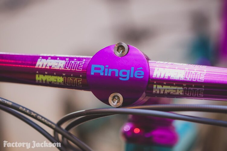

Don't diss it, Wes' retro Fat Chance is totally bitchin.
I have a vivid memory of my Answer Hyperlite breaking at the stem on a trail and the waking up looking at the tree canopy. Don't have nearly as vivid memory of how it went in-between.
