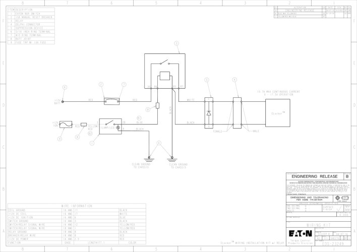

Something I miss from my old truck is the ability to select 2LOW or to engage the locker(s) in 2HI or 4HI. I see there are two kits that can trick the computer into doing these things.
This kit does 2LOW and requires getting a switch separately. This kit does the locker in any mode and then I'd need to find somewhere to poke an LED through the dash to indicate it's engaged (I guess I could use a blank switch plug and pop the LED through it). Someone reports that both kits can work together. Too bad someone doesn't make one kit that does both.
Has anyone here used either or both of those kits?
14,162
Geez, $300. Isn't the locker anytime just the grey wire mod?
Doing 2WD low is a trickier one with the 2005+ trucks and the 4WD ECU wanting things to happen in certain orders. I haven't messed with that, seems rife with ways to ruin stuff and have the ECU or an actuator fail at the least opportune moment.
DouglasVB
2,392
On the 3rd gens it seems to be much more complicated to trick the ECU into locking the locker. What I've read on old Tacoma world forum posts indicates there's a bunch of trickery that has to happen to turn on the locker without freaking out the computer. And the locker has an initial 12v engagement and then an 8v hold. Or maybe it's running via PWM. There's more of forum posting of people figuring it out. It looks like the anytime locker mod only became available last fall. But without modifying the dash cluster you lose the locker indicator light.
There were some people trying to figure out changing ECU software to allow both the 2WLo and anytime locker but that seems to be a dead end at the moment.
14,162
Yeah, that makes sense. The 2016+ locker is a different beast. It's a variation of (or maybe just is) an Eaton that uses a strong electromagnet to lock. I don't know if it's PWM but I think it does have to stay energized to stay locked. That's not to say Toyota doesn't do a PWM but the aftermarket Eaton harness just puts constant power on it through a relay.
The electronic transfer case where your dial is but a suggestion to an ECU is total b.s. They solved a problem they didn't have by not using manual hubs and a dang stick shift. Now they have to have rings and tooth detectors and timing of operations for no benefit and less reliability. Well, I guess we all have to pay to protect from people who might try to shift into 4 low at 70MPH on the Interstate. :doh:
