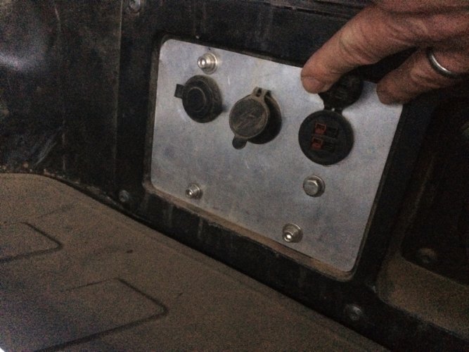

I'm staying tuned for the 12v bedside outlet and hi-lift mount. I've tried the rail mounts inside the bed, but never liked it much and after I added my Softoppper I took the rail mounts off so the Softoppper worked.
It might be a few weeks before I get to that work. I ordered an ARB compressor system and mounting hardware to put it into the driver's side truck bed side wall area. When I install that, I'll also put in the 12V plug. And maybe if I can figure out what I want to do for aux power under the hood, I'll do that at the same time.
I got a 60" hi lift Jack which is the exact same length as the bed. I might shave off an inch or two so it's not touching the front of the bed and the tailgate 😅. My truck has bed side rails where stuff can mount that is below the bed sides so mounting a jack there shouldn't interfere with the current tonneau cover or a future topper.
