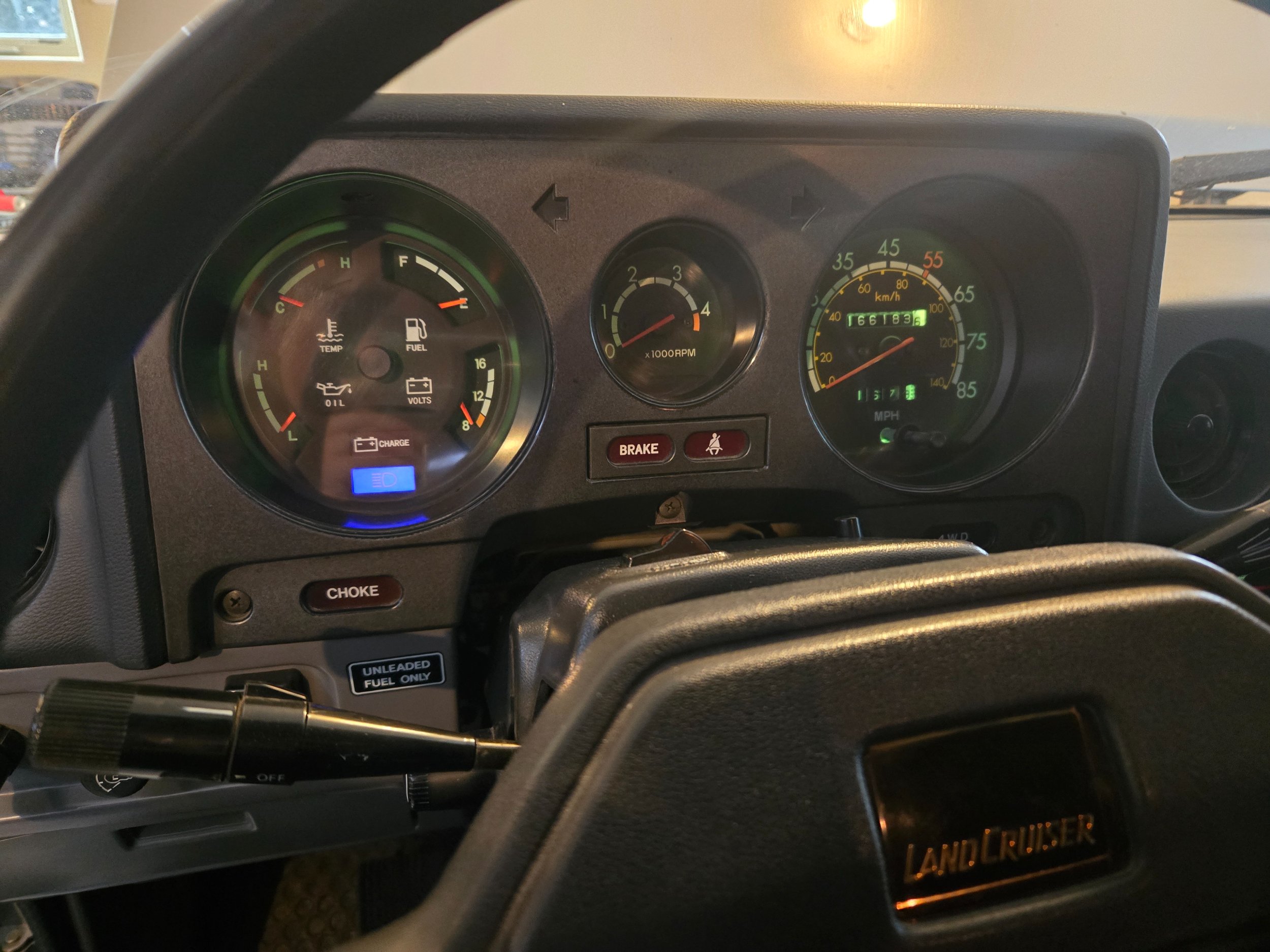

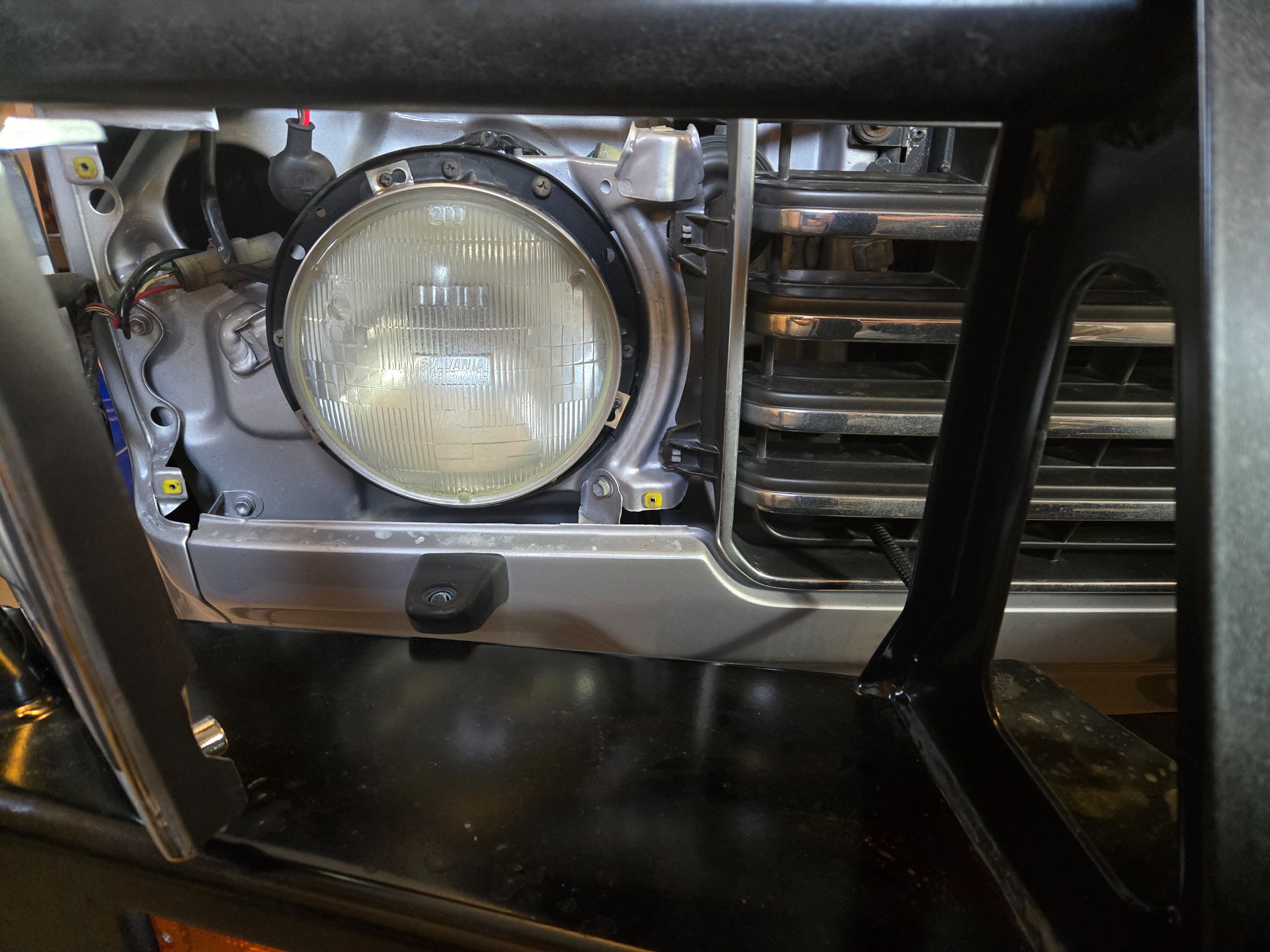

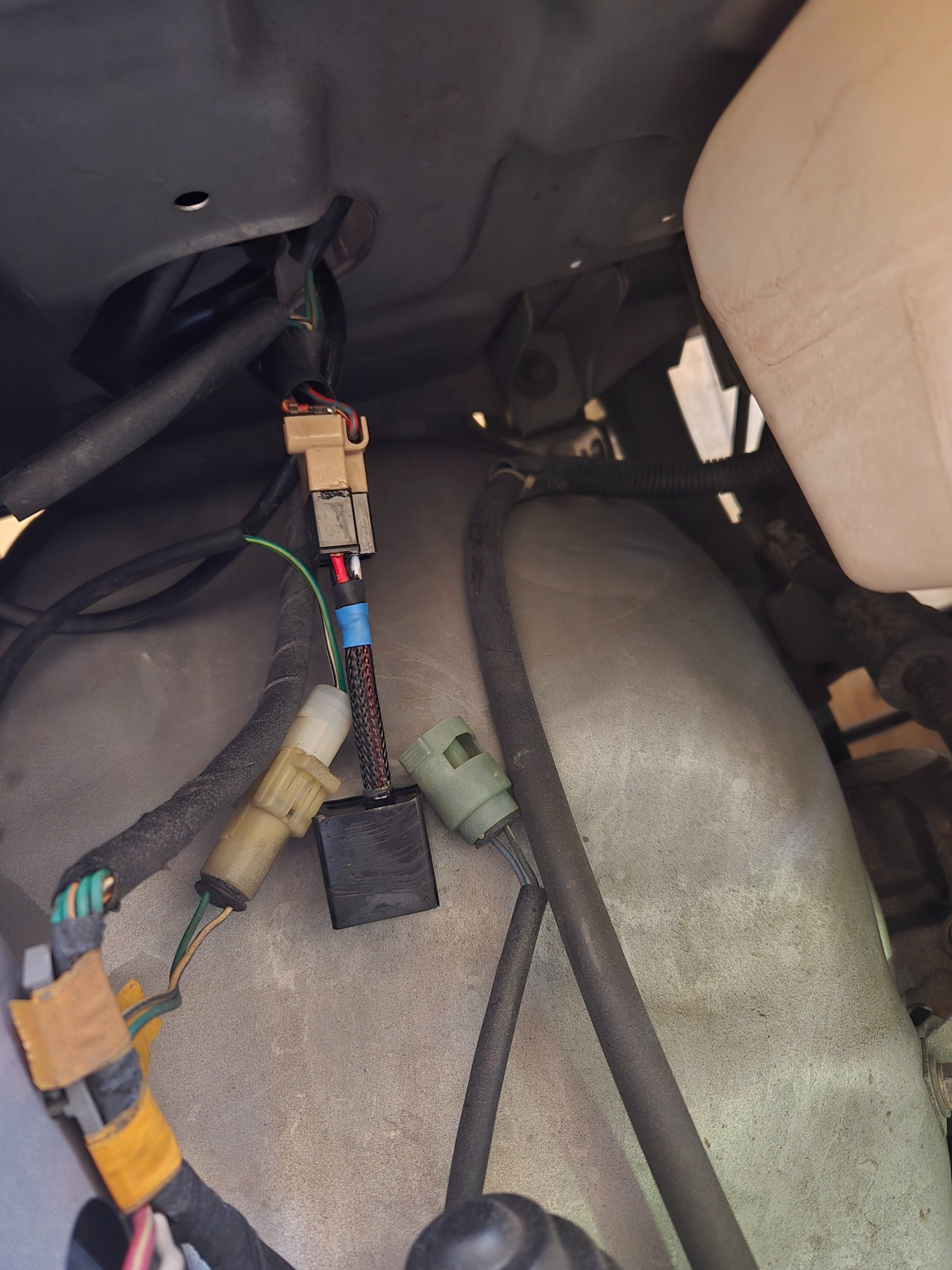

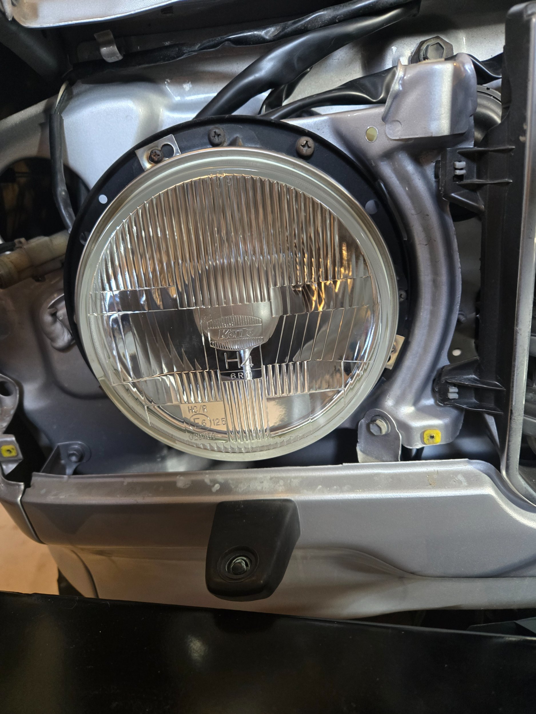

With the 80 being down the 60 is going to remain the daily for a while. One of the headlights went out a few weeks ago. Perfect time to upgrade to the Koito h4 kit. Thanks @Cruisertrash! Easy install with a cup of coffee and everything works perfect including the high beam indicator.
Ready to resume night driving.

Love the output without going to a crazy white color temp. Looks factory.

I feel the same way about the headlight color temperature. It looks right. All the LED kits are way too white and don’t suit these vehicles at all. I’ve spent two solid years looking for a high output LED headlight package - or even just bulbs - that are in the 3500-4000K color range and they just don’t exist. I wonder if it’s a technology limitation of the LEDs themselves.
Anyway, thanks for the order and I’m glad you got the blue light on the dash too!
