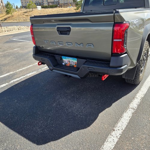

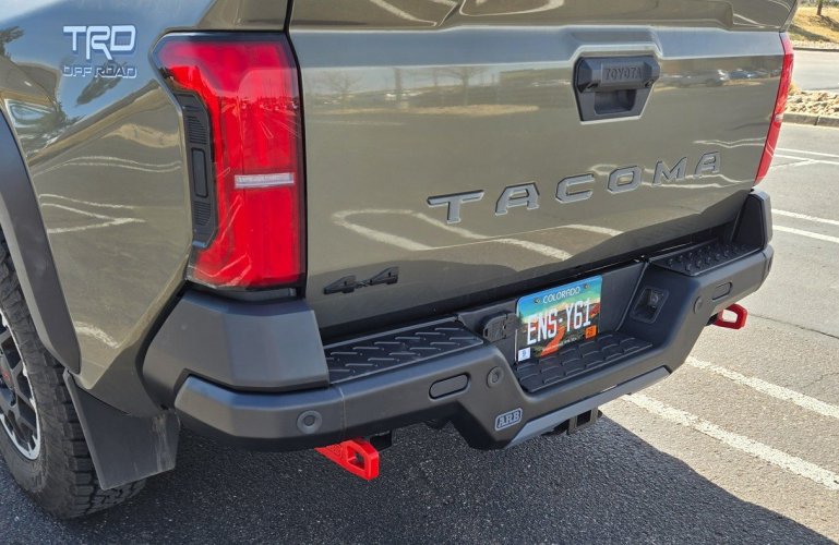

I ordered the rear ARB Bumper. You can only get it through Toyota. Interesting that Stevinson wasnt able to get it, but Groove looked it tp found 2 in the depot and said I will have it by the weekend. I will install it myself

That rear bumper looks really good!

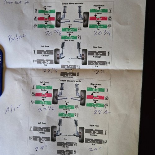

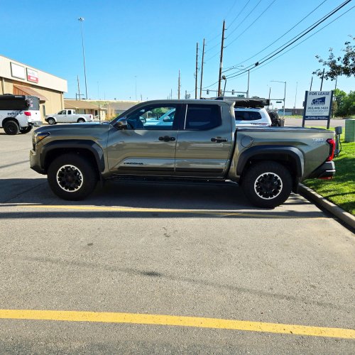

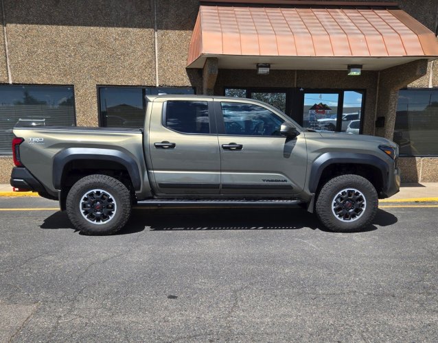

I just added the Alldogs springs
I did not want to spend thousands of dollars on a new lift. I liked these because they allowed me to lift my truck without changing control arms or shocks.
Before
After
Before and After alignment and lift deltas

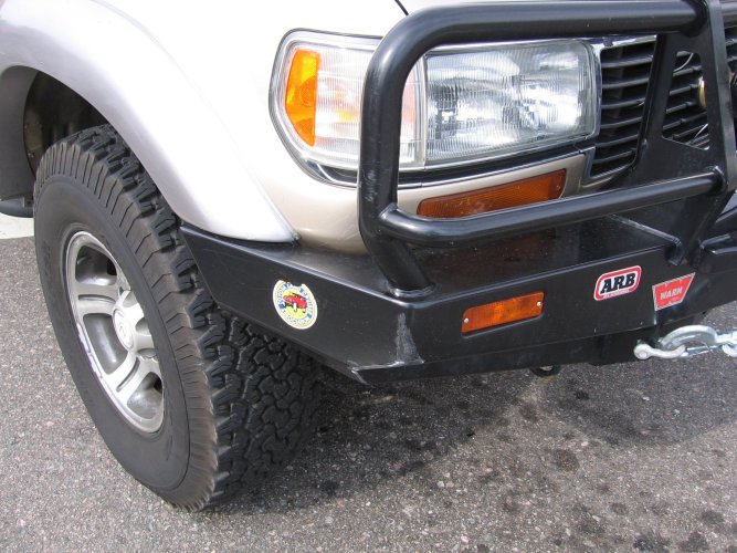

Let’s talk Front Bumpers
I noticed there are very few full width bumpers like a bull bar even without the bar for the Tacoma.
I had an ARB Front Bumper on pre-order, but may cancel.
There are lots of front bumpers that only replace the middle section.
I did not see a lot of value in these so I asked R4T what is the advantage of these. Primarily recovery points and housing a winch along with some front end protection

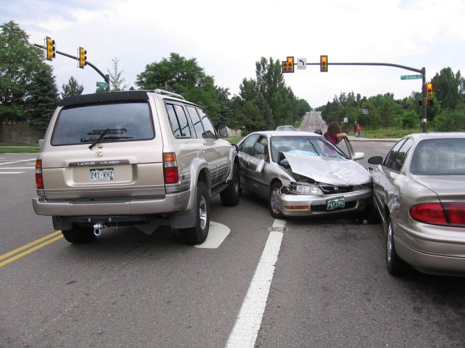

I am use to the full width bumpers that provide better clearance and protection. They have provided clearance to me on my Land Cruisers to come at an incline at an angle and walk one tire up and then the 2nd would catch.
They also have provided great front end protection. My daughter was at a red light in my 80 series and two cars hit each other in the intersection and smacked into my 80 on the corner. My 80 had no damage and only a paint scratch on the bumper. The cars has dents all the way down where they smacked against the bumper.
Also from wheeling, most of the dings have been in the corner. The skid plates provide protection for rocks hitting the underside.
I looked at the instructions to install the Tundra Zenith front bumper and they are very complicated. Lots of parts and pieces. It is likely a two day shop install which would be over $2K (my guess). One shop told me the first Tundra took them 4 days, but they expected follow on’s to be half of that
Sensors get moved and not sure if that requires recalibration. Moved sensors require harness extensions from the vender. Two dealers wanted $600 to recalibrate the rear parking sensors on my Rear ARB. I replaced them with the stock ones and everything works fine, but they are in similar spots. The front would move them farther out and there are more sensors so not as likely to work without recal, but maybe they will be just fine
This makes me think twice on getting a front full width bumper. I don’t plan on a winch right now, so I see no need to do the partial front. I just lifted my Tacoma and have 33” tires so maybe I should drive/wheel it and see how it goes. My 200 series Land Cruiser is still my primary wheeling vehicle so I would use that for the harder stuff. Still, I do like the on road protection of a full width bumper.
Throwing this out there for discussion. Maybe my thought process is flawed, maybe some front bumpers are much more simple than the ARB Zenith. Maybe there are benefits to the partial width/height front bumpers that seem prevalent ion the market

I’ve been asking questions on MUD regarding these AllDogs springs. The vendor has not had much to share. So thank you for the detailed ride height info above. Do they feel “firmer” on the road? Was here a noticeable increase in the spring diameter? What bothers me is that they are marketing these springs for LC/GX/Tacoma and assuming 4R without much info on ride height. The front ends of these trucks are probably very close in weight I have to believe the back halves vary to much for a one spring does all equally solution.
10,532
Centennial, Colorado
I haven't looked at the spring diameter. I did bring home the stock springs, not sure why :) Check out this video at 1:39 to see the stock Tacoma vs All Dog Springs next to each other for the front
View: https://www.youtube.com/watch?v=Pk7kMJjc6WU
Firmer feel, not sure how to answer that. It's a 25 mile highway drive from my house to R4T in north Denver. Rush hour stop and go on the way there, fairly wide open on way home. I think the stock springs almost felt like they were bottoming out on rough bumpy roads. I didn't drive the bumpy roads yet, but others have said that improved. I will need to drive it more to be able to answer your question. I thought it road better on the way home, but that could also be driving 65-70 vs 20 on the same road :)

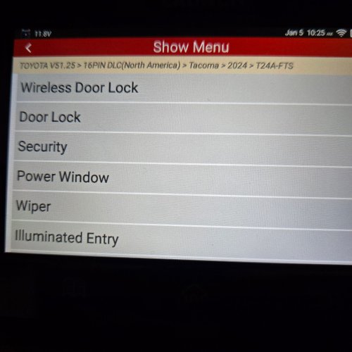

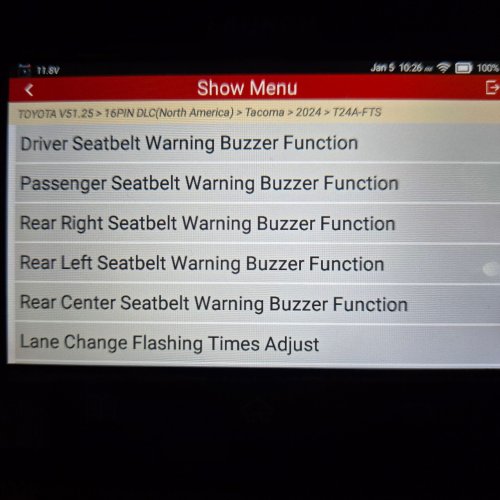

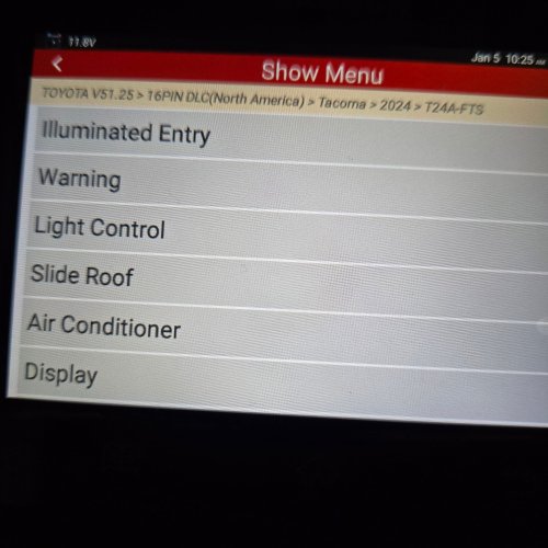

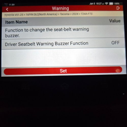

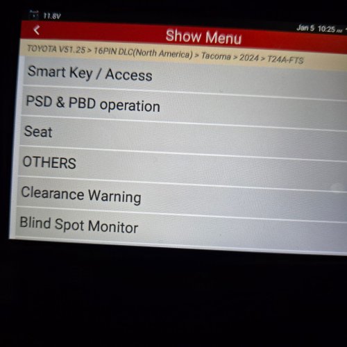

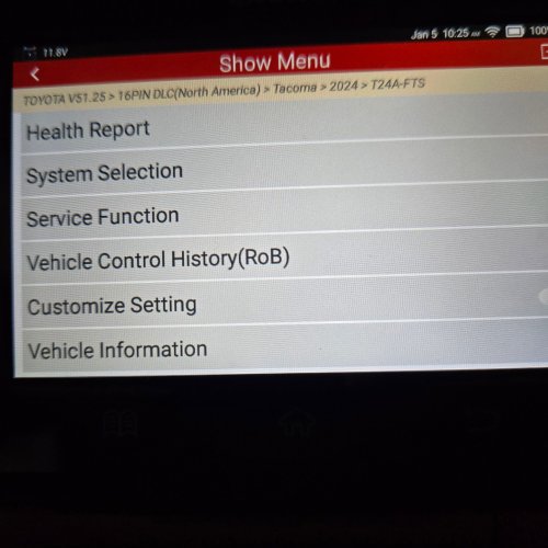

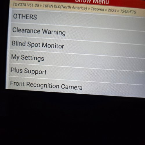

There are tools you can get to connect to the OBD port to modify a lot of settings. I used that to disable the seatbelt chime among other functions. I have one of those tools if you are ever in South Denver
Carista has a subscription, but you can cancel before 30 days are up at no cost. It was a nice tool but once everything is set, not really a reason to get it
I also have https://risingsun4x4club.org/xf/thr...portable-inexpensive-setup.37038/#post-449458 which does not require a susbscrition and works on all our Toyotas. I verified it has many of the same options to adjust. See pictures below
Not sure about 3rd brake light, never looked at that

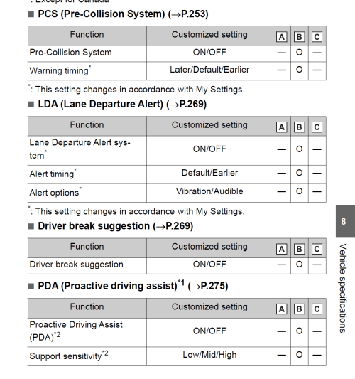

I believe there are ways to adjust the sensitivity of the Brake assist system. Mine isnt as sensitive as yours so I have not looked at it. This is in the owners manual. Have you tried adjusting the radar sensitivity button on the steering wheel for Cruise control?
Screens from tool I mentioned above
1747833539355.png20250105_102544.jpg20250105_102554.jpg20250105_102603.jpg20250105_102613.jpg20250105_102619.jpg20250105_102728.jpg20250105_102737.jpg

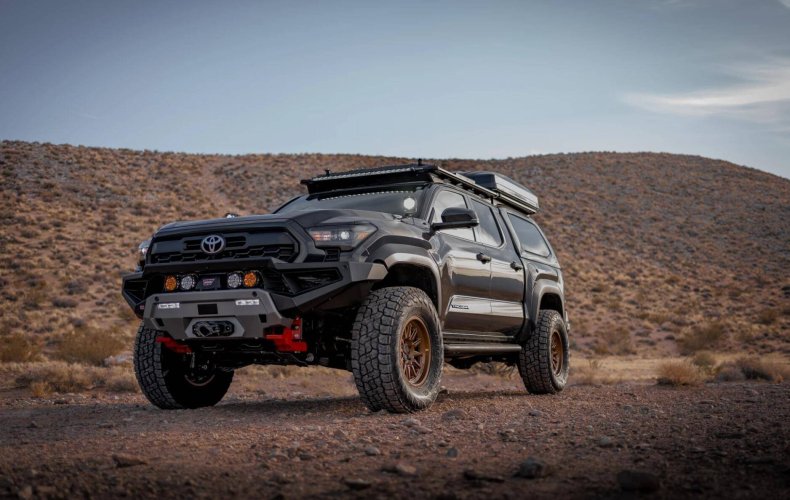

My preordered ARB Zenith made it to the states, but hasn't shipped. I got a set of the install instructions, its very complicated. Found out the bumper+ install+taxes would be over $5K. This included recalibration
I asked them to cancel the bumper since it hasnt shipped yet.
I don't plan on getting a winch and the 200 would wheel the hard trails. I like the bumper but don't LOVE the bumper. $5K would be OK if I thought that was the coolest thing. You know when you look back at your vehicle and go "that's cool" I know I wouldnt feel that way about that bumper. Kind of like I got the ARB Rear bumper for my 200 because it was the only thing available and swapped it for the Slee rear when it finally came out. The Slee bumper is cool and much better built
So taking a step back and flipping 180 degrees. Just considering.
No winch, no cutting getting some (not a lot) protection and better front recovery points there is this option. Doesnt touch the sensors and easy to install in a few hours. Not the full width protection I wanted, but with the work required for the sensors, this may be a good trade. Looks expensive, but it includes the front recovery hooks so just a little expensive :) The benefit is protection like an enhanced skid plate and much better recovery hooks for the front.
This makes it easy to add a different bumper later if I see one I love and I should be able to easily sell this one. I am just considering haven't decided on that. Just taking a step back and rethinking.
