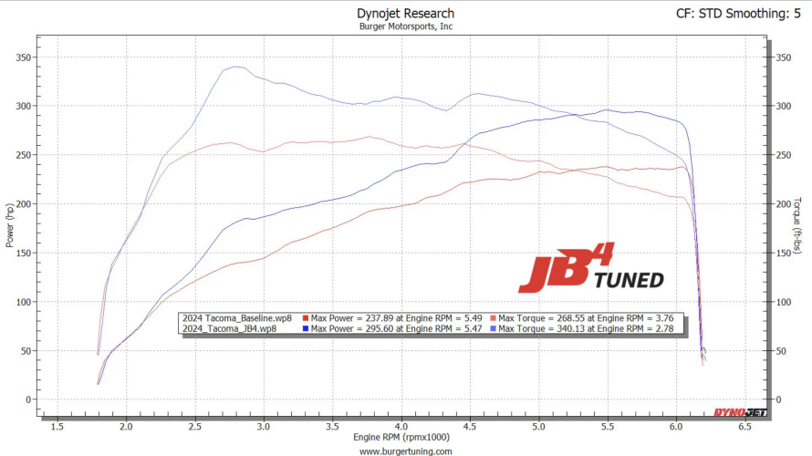

I was really impressed to see how much overhead there is with the new 2.4L in the Taco. Burger was able to get some serious gains out of their truck. About 25% more HP and 20% TQ. There were big gains across the range from about 2200 RPM to redline. This was on 93 octane, but there would probably be about another 10% HP and TQ if it was running E30.
Screenshot 2024-11-04 at 12-46-21 2024-2025-toyota-tacoma-dyno-horsepower-specs-towing-jb4-tun...png
View: https://www.youtube.com/watch?v=rSNv3203KSE&t=4s

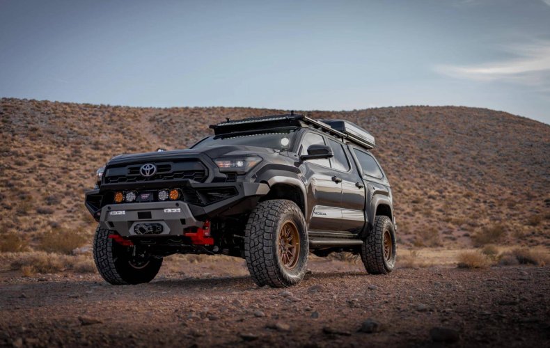

Pre-ordered one of these ARB Bumpers with Slee. The current crop of Taco bumpers only do the front middle section. I wanted something that provided protection to the corners for on and off road protection, but also increase clearance in the front corners
4,225
That’s snazzy looking.
I like it. Slee is making this bumper??
4,225
Oooh.
I completely read past ARB. 😂🤦‍♂️
gungriffin
Dec 4, 2017
1,138
That ARB bumper looks really good! It has been a while since I have seen something I like better than Dissent's standard design. Do all ARB bumpers pass the Australian crash testing?
