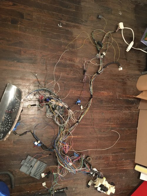

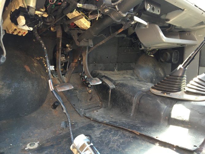

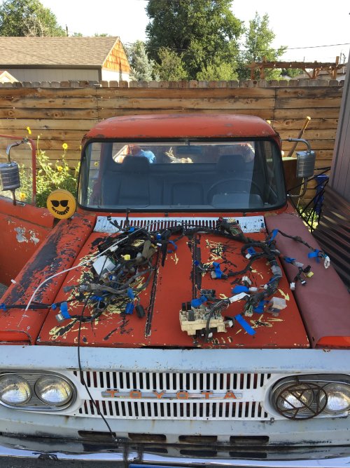

I am back and I have been working on the Stout when time allows. The wiring was the bulk of my winter project with several evenings spent cleaning the whole harness up and wiring in the Stout switches into the 4runner harness. It was quite the task but I find doing harness work meditative and the sense of accomplishment is worth the effort when everything works. Just a reminder of what the harness looked like straight out of the 4runner.

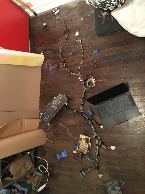

Here it is about halfway through. I left the wiring for the stock 4runner gauges so I could see the rpm and speed etc if I was interested. I also left the obd port wired so I could scan for codes if something came up. The stock Stout gauges are wired to give me fuel level, check engine light, and coolant temp directly from the 4runner harness. They seem to be fairly inline with what the 4runner cluster was reading so im going to go with it for now and monitor it when it actually gets driven.
And then right before i wrapped the harness.

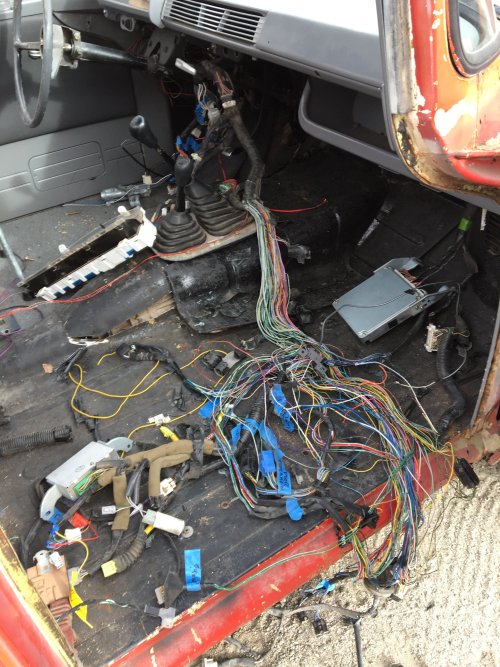

And here it is in the truck. The ecu fits snugly behind the cubby out of view and the cabin fuse box fits nicely under the dash to the left of driver. Everything is pretty well tucked away and accessible where needed. I still need to wire the harness to the stout ignition and starter switch but that's easy stuff.

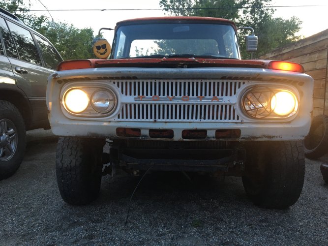

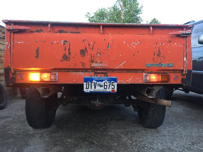

And the classic check if the lights work!

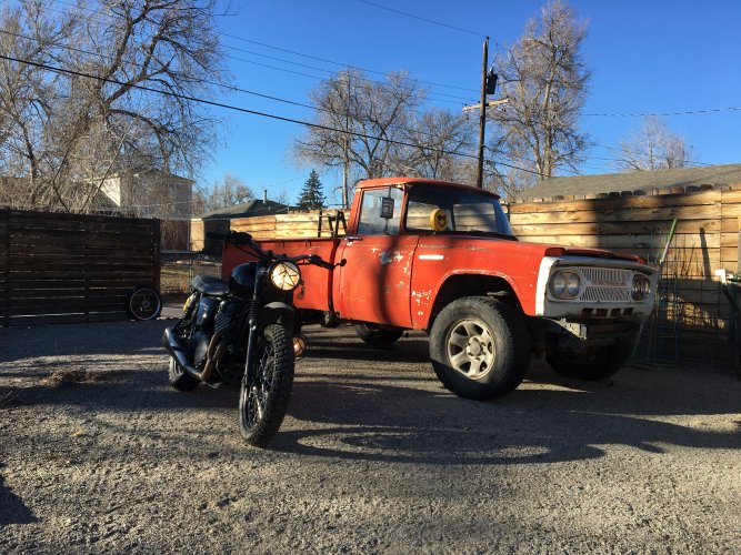

wait...a sweet ass truck AND a Ducati Scrambler?!?!?!?!? I think there are laws against having that much awesome in a back yard.
HDavis
Feb 13, 2019
1,478
The Scrambler is actually my wife's bike, mine is a very customized Triumph Bonneville...

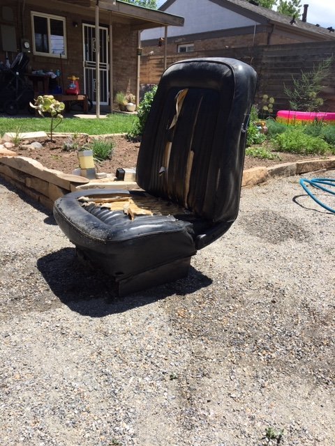

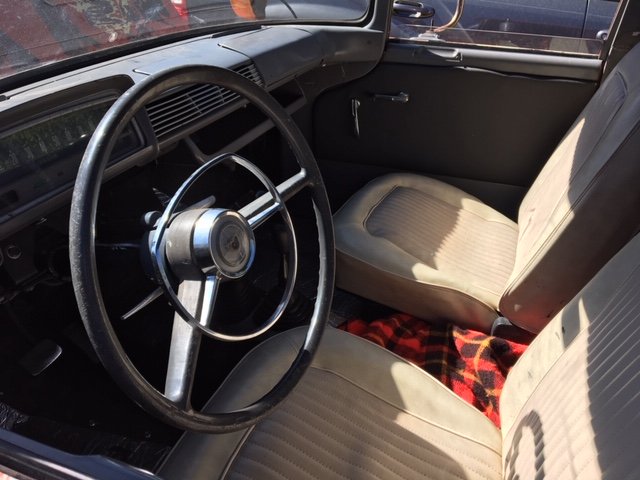

Ive been pretty busy lately working out all of the little things on the Stout and in an effort to get it done quicker i didn't take nearly as many process photos. I scored some mustang seats that were really bad for a great deal as well as some new upholstery and made my own custom brackets to go in the Stout. They look much more appropriate than the Honda Pilot rear seat i had in there before. The interior still has a few items left done like insulation/sound deadening, carpet, door panels, and visor but things are certainly moving right along.
